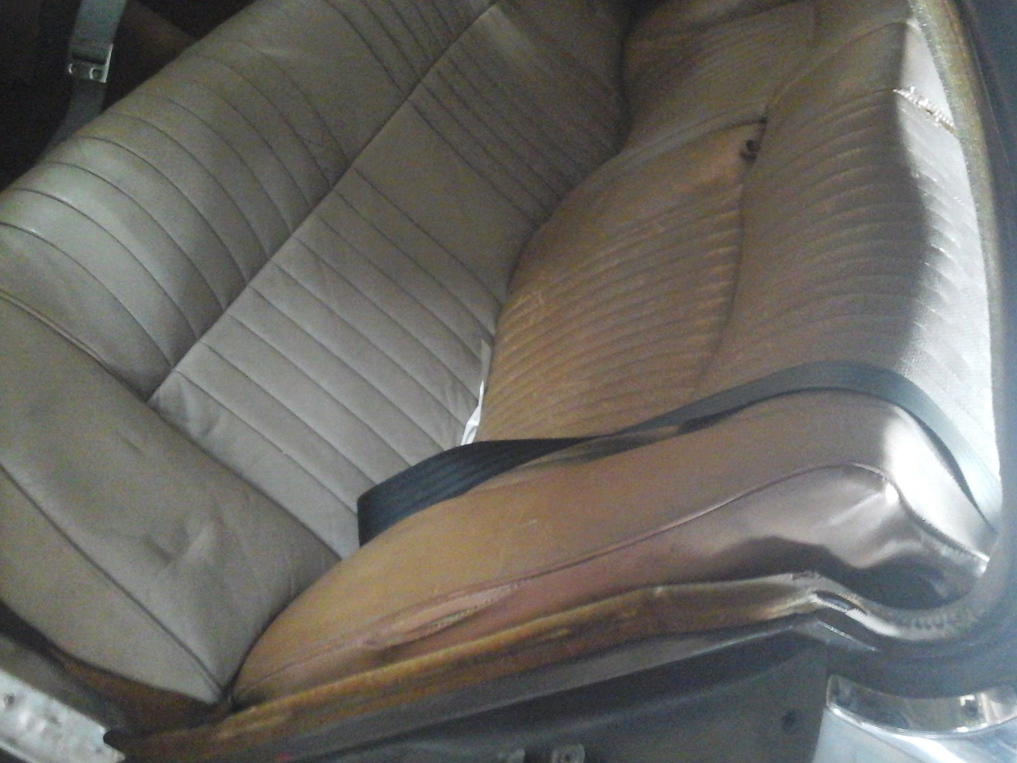

So, the seats in my XJ6 were terrible. I could feel the frame when sitting down. Finding a good replacement is very hard so what I did was fit the bottom part of the seats from a XJ40. They fit in the original frame and the rear seat aswell. 0 adjustments to the car you just lift the bottom part out and put the XJ40 one back.
(Note the color difference)

This sort of thing was quite common on Jaguars as they never had much money to spend on development, so if something from the old car was OK, it went on the new one, sometimes with cosmetic changes.

if the old seat was sagging it was probably the Rubber Diaphragm and/or the Foam Pads.
you can still get those parts from World Upholstery:
Seat Upholstery, Carpet Sets, Converitble Tops, Headliners, Door Panels and Rubber Seals for Jaguar XJ Series Sedans from World Upholstery & Trim
However, the XJ-40 seat is superior, I think it is longer and it has better thigh support than the original Series 1, 2, and 3 seats.

Great. I was worried I said something inappropriate for a second, haha. Hope it's useful to anyone. It's very useful to me. Today I went to the store, which is about a 10 mile drive and I must say the seats are superb, the rest of the seats could use some fixing up. I'll see if I can do anything about that.
