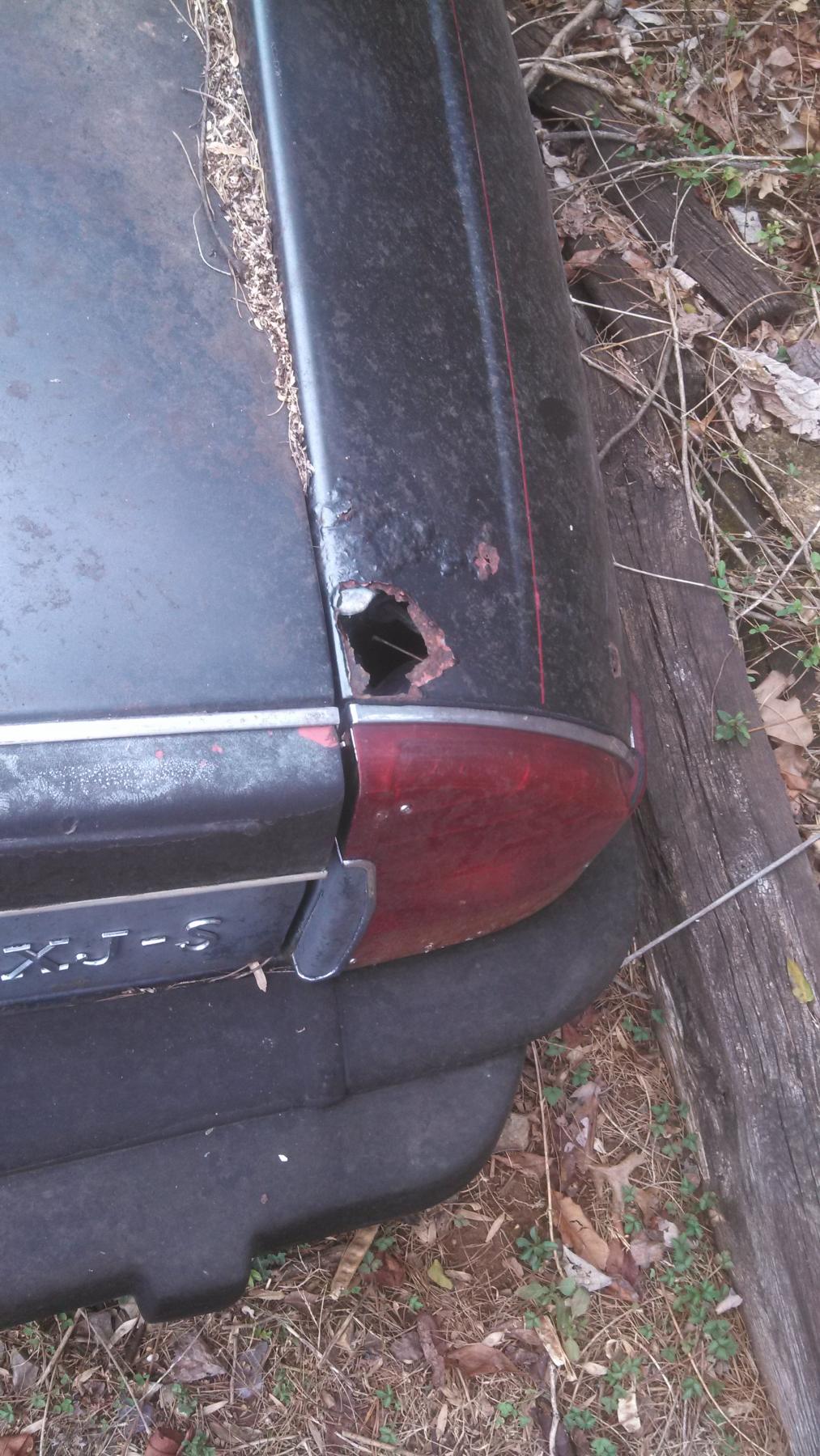

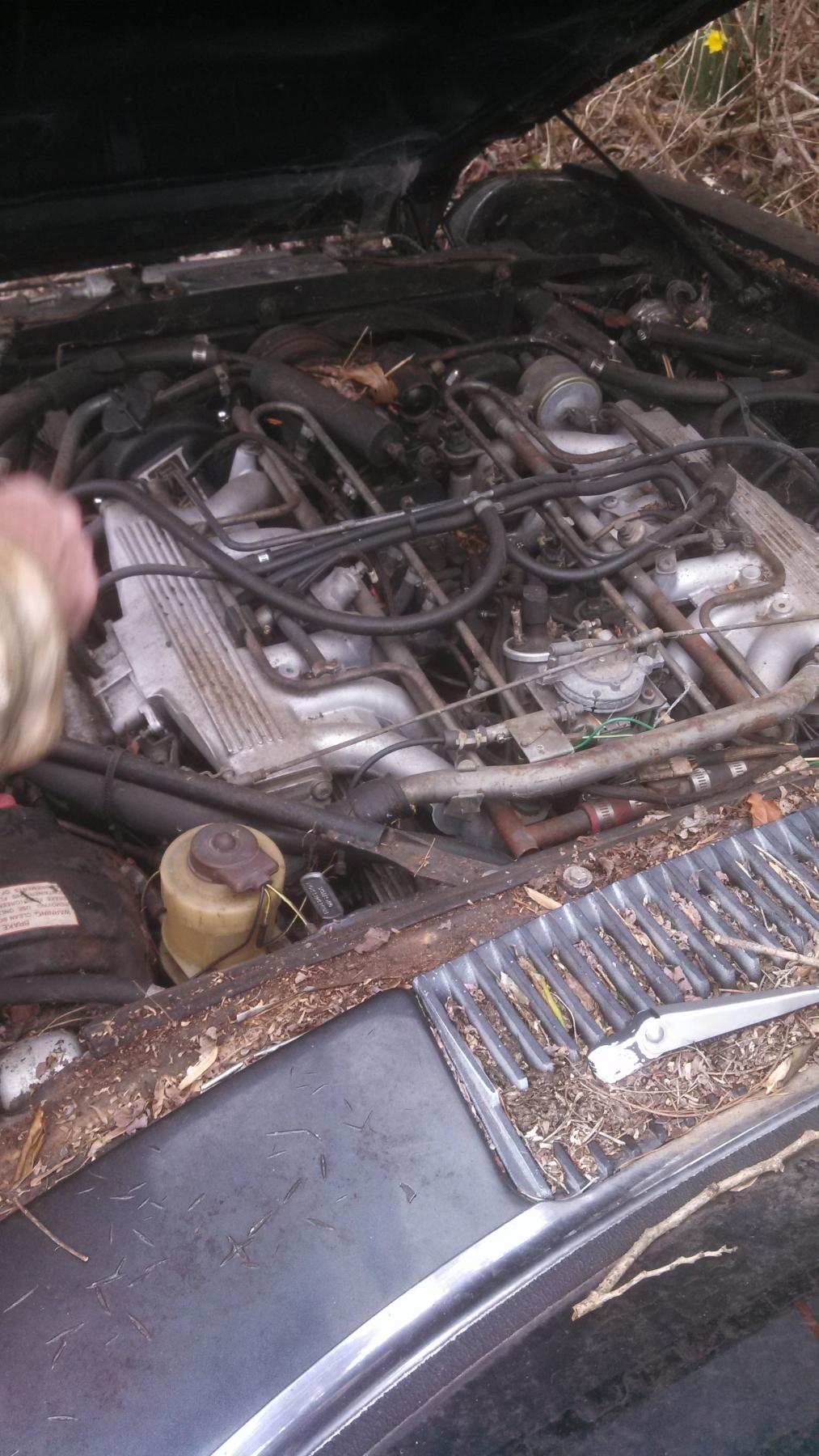

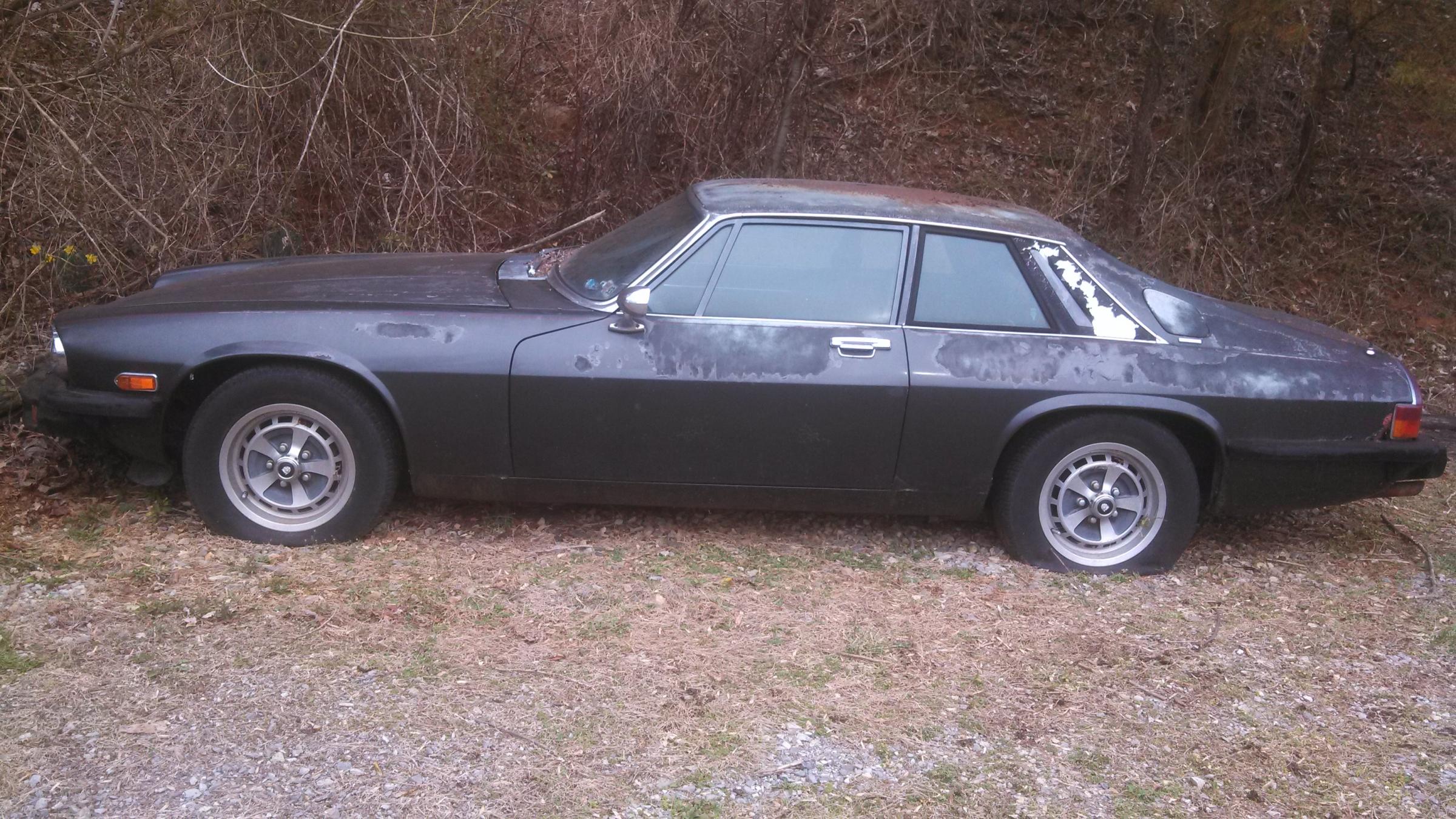

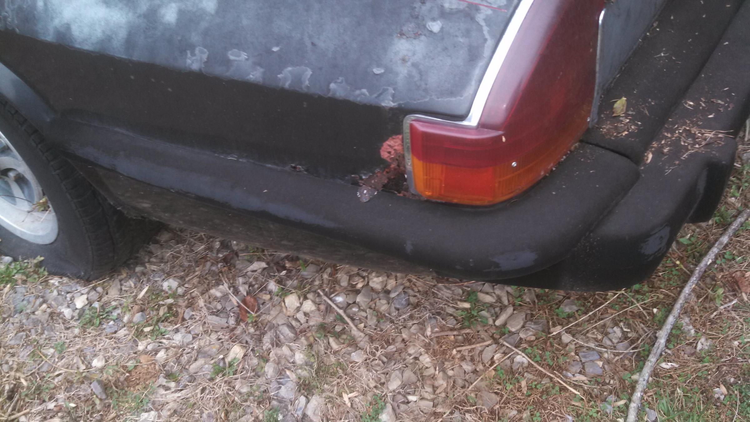

Hopefully this will upload the pictures
Attached Thumbnails 1976 XJS Project?-img_20140322_161353_698.jpg   1976 XJS Project?-img_20140322_161348_573.jpg   1976 XJS Project?-img_20140322_161117_907.jpg   1976 XJS Project?-img_20140322_161122_603.jpg   1976 XJS Project?-img_20140322_161113_832.jpg

It does appear to be as bad as you say it is. If she's giving it to you for free..literally free... then take it and part it out. Otherwise, run away and buy yourself the best running example you can.

Maybe I had remembered the details a little larger in my head, or maybe to you guys, it looks like I had described. The main worry I have is the structural integrity of the car. The engine I can deal with, along with the wires. I've got nothing but spare time, but I've also got very little money. I do appreciate the honest replies that I've already received and take it all into consideration. Just a little bit of information that may help on the mechanical side, I'm currently going to school to become an A&P mechanic (I fix airplanes), so I know a little about struggle, and quite a bit more.
Again, thanks for the input

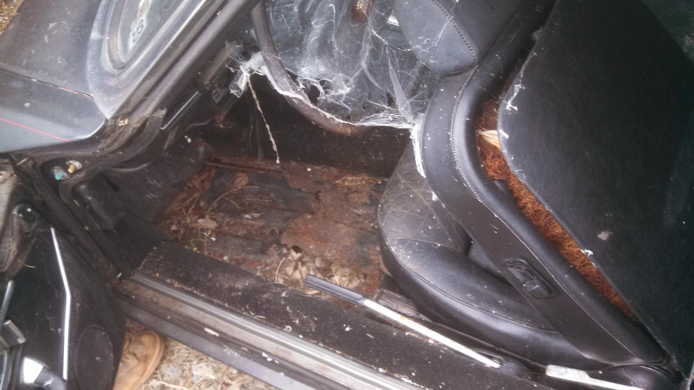

Last one for a while...but oh how the mighty have fallen
Attached Thumbnails 1976 XJS Project?-20140320_192228.jpg   1976 XJS Project?-20140320_192319.jpg

Well, if the car's free, you have lots of time, and you're (very) mechanically inclined, it can't hurt to start on the car. Get it up on a lift to see how bad it's rusted out. Common places to check specifically for the XJS
  • The joint between the rocker panel and the rear fender.
  • Lower (i.e. closing) edge of boot (trunk) lid on the inside.
  • Top dead center of rear wheel arches.
  • Around rear bumper side-arm mounts (and along the horizontal seam behind them; Check inside the boot).
  • The lower edge of the panel below the center section of the rear bumper.
  • Around tail-lights; just below them down the seam there and just ahead of them on the rear wing.
  • If your back window rubbers are softening check for accumulation of water in the deep wells on either side of the boot (trunk). Also look for water trickling down inside, down the back of the rear seat back and accumulating in the spongy sound-deadening underneath.
  • Around the radius arm mountings -- structural
  • On the front wing, just ahead of the front door hinge and just above the rocker panel.
  • The front end of the sills (or the front of the footwell), behind the front wheels.
  • Front footwells under the carpets (wet carpet rust).
You can see which of these are structural, and which aren't. Pay particular attention to the chassis rail/tunnel area. Also, the front lower outer seat belt anchorage is known to rust badly on the early cars, causing failure of the restraint system.
That's where I'd start. But from your pictures, my guess would be most of the items on the list are in bad shape.. so that could rule it out.

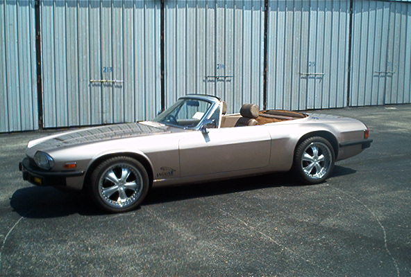

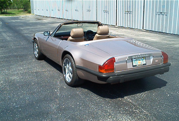

simple, mine was given to me,free of charge, $30,000. later its is a nice car.
Attached Thumbnails 1976 XJS Project?-jag-rodstr-016.jpg   1976 XJS Project?-jag-rodstr-002.jpg
