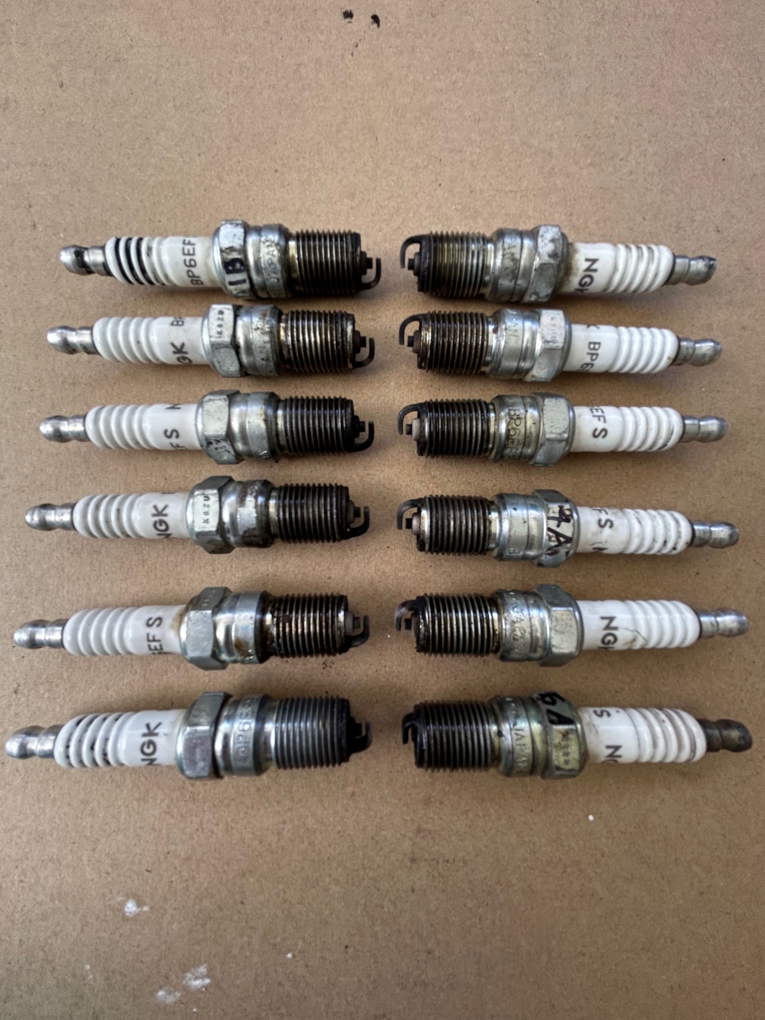

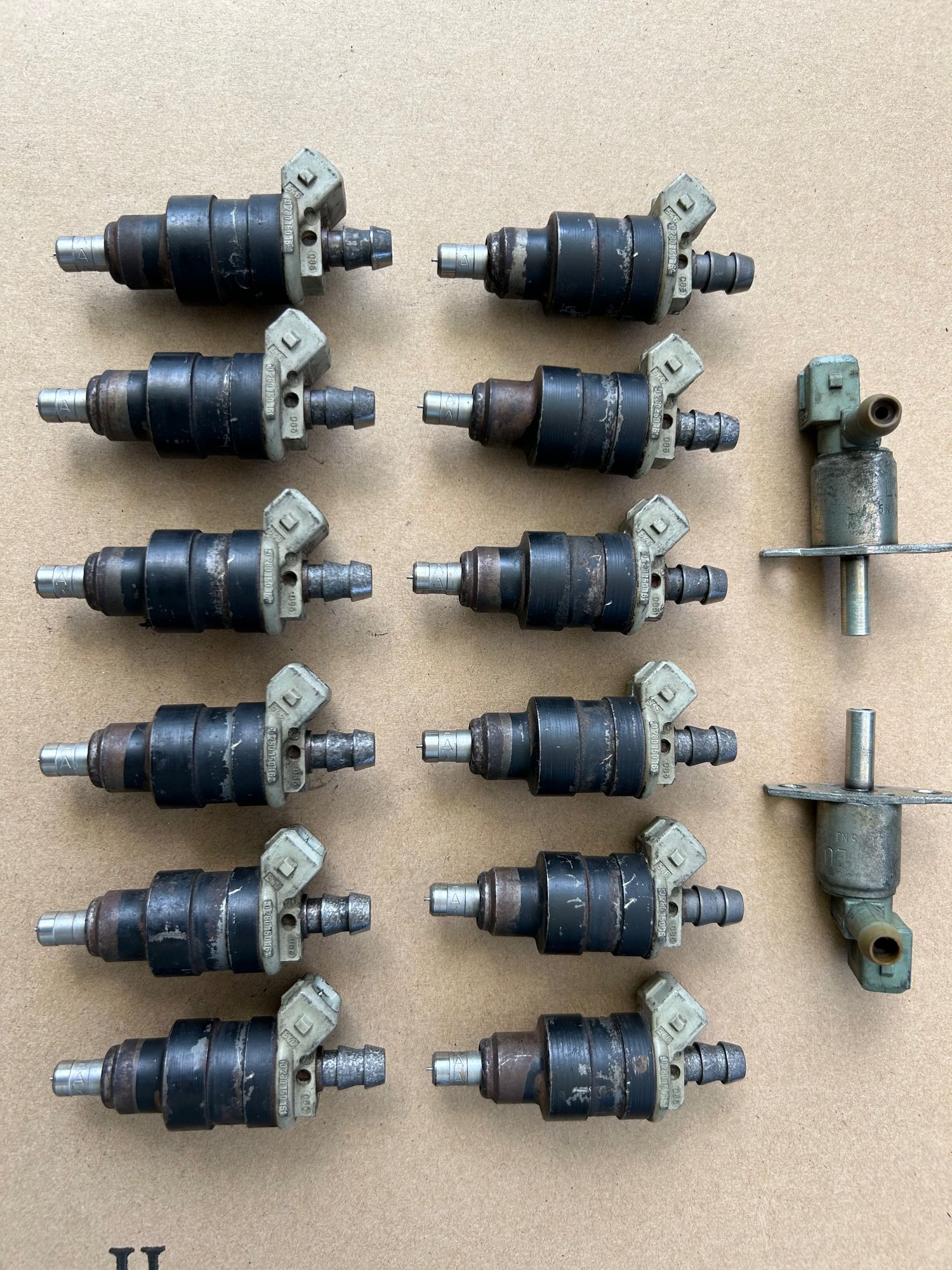

Pics of the plugs that I pulled out and the injectors as they now look (pre cleaning). Interested in people's opinions, please...
12x BP6EFS spark plugs (5,00km from new)
12x fuel injectors & 2x cold start injectors

Plugs look consistent with a rarely used V12, kind of normal these days.
BUT
That plug in the snap, 2nd from the bottom, RH side, looks like a crack in the porcelain, or its my one eye doing what it does best??
Injectors, no comment, we talked about this the other night, and I will leave it at that.

Get the injectors cleaned say I; what is the point of doing all that refurb work and not being certain the bit that actually squirts in the fuel is working properly?
If you search for home injector cleaning or similar on here, Orangeblossom's posts, you will see how to make your own cleaning and test rig.
The bottom two plugs look far too rich-burning. But as Grant says; if you do not properly thrash a V12 to the red line every time it is warmed up it will not work as it should.

Grant, Greg, Doug (Brain Trust - I like that),
In the pictures of Adam's injectors you can see the pins extended.
I am going thru the same refurbishment on my car. On my injectors when they came out of the car the injector pins were extended as well. At some point they retracted back flush with the metal pintel (the water wasn't cold). I tried using a 9V battery on the EFI leads to see if that would make them extend again. It did not, however I could hear a distinct 'click click' when I touched the wire to the EFI.
Do those pins have to be extended? If so any suggestions on what to try next?

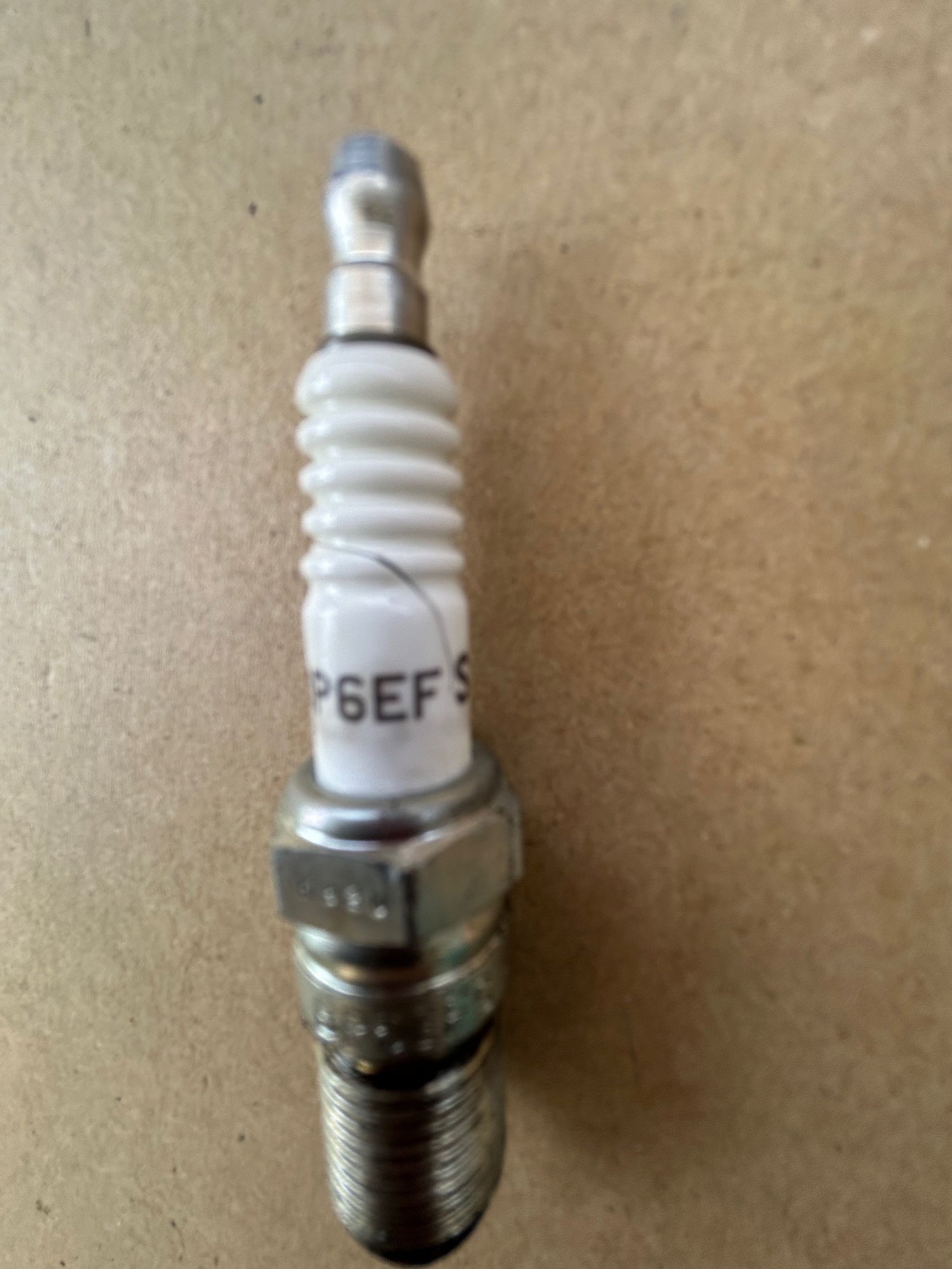

Hey Grant, I can't fault your eyes mate. I didn't even notice the cracked porcelain on Plug 5A (and I've held them all multiple times). Attached a pic of it after checking it closer this morning. Perhaps it already had a hairline and that's why I was down one cylinder on A bank? Perhaps I cracked it more getting it out? Going to take a punt and get the fuel rail back together (with new filters, pintle caps, rubbers, etc) and back on the car as is. I'm not sending the injectors for cleaning as it is a $400+ job and I could use that on other parts. If the worst happens, and I still have a miss after new plugs, HT leads, disti cap, rotor and parts replacement for the injectors (where I think a couple of the pintle caps were cracked as well) then I will chock it up to "learning" and fork out the cash for the injectors to be cleaned.

Beer O'Clock Adam.
Most likely cracked going IN, and usually from lack of Anti Seize on the threads, and just that extra oomph some people simply MUST DO.

So, @Grant Francis spotted the cracked spark plug before I did, just from a pic I posted.
Grant, thanks very much mate!
