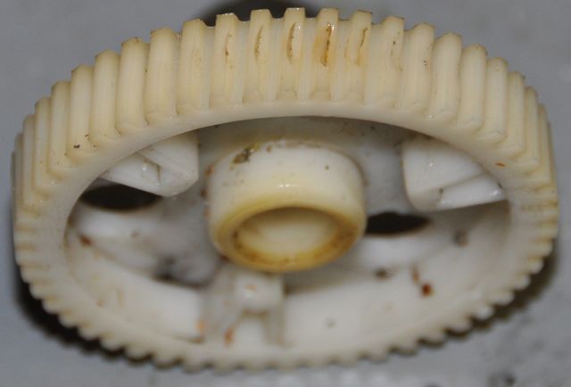

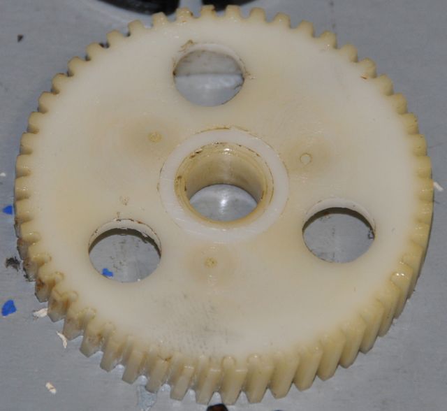

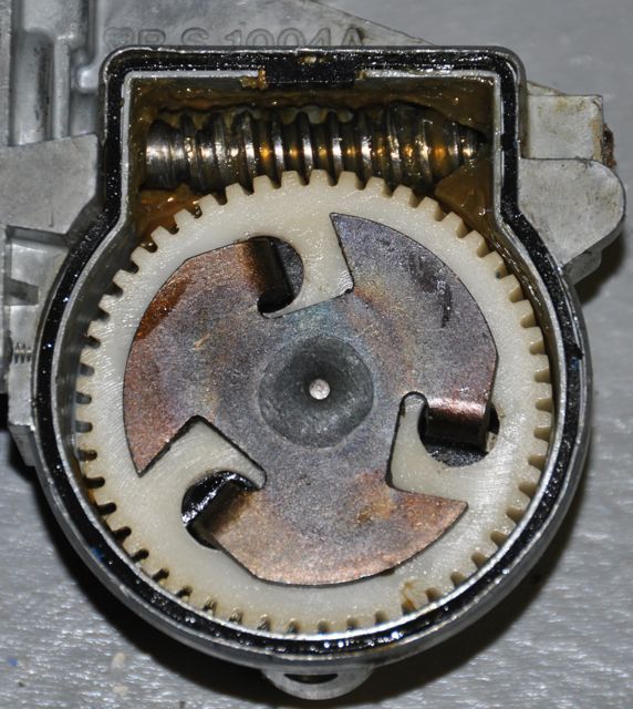

I just reinstalled the motor with the flipped gear & it works great. The description my Mish was good. I also had to plane off a raised area on one side. Pretty self-explanatory. I attached some photos for reference.
You can see the damaged area in the gear.
Thanks again!

This is exactly what I did, but forgot to take pics. One more thing, remove spacers on one side of the gear and put on another, this way you will move driving shaft all the way onto the fresh teeth of your large gear.
Glad I could help...
