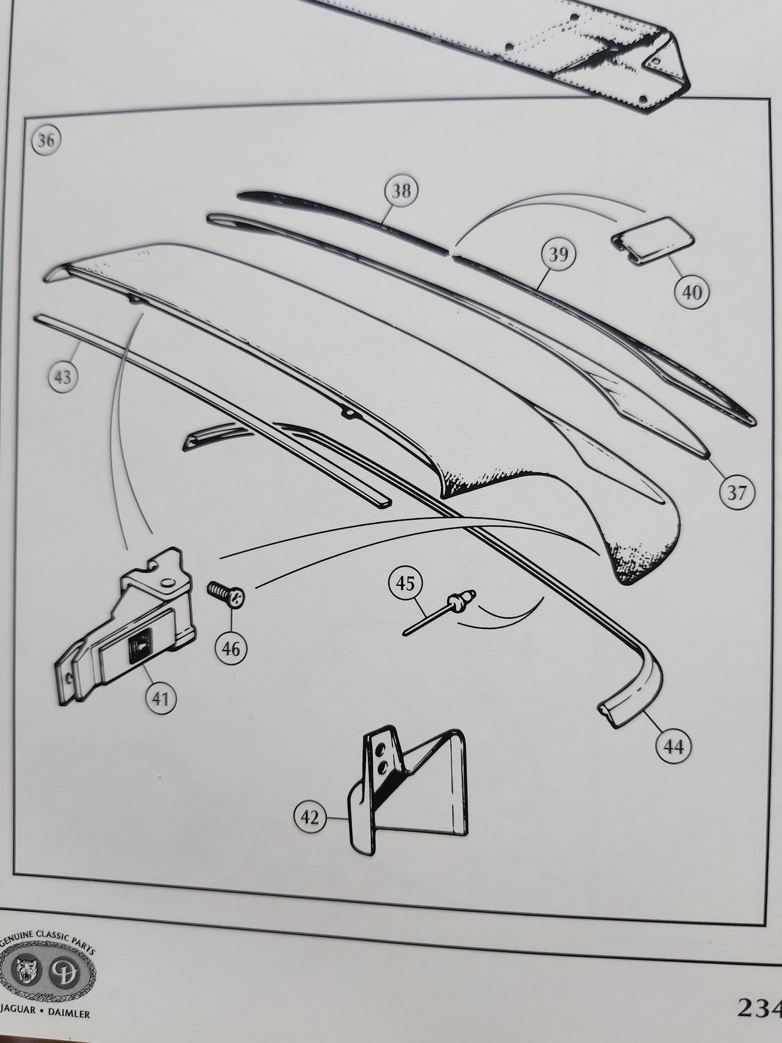

Hi Chris, apologies for picking up an old thread, but I recently purchased a XJSC and managed get hold of a hard top. Can I ask if there is a separate metal strip that replaces the row of star bolts on the rear of the boot section that the hard roof secures too or is it just the two side fixings that secure the whole roof?

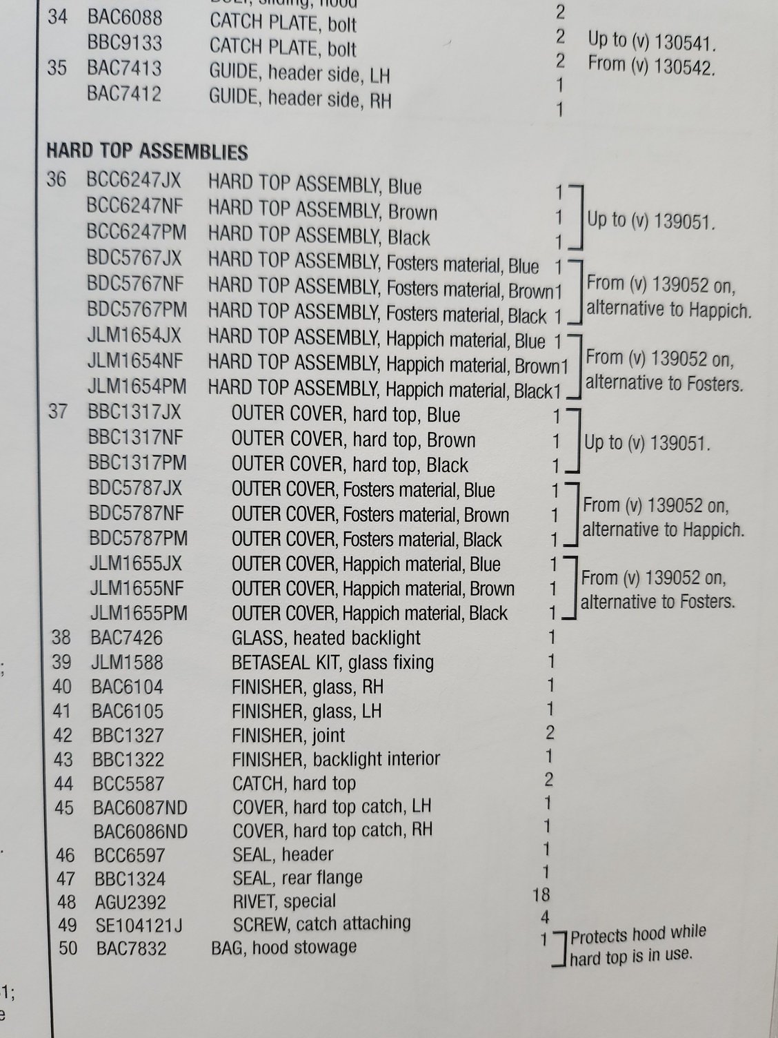

Thanks Chris. I was asking become the "Genuine Parts Catalogue" shows a "catch" strip (item no. 44) which I have found no mention of anywhere on forums.

There's an error in that parts catalogue between the numbers on the diagram and the numbers listed for the part numbers.
"44" on the diagram is actually "47" in the list of parts - the flange seal BCC1324
and "41" on the diagram is actually "44" in the parts list - the hardtop catch BCC5587
See the Jaguar Parts website here - always a good place to start:
https://parts.jaguarlandroverclassic.../brand/jaguar/
Paul
