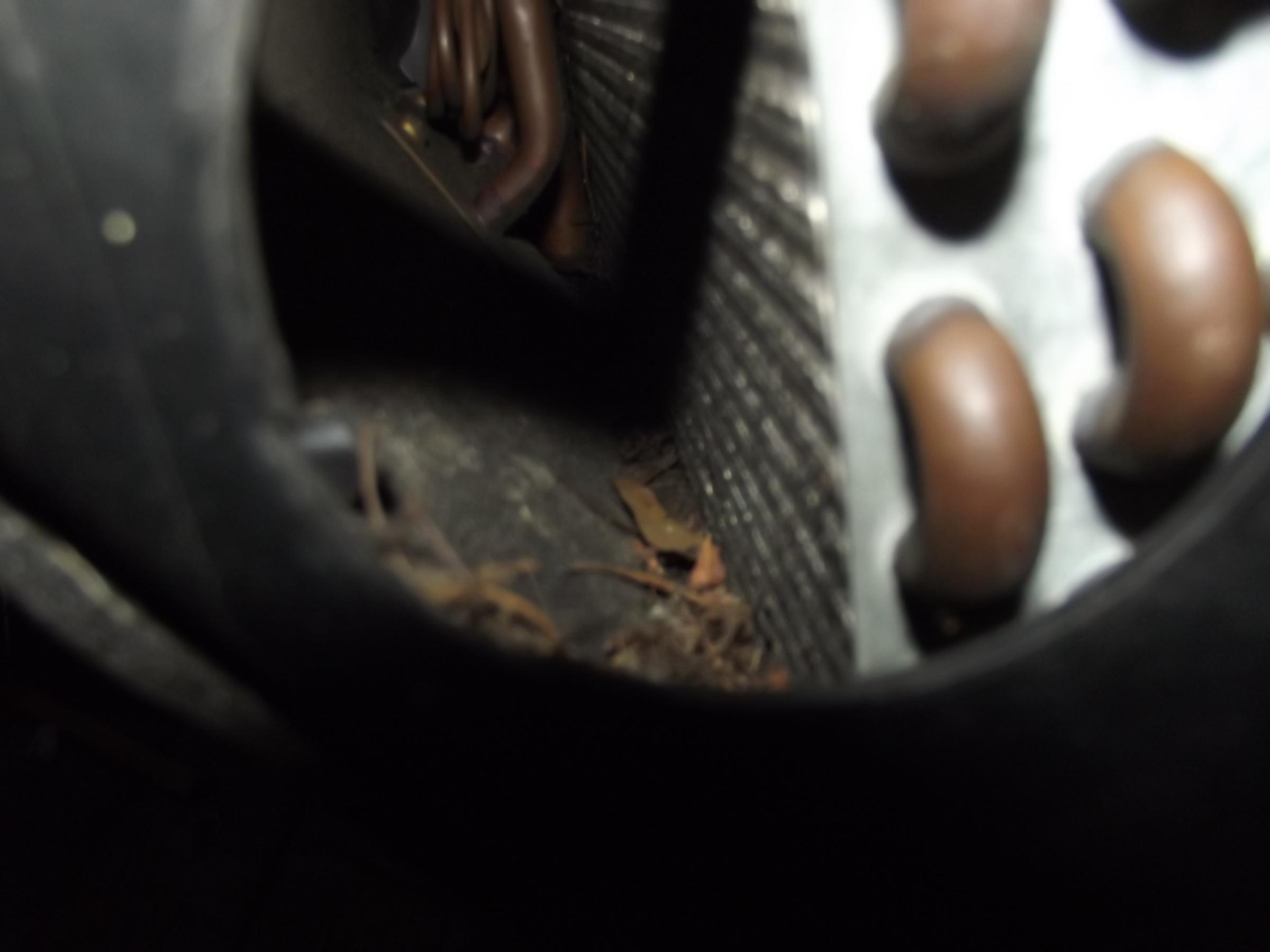

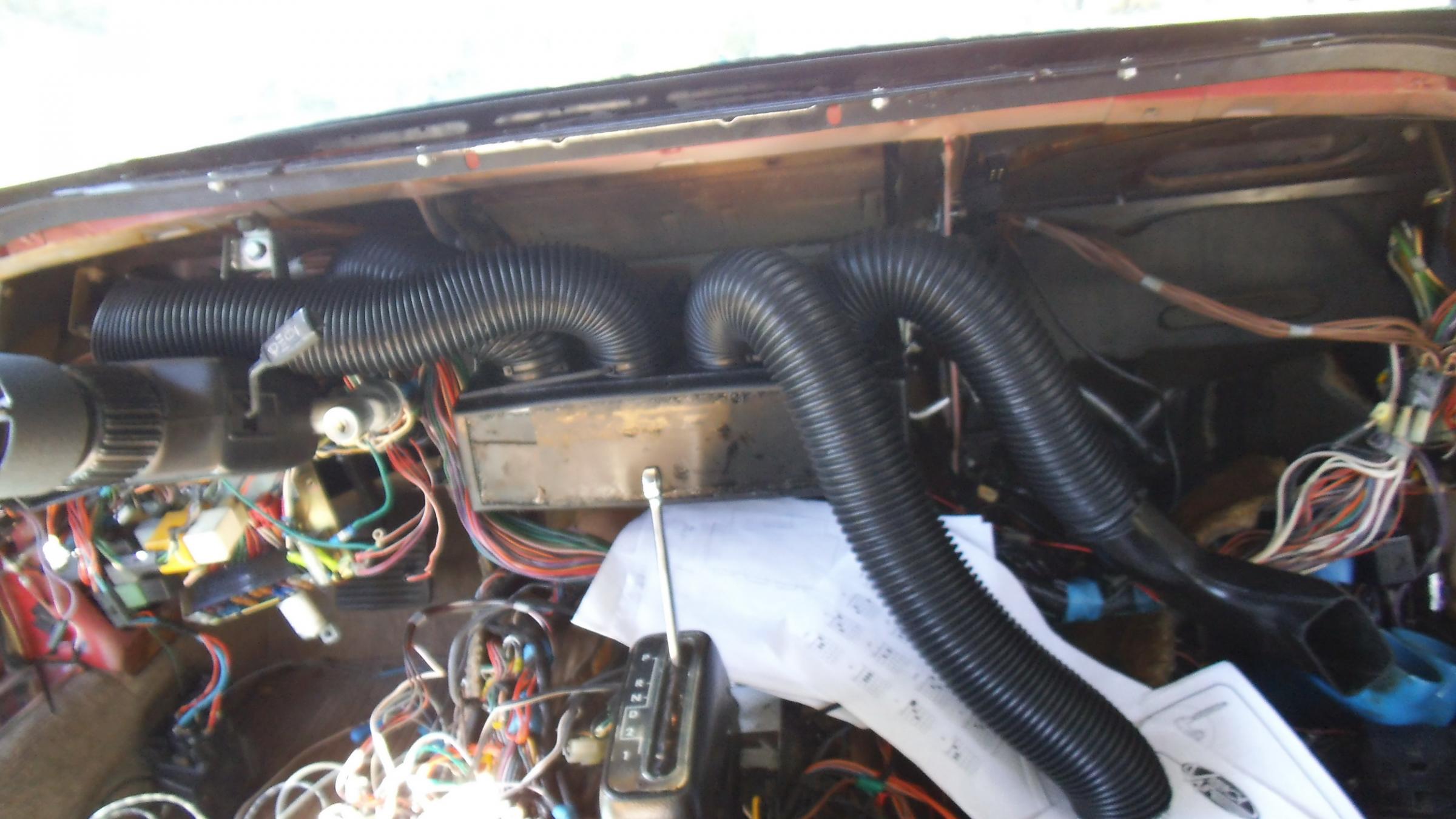

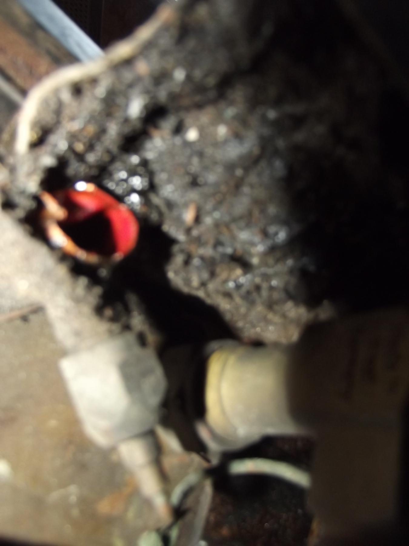

I am embarking on a project that I am seriously not looking forward to. My HVAC unit is trashed. One of the previous owners cut wires and connectors, removed some of the vacuum controls and control box. I didn't realize any of this until cold weather set in. Great timing. Found a complete unit on evilbay for $350 from a May 1987 XJS that of course arrived damaged this afternoon. Now i have to take two and make one.

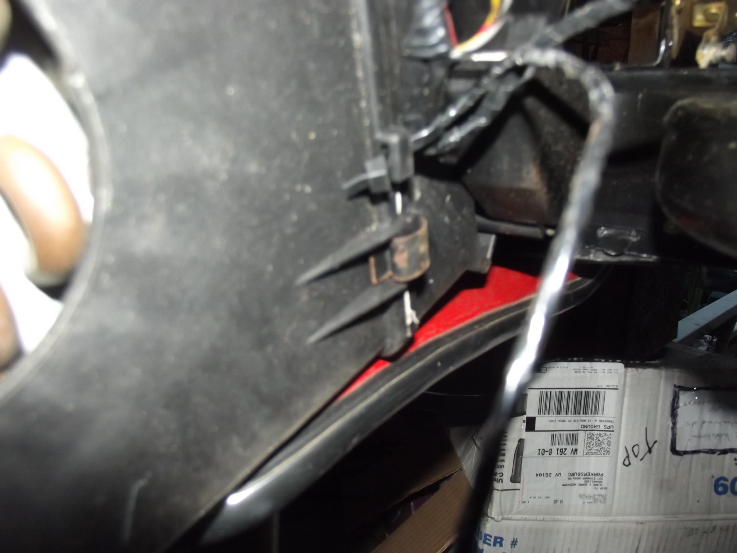

First of all I have to ask before i get started this weekend. There are clips that hold the box halves together. I need to separate this if at all possible to clean out the debris and repair a coolant line as I hope you'll see in the pics. I don't know if the halves are glued together and then clips added like some old Ford's I've worked on.
The next problem is the lower controls section. During shipping ( I assume ) the complete thing was shattered. I see it is held in with push-pins. I don't think the person who removed this unit knew that. I wonder of i can use the lower plastic from my old unit and just swap out the knobs and slider controls.

As long as the two units are BOTH Delanaire mark III, or both Delanaire mark II, everything is interchangeable.
Greg
