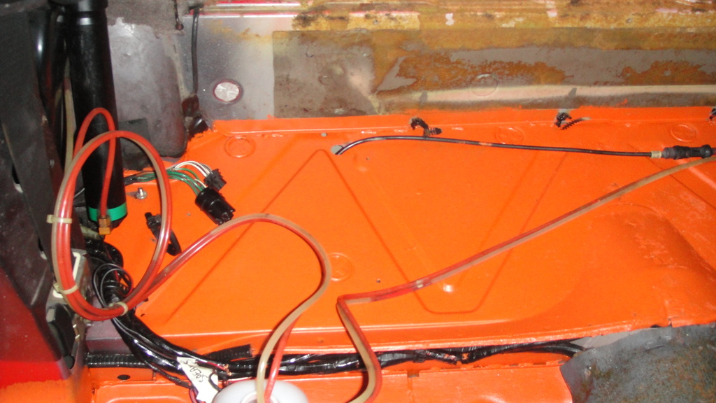

Default 1989 XJ-S, a renovation project, little mission accomplished ...
So all internal steel work is cleaned, rust treated, and in the primer.
Most aftermarket crap is gone, and I can reach electrics where and when needed.
The dash will only go out after I have finished the engine work, hopefully in ~1/2 year or so.
I found out that any of the fancy treatment systems you guys are using are simply not available here, so I opted for the stuff which most fishing boats use on board with salt water all around.
Perhaps not as fancy as PUR-15 and the likes, but I guess it will outdo my own expire date, and it will be under the carpets anyway .
Threads like the ones from Orangeblossom and Daim are a great inspiration, and I should say I am motivated to move a compartment.
Tomorrow I will carefully re-fill the tank, and if everything stays tight, it is engine time!

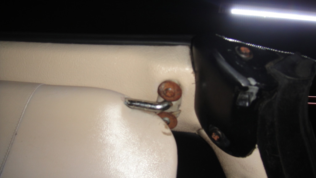

Default 1989 XJ-S, a renovation project, Taiwanese workmanship ...
Well, this says it all about the level of workmanship on this car in the past ... and this is only one of the many many many issues I stumbled upon so far .
I had the same clip broken into pieces on my Vanden Plas, took me 3 hours of careful remoulding, reinforcing and repainting, but it came out great and is impossible to spot.
An other 6 hours on the XJ-S it will be ...

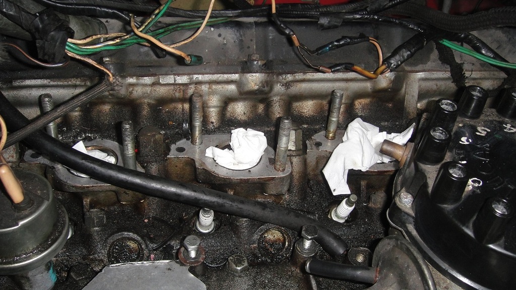

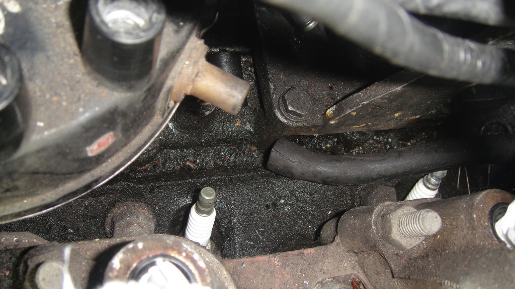

So after running the engine on some fresh fuel, and looking for leaks, I checked all injectors by just listening to each of them, disregarding the funny looks of others while you are having a screwdriver in your ear .
Pretty sure I hear 11 of them healthy ticking, not sure on just one of them.
Anyway, after that, took the dive and started disassembling.
It again amazes me how this car is butchered, I mentioned it before, but it is astonishing …
At least 50% of the electric wires in the engine compartment have been cut, and have been reconnected with some tape around them. For most, I have no idea why one should ever do that.
Then at least ½ of the vacuum hoses is gone, either decently plugged, just cut and open, or just not there, including the one to the dizzy.
That will need some more study later, as I am getting to understand what Jaguar did with it, but not sure on each and every correct position.
Finally, the valley was a whole warehouse of clips, seals, nuts and washers, and shiny paper from sweets … all drenched in a thick layer of fuel, oil and dust.
Well, I guess I was looking for a project, and I surely have one …but I really wonder how I ever made it home after buying the car.
For now, the valley is partly empty, and I am contemplating to remove the airco system for now (at least partially). It was not working, and I presume it is empty (is it?).
After that, will first spend 2 days carefully cleaning the engine and bay before removing the remaining stuff. Right now, I don't dare to remove the spark plugs with all the debris around.

Good to see you are still at it. I don't know why uninformed people will just yank lines and cut wires. There are proper ways to troubleshoot electrics! When I bought my old Mustang some previous owner had totally messed up the wiring harness. I had to pull the entire harness out twice, to trouble shoot and repair. Luckily an old Mustang doesn't have a whole lot of electrical equipment, especially compared to an XJS! My XJS is waiting for me to swap the transmission, but my other cars' needs have pushed it back on the list. Keep at it. Happy New Year!
This is what it working on the harness feels like!

Looking in the V area Eric, I think you really ought to sometime take the V apart and clean it up. Mine wasn't even that bad and I still cleaned it all
I'm still not satisfied with my V area... Needs "more clean" To say it kind of like Clarkson (more powaaaa)

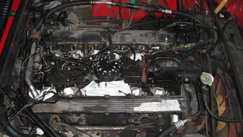

Default 1989 XJ-S, a renovation project, crazy ...
Well, before others in this building will do so, I am officially declaring myself crazy.
Started to clean the engine, and even the wife, used to some of my crazy behavior, could not believe I am doing it with a small scraper, a toothbrush, de-greaser, lots of paper towels, and the usual rags.
It is a hell of a job, just by preventing anything dropping in, and by preventing leaning an anything that will break.
Anyway, I guess an other 2 weeks to go, but I can see some results ....

Great job Eric. I did mine just like you are, toothbrush, solvent, rags, and did not make such a superb job of it as you are! Just a question now that you have everything off, of whether to regasket the cam covers...
Greg

Eric, that is looking a LOT better! You can see the engine is made of aluminium agaiin
Now clean those cam covers, replace the seals and fit some new Jaguar badges...

Great job Eric. I did mine just like you are, toothbrush, solvent, rags, and did not make such a superb job of it as you are! Just a question now that you have everything off, of whether to regasket the cam covers... Greg
Greg, got a long list of parts to buy, partly as advised by you, and the cam cover gaskets are on it.
I thought the right bank was leaking, but the injector had no gasket (found that one in the V just now).
Anyway, I will need to check valve clearances, and hope that is as deep as I will need to go.

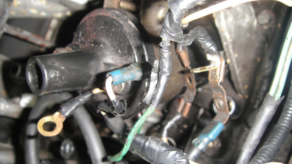

Default 1989 XJ-S, a renovation project, 'nice' work ...
Here 3 more examples of the 'high' quality work done previously.
See the re-invented full throttle switch?
The clearances will be fine, basically they cannot change sort of a valve stem failure.
While you have the inlets off though, I do hope you will change the injector rubber hoses and seals, sounds like they will need it. Also look long and hard at the injector loom for deterioration, and I would change the oil pressure sender and the oil light sender while it is easy. Is the vac capsule holding vac when you suck it? if not a good time to change that too. FYI, new throttle rods are still available from JCP and are dirt cheap, amazingly. For reliability, renewing the B bank fuel pressure regulator also a sensible thing to do.
Greg
