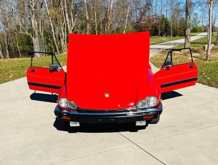

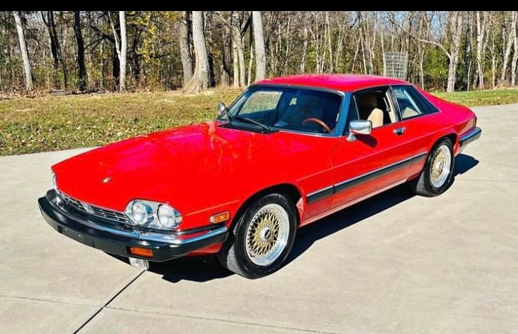

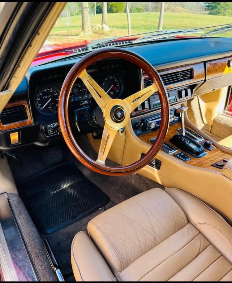

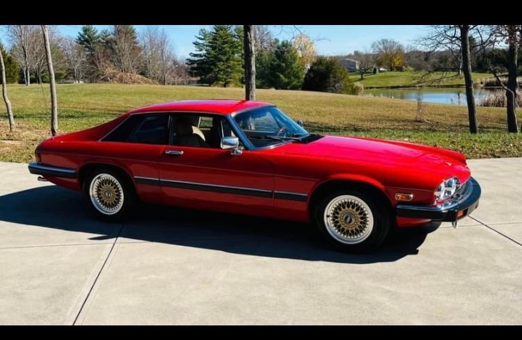

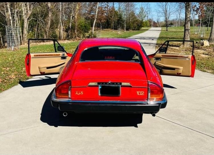

Hey there all,
it’s been a while since I posted as I sold my xj8VP about 2 years ago. I’ve always had my eye out for a hard top XJS and one has become availability somewhat close to me. I’d love any input on this vehicle. It belonged to the seller’s father who passed away. It has been garaged and it shows. 89k miles with an asking price of $9k.
Let me know what to look for upon test driving as well as thoughts about the asking price.
thanks!
