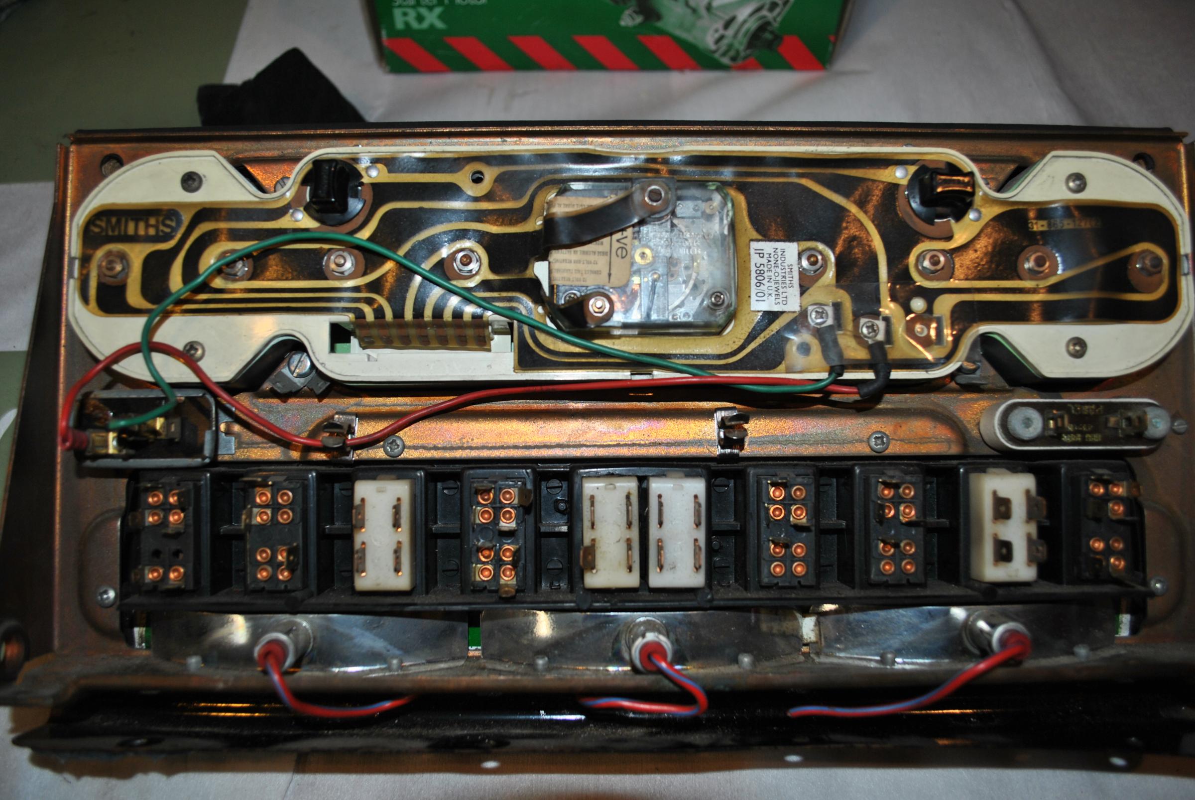

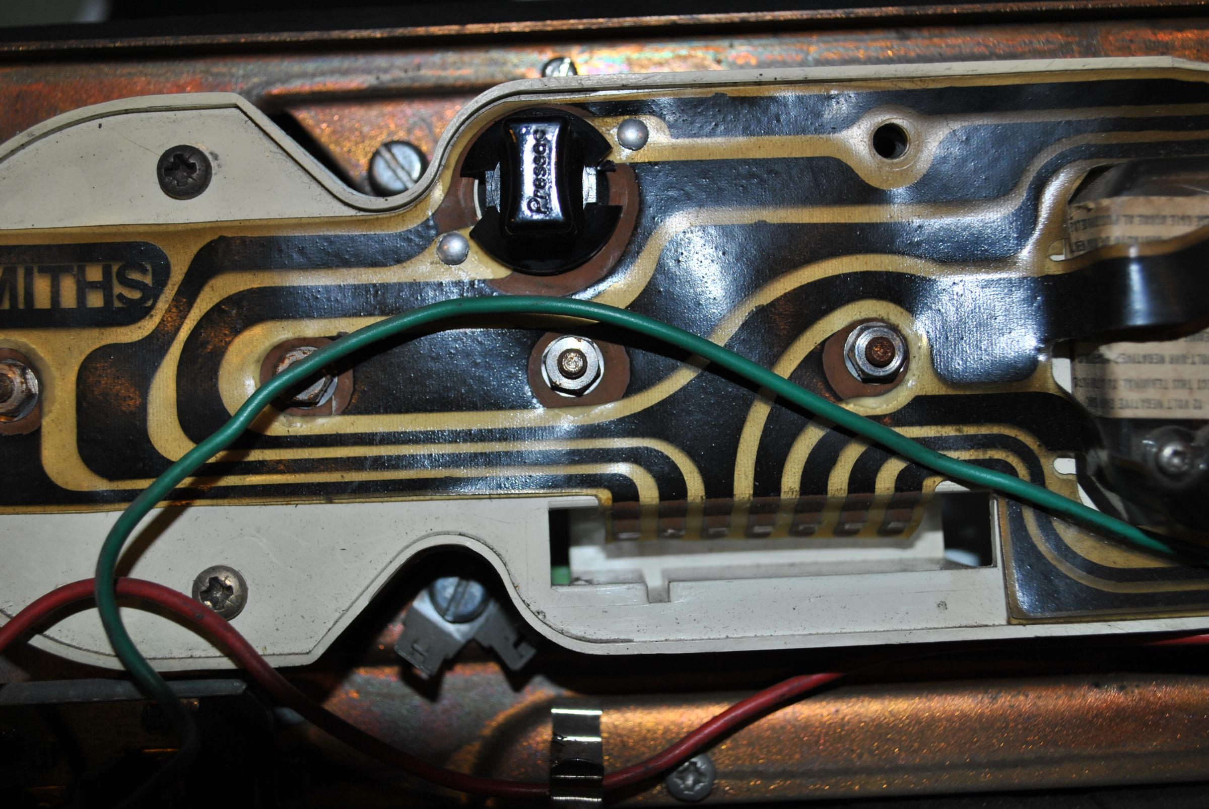

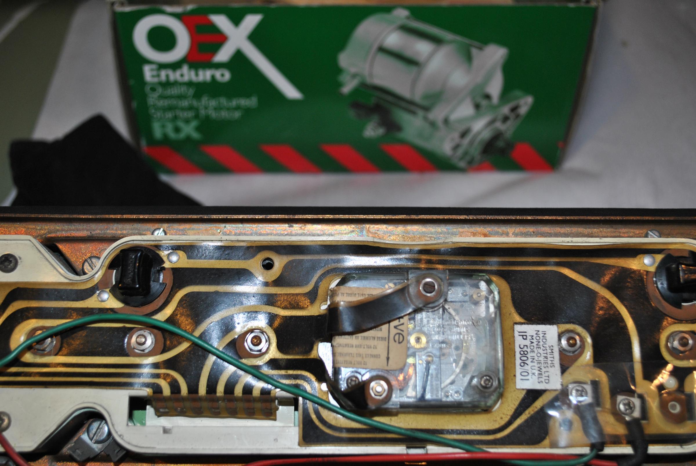

I'm guessing loose/dirty/corroded contacts on the instrument cluster printed circuit....fairly common for the gauges to go flakey as a result.
Not that big of a job to pull the cluster and clean the contact points....and add a redundant ground/earth on general principles.

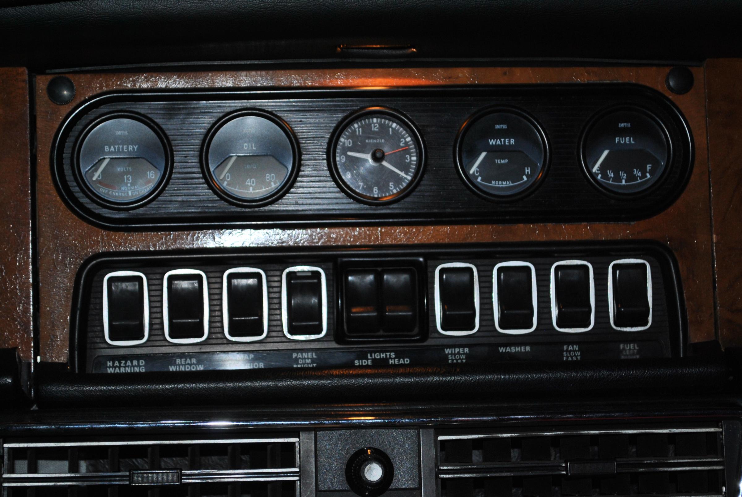

I had a similar problem with my XJ6 a couple of months ago. Fuel gauge and oil pressure gauge were going up and down more like a tachometer and dash light switch was working like a Lucas switch does,intermitent. So I removed the gauge and switch cluster disconnected all wiring(take pics or make sure you have the correct wiring diagram for your model).There is 45-50 wires in there.
Cleaned all contacts and replaced some as I went where plastic shrouds were perished, removed the printed circuit and gauges. Gave everything a light blow out and removed switches and cleaned them,reassembled the whole lot. Took about 4-5 hours in total.
Nothing has missed a beat since,except clock looses 2 minutes daily.As you can see by clock I just went down the garage to take pics of my dash and my spare so you can see printed circuit,I assume yours will be much the same.
I have added pics of printed circuit,this is fragile so take care.
Good luck
