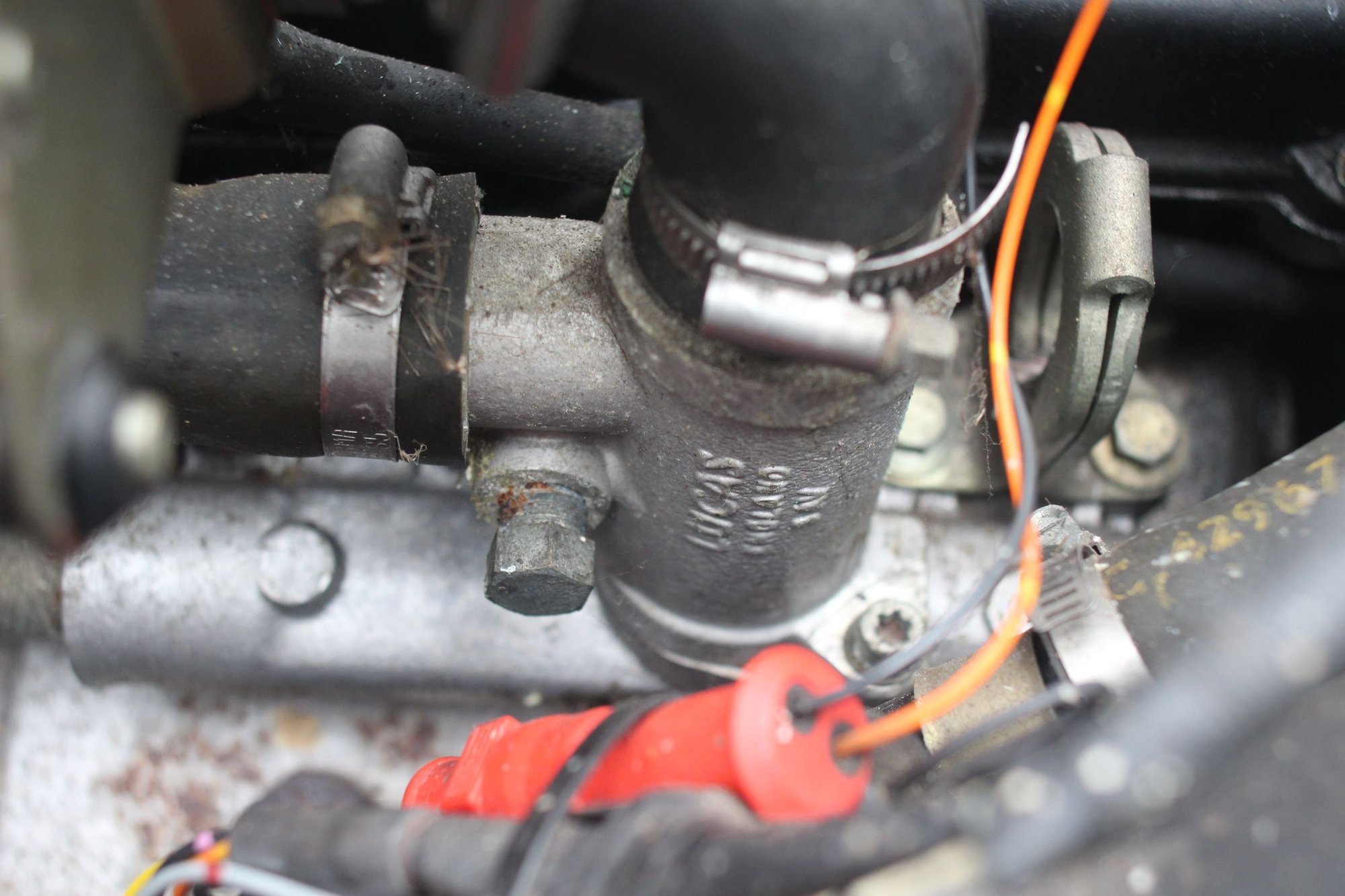

There is a bolt on the side shown in the photo in the post above, that is the adjustment. Try turning the bolt in and see what happens. If the bolt is all the way in, then the AAV needs to be replaced. It's a simple job to do.
What is happening is when it is cold the engine is getting too much air and at 1500 RPM the computer cuts the fuel when it is in N or Park and the throttle is closed. When the fuel is shut off the RPM falls, then the fuel comes back on and the speed increases and the loop repeats.
Inside the AAV is a piston coupled to a wax capsule. As the engine warms, the wax expands and pushed the piston upward and closes off the air path. It's an aluminium piston in an aluminium bore, and over time and with moisture it can corrode and not move. If the piston is stuck at the bottom of the travel ( the cold position) that lets in the most air and gives the symptoms you see. Unfortunately, it can't be repaired, opening it up destroys it.
However, as it goes away it sounds like the piston is moving, so just adjust the amount of air with the bolt and see what happens.
