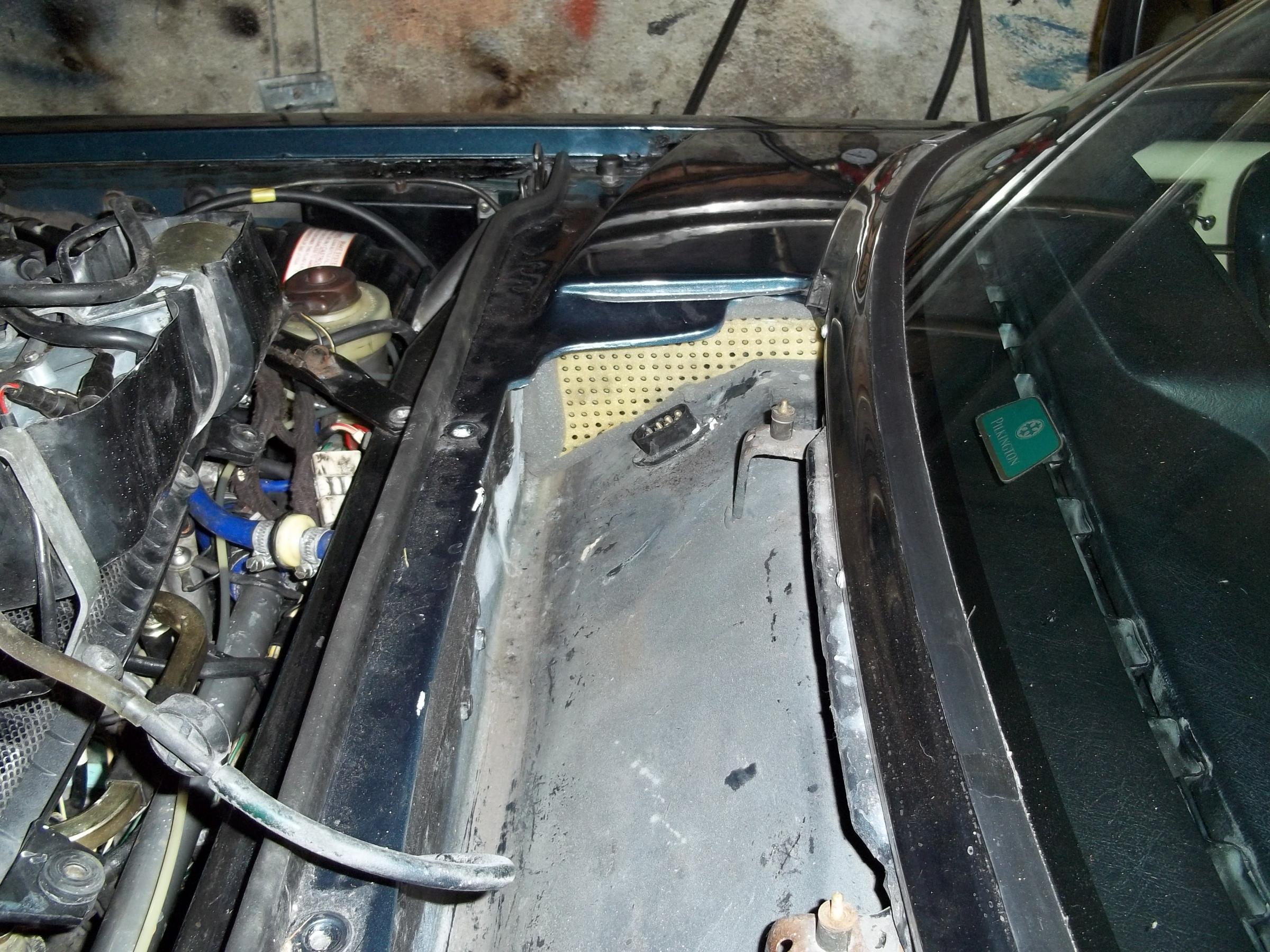

according to my research (I could be wrong) the pollen filters for facelift aren't the same as earlier cars I have seen them on ebay but the pictures they put on seem to be generic, if you have them fitted they are under the wiper motor scuttle 1 each side, but that's on prefacelift

I removed the cowel section on the 1994 xjs and it totally different than the pre face lift that you show. The filter must be on the interior of he car on the lower right. Does anyone have the correct part number.
