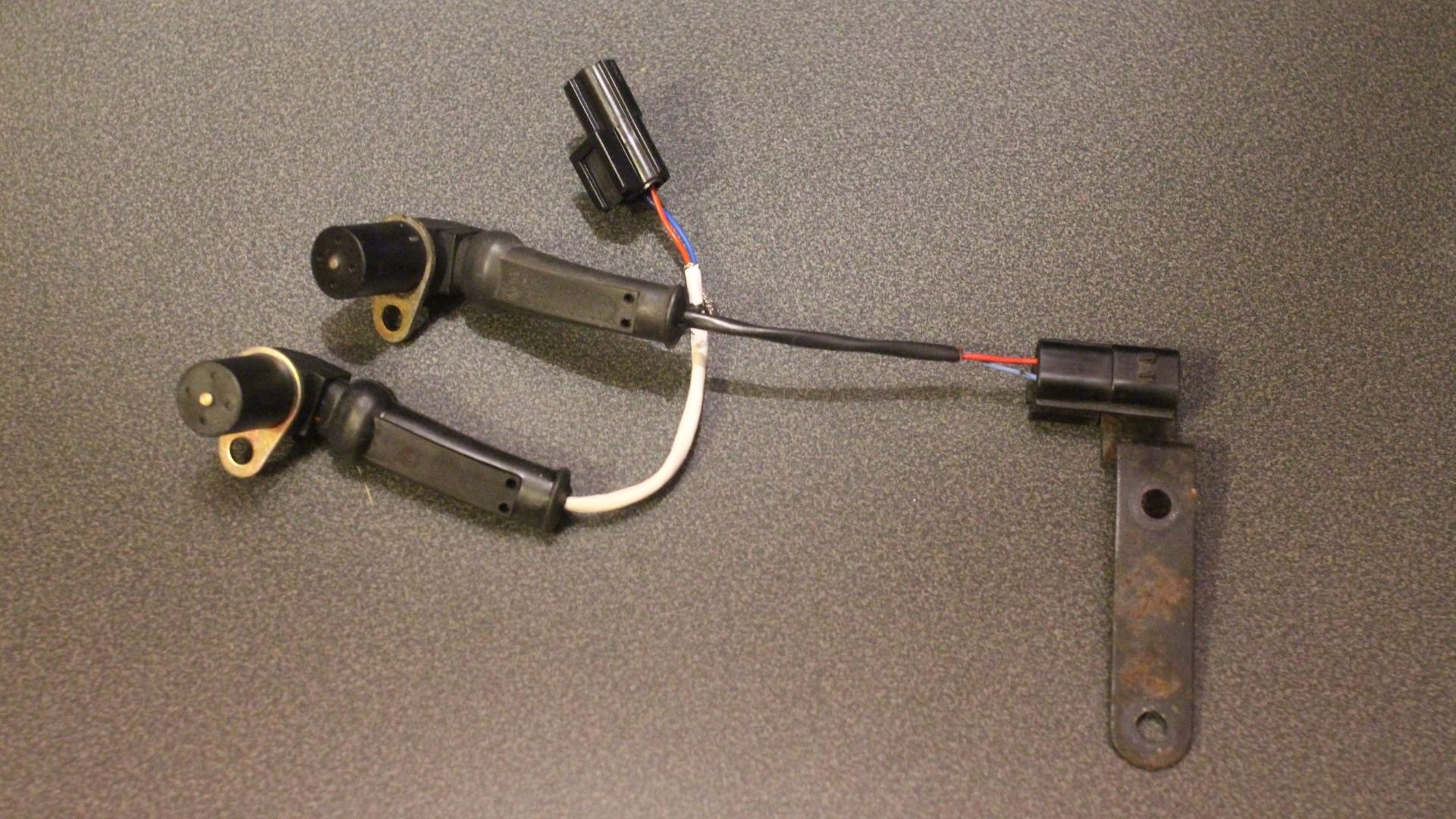

Hi Guys
New 'Crank Position Sensor' just turned up!
And it looks exactly the same as the one that I've taken off, so now I've got to swap the mounting bracket after a little bit of a clean and paint
Then after fitting this New 'CPS' in Carmen, we will see if She Starts of if not then we'll know it's something else, only problem being that the Weather could be better, as now and again it is chucking it down with rain
So if not today then tomorrow (hoping for today though obvs)
And let's hope putting it back will be a bit quicker, although regardless of what happens I will be doing a write up on my 'Cherry Blossom' restoration thread as soon as its done
New 'Crank Position Sensor' Let's hope that this does the trick

New 'Crank Position Sensor' fitted and this time She is firing as long as the Starter is turning the Engine over but She just won't 'catch' and keep running
While the Engine is turning over (with the aid of the Starter) the Tacho is reading about 750 to 1000rpm
I know nothing about these 4.0L AJ16 Engines having never worked on one before, so I'm a bit out of ideas
When I put the Fuel Tank back with the New In-Tank Petrol Pump, I put 20L of Petrol in the Fuel Tank but maybe that wasn't enough?
Or maybe there is something else that I should be trying but at the moment She sounds the same as most other Cars that you see by the side of the road that is trying to Start
I'll try and do a Short Video which may give you a better idea, although I can say that the New CPS has made quite a difference, though maybe not quite enough to keep her running
Ideas appreciated
Photos and description of how I fitted the New 'Crank Position Sensor' will be on the next update of my 'Cherry Blossom' restoration thread
