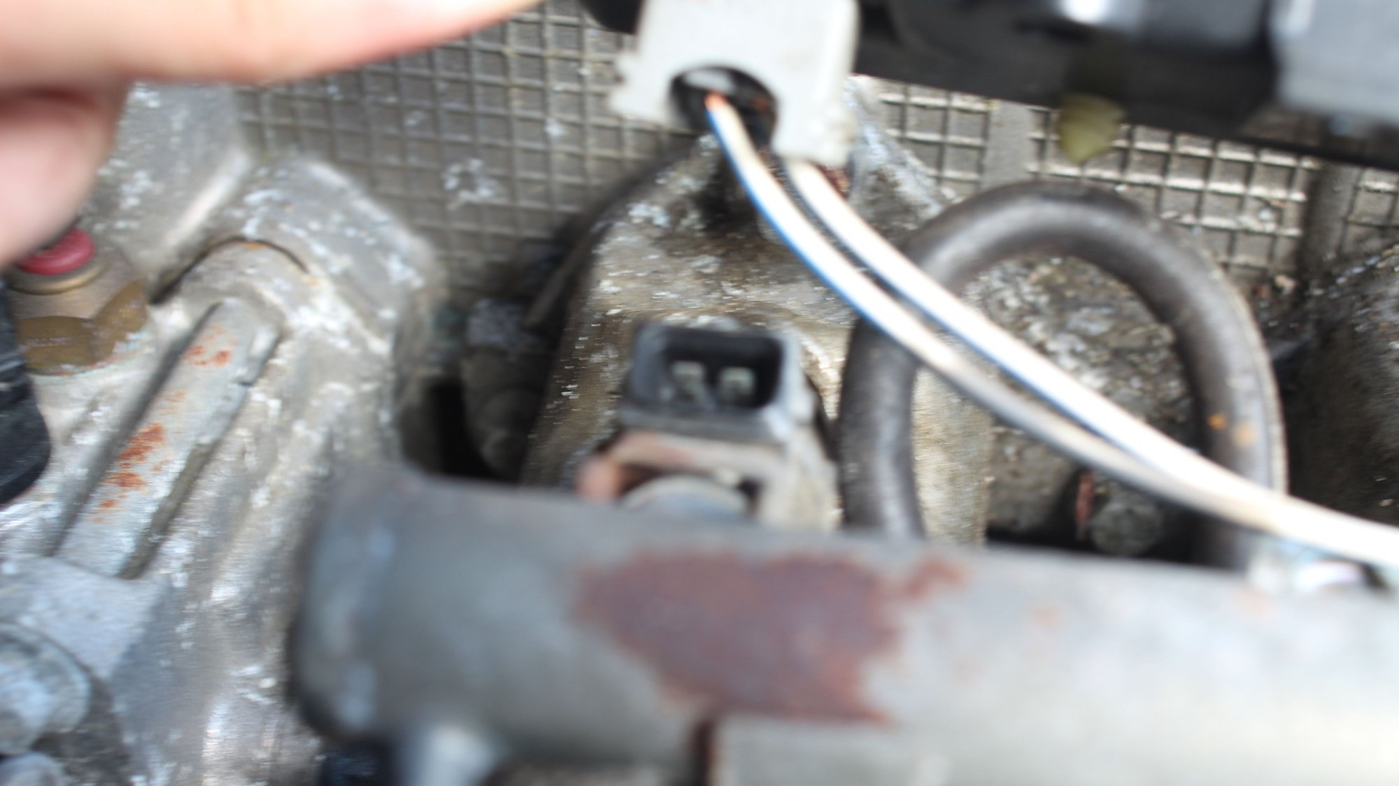

Here's what I did and what happened:
The Coolant Temperature Sensor, was reckoned to be the possible cause of a 'No Start' Problem, so I put a Bridge across the Female Sockets and then spun the Engine
Where She went from trying to Start to not wanting to Start at all! (She didn't fire once) in which case it would appear that the Coolant Temperature Sensor was OK and so I reconnected it as was
Next I tried out Daim's suggestion of using a 'Bulb' and although you may have got there first by mentioning a 'Noid Light' at the time in question, I didn't have any idea at all what a 'Noid Light' was
And so I went with Daim's idea of using a normal Bulb, which I connected to the Plug of No1 Injector, where after 5 revolutions the Light Bulb Lit on the 6th! (Genius idea Daim!)
But when I tried to do that again, in order to make a Short Video, the Light Bulb didn't light!
Maybe a Wire lost contact of maybe it blew a Fuse but the fact that it ever worked at all, is very much leading me to think the Injectors are getting a Signal
Or at least they would be, if only for one thing!
The 'Pins' on the Injectors, take the word Corrosion to another level, as they are almost Black!
Which could easily be the Cause of the 'No Start Problem' very, very, likely I would think!
So I am going to Clean the Injector Pins and then try her again and if that doesn't work, then I'll take out the Injectors and give them a Clean
I've got some Electrical Cleaner and also a Spare Injector Plug, which I used to Clean the Injectors on my V12 'Cherry Blossom'
The light at the end of the tunnel, is starting to look a bit brighter, with hope now in sight!

But I think I've finally managed to track down the problem (although I think I may have said that a couple of times before)
Having taken the Electric Plugs off from the Injectors, I tested each of them individually with a 9 Volt Battery and then a 12 Volt Battery and could not hear any off them 'Click'
So I pulled the Injector Rail out of the Car together with the Injectors (not all of which came out when I pulled out the rail)
Taking out that rail was a real nightmare, as it was in there so tight that I had to lever it out with a piece of wood but having eventually managed that, the next job will be to Test them while they are out of the Car
So the Plan is to put them all back on the rail and then block up one end and then fill the Injector Rail with Carburettor Cleaner and then apply low Air Pressure to the other end of the Rail
Then using my Spare injector Plug, give each of them a quick 'dab' of 12 Volts and then see if they squirt, or if they are going to need replacing

Because I've found the problem and a very expensive one too!
As having tried everything that I could think of, I decided to delve a bit deeper and pull out the Fuel Rail together with all the Injectors and they were in there really tight I can tell you
And then I decided to Test them on a Homemade rig and you'll never guess what or maybe you would, 4 of the Injectors were burnt out!
(Just like you just said)
I wonder how many people have ever thought that might happen?
You run out of Petrol = New Injectors!
Your Fuel Pump packs up = New Injectors and a New Fuel Pump!
And while I'm sure there may be times when you can get away with it, there must be an equal number of times when you can't, as it certainly looks like I'll have to replace everyone of those Injectors on the Fuel Rail
As when I tested them on my Rig only 2 of them were working, so that was probably why She was trying to Start but wouldn't pick up
Where as for the back story, 'Carmen' was an impulse buy, which then just sort of left me with another XJS I didn't need, as I've always thought She was too nice to use
And lack of use was certainly what must have caused this problem

'Carmen' No Start Mystery finally solved! (XJS 4.0L with AJ16 Six Cylinder Engine)
Coils burned out on 4 of the Injectors of my 6 cylinder AJ16 Engine, which may have been caused by blocked filters in the top of the Injectors, which in turn resulted in Fuel Starvation causing the Injector Coils to burn out
When measuring the resistance on my Meter, 4 of the 6 Injectors had gone 'Open Circuit' leaving just 2 of them working which was probably why she sounded as if she was trying to start
Full story with Pics on my 'Cherry Blossom' restoration thread on Page 95 and here is a link to that page: 'Carmen' No Start Mystery Finally Solved
