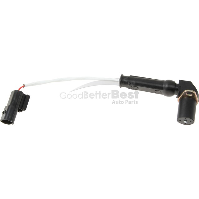

I am sure they are not the same. They should however be the same on the '95 to '97 XJ6 4.0L with the AJ16 motor. This is what they look like and like I said I am positive it is the same part as the one used on the AJ16 XJ6 but you will want to confirm before you order. As you can see they are not that expensive so worth replacing as a starting point. The one I posted is listed on ebay in the USA but should be available also in the UK so just check on your EBay or through your trusted parts store It is one bolt that holds it in place and it reads the signal directly off the crank pulley.
https://www.ebay.com/p/Eurospare-Eng...5958773&chn=ps
Eurospare Engine Crankshaft Position Sensor Lhe1640aa Jaguar Xj6 XJR XJS

Many thanks for finding that Crank Sensor especially the Part Number which also checks out with a well known supplier of Jag parts in the UK
They can supply an Original OEM for around £50 inc delivery and vat
But first I want to get the old one off, so that I will know the way to put the New one back on
