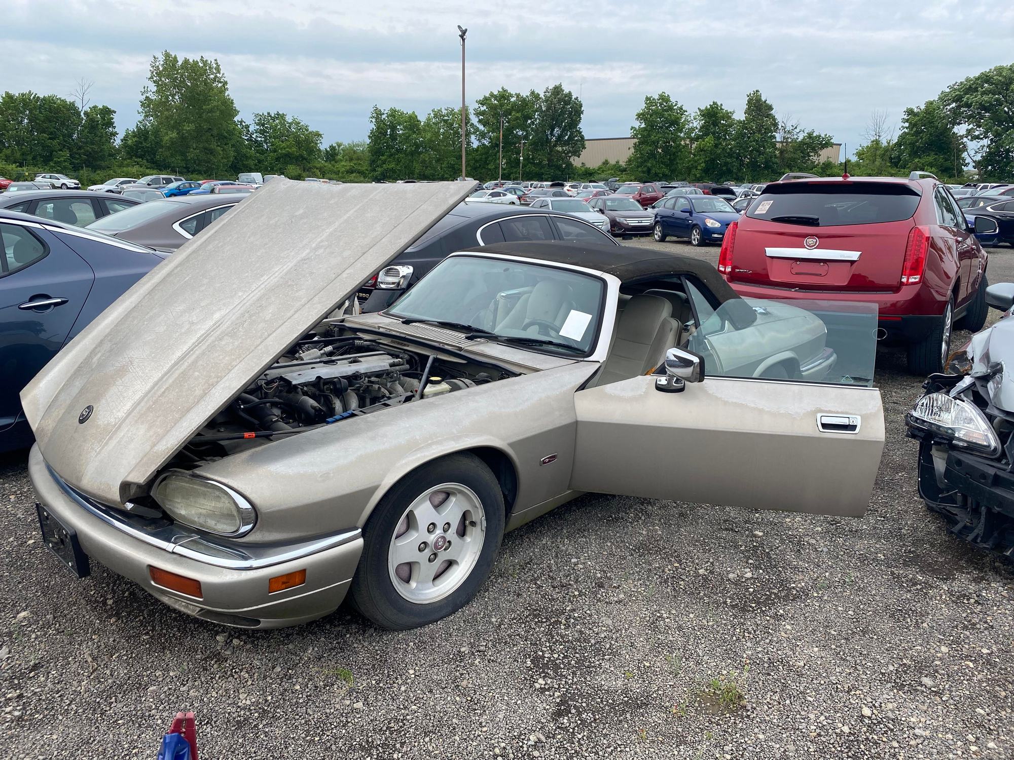

Hey everyone. Just made a relatively cheap purchase of XJS convertible that's been sitting at my work. One previous owner as far as I can tell and looks like it's been sitting for year(s). I bought this, knowing that I need to make repairs and overall give some TLC to the vehicle.
Aside from concerns of thinning/faded paint, dry rotted tires, cobwebs everywhere and especially the leak that pools water onto the driver side floor, my BIGGEST concern is that I can't seem to get it started. It'll crank and catch a few times but doesn't want to turn over. I've been looking at fuses and relays. All fuses seem good, relays have been cleaned (all relays in the engine bay had a bit of corrosion). I still need to get a voltage meter to test all relays. My thinking is the fuel pump is not turning on (can't hear it buzz when key is turned). I can't seem to find where the relay is either. "Right hand side in the luggage compartment above wheel arch" but haven't found it yet. I've spotted the relays/motor for the convert top and fuses in front of the right tail light but no fuel pump relay.
Additional notes, it still has all old fluids in it. Bad fuel could be another culprit. I filled up the tank to a half (it was around a quarter) with unleaded cheap stuff not knowing I should've used the octane stuff. I work at auction and my lot tech only carries cheap gas.
