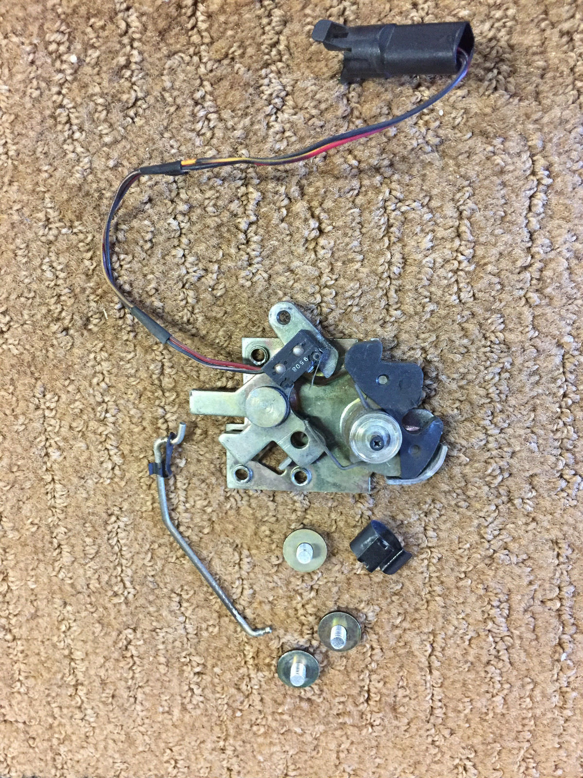

It's part of the "Rube Goldberg" trunk latch mechanism. You can see it in the picture below it's the black switch stamped "9508"

Thanks for the sage advice Paul. I've decided to abandon the trunk lamp project. I have several flashlights, one of which should serve that purpose.
While exploring the trunk release I found the "mr fixit" below ...
Can someone explain what is missing belongs in place of the nail??
Steve
Bodge for the trunk release'
