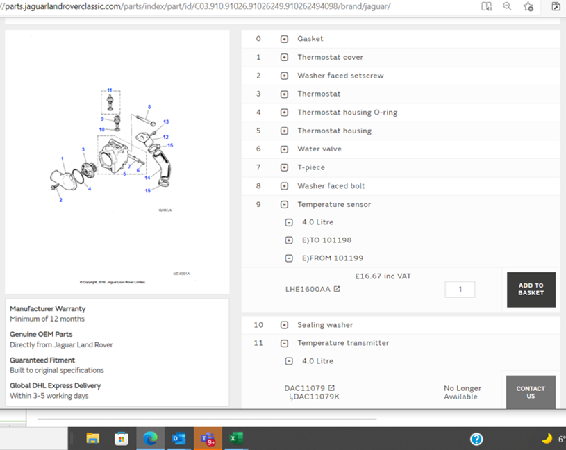

- the coolant temperature sensor (CTS) that sends a signal to the ecu to influence fuelling
- the temperature transmitter that sends signals to the temperature gauge
The CTS is LHE1600AA as advised by Vee. This is the key factor in temperature signals for fuelling
The temperature transmitter is DAC11079. Even if failed, this shouldn't affect fuelling.
Slightly confusingly, they sit side by side on the thermostat housing on an AJ16 and look similar.

OK, that's a bit clearer. As you've indicated, the item you've changed is the temperature transmitter. This merely sends a signal to the gauge. The signal is a measure of resistance driven by the temperature in the thermostat housing. If the gauge pegs straight to hot, but previously sat ok, I would SUGGEST that the transmitter is not exactly the correct one. Did you purchase it from Jaguar or is it a pattern part?
Are you in a position to measure the resistance that it is showing when the engine is completely cold but the transmitter is pegging the gauge to Hot? I will try and look up the resistance readings and where they should move the gauge to. I have heard of a number of these pattern transmitters that do not transmit the correct resistance reading. Some people have still used those transmitters and then by working out the actual resistance readings compared to what they should be, then added an inline resistor of the correct value to force the gauge to where it needs to be at normal temp.
Anyway, don't worry about the transmitter at this point. If the engine is stone cold and the gauge pegs to Hot, there is a either a problem with the transmitter, the wiring or the gauge, not the thermostat or engine.
The Temperature Transmitter does not affect the fuelling at all, so in theory, changing it, or even disconnecting it can't affect how the car runs.
However, the Temperature Sensor ( the one with the plug clip) absolutely does affect how the car fuels. If it's sending a signal to the ecu implying that the car is cold, it will run richer, irrespective of what the temperature transmitter (and the gauge) think is the temperature. I'm not sure if I've got any docs that give the sensor readings at different temps that you could check, but I'll have a look.
My suggestion of bridging it was to take off the plug, use a bit of wire to bridge across the terminals on the plug and see what that does to the fuelling. It's just a crude way of seeing if the sensor is causing a fundamental problem.
