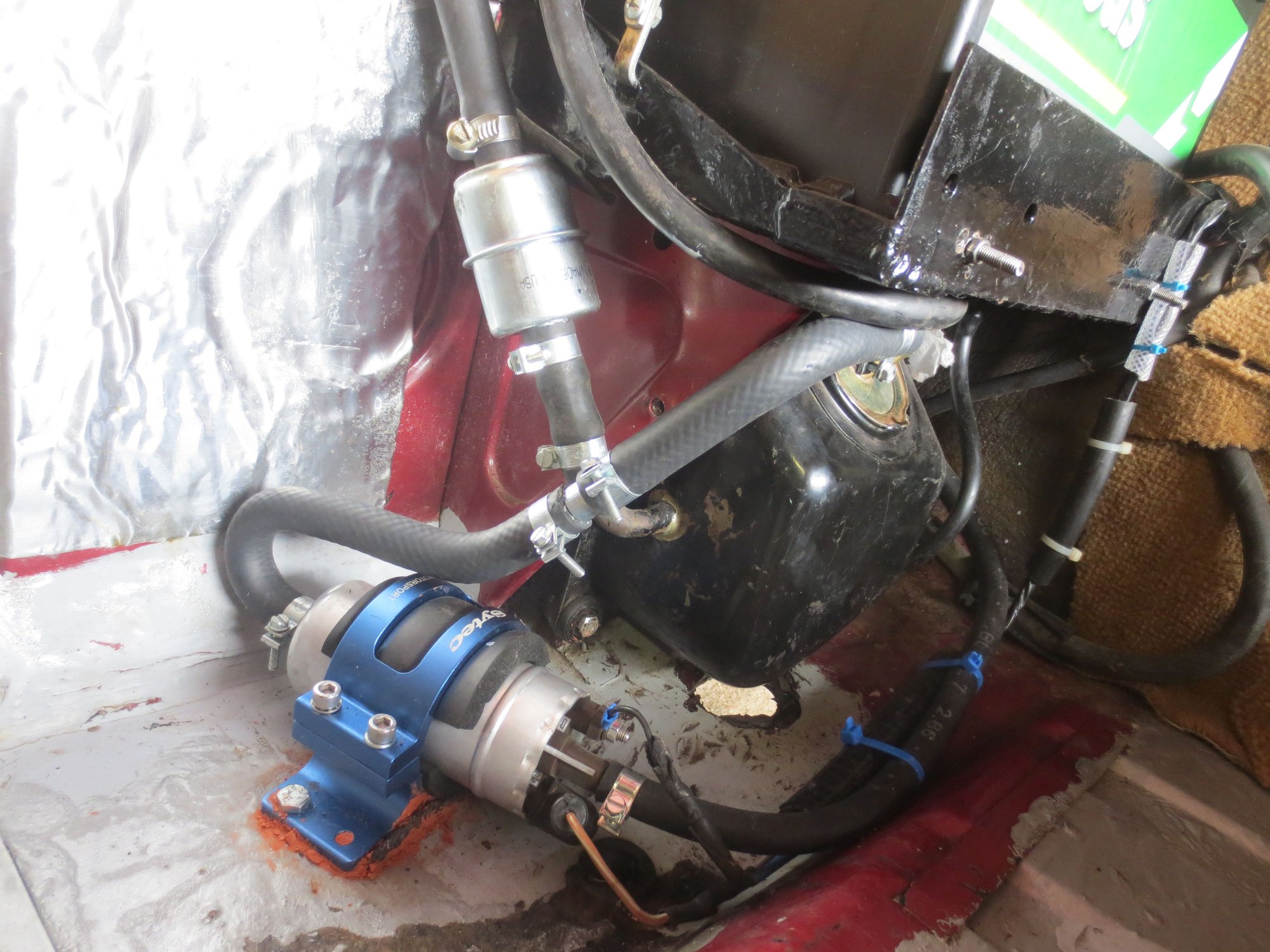

This is a snap of the Wix pre filter in place and no sump tank sock filter. Works well.

That is an easier placement than I was planning to do. I wanted to put it between the sump tank and the pump, but since that is 1/2 inch line I am having trouble finding a clear filter for it. I may just rethink my plan there.

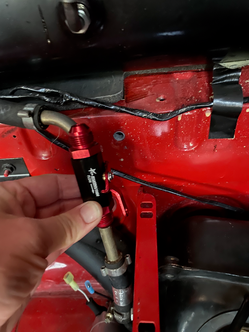

I'm doing a similar thing, so thought I'd drop my design that I'm thinking about. I'm going to use AN8 and AN6 connectors to manage joins and preventing the hose curves. I'm doing a similar thing with the feed lines to add a fuel pressure gauge inline and a check valve near the rail...

That looks effective too. My strategy continues to evolve. Along with my clear plastic fuel filter I think it would be useful to have a shut off valve on each side of it in case it does become clogged. That way I can change the filter as needed without making a huge mess in my trunk. Pirk, it looks like you have one there coming off the main tank. Where did you find it?
@jerry_hoback I sourced all that through Amazon as I'm on a bit of a time crunch due to a bet I made with a buddy restoring a Lotus M100. I'll probably go back in later when I have more time, but in any case here's the link -
Amazon Amazon
And a pic...
