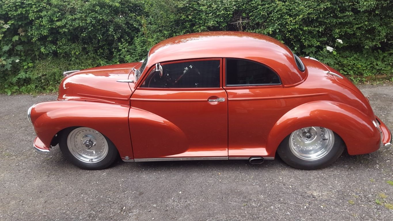

Ha! You're right it's not in an XJS. I posted here because I think the 2:88 was fitted in V12 XJS and I am sure there are plenty of knowledgable people on here when it comes to Jag parts. My diff is going in a Morris Minor!
Yes the 4:55 is hopless. Great for ripping up tyres no good for cruising at 70mph.
Oh and the motor is a 4.6L V8.
Old Aug 22, 2021 | 04:41 PM

Nice car, ilike the side pipes, and kool wheels!
ron
