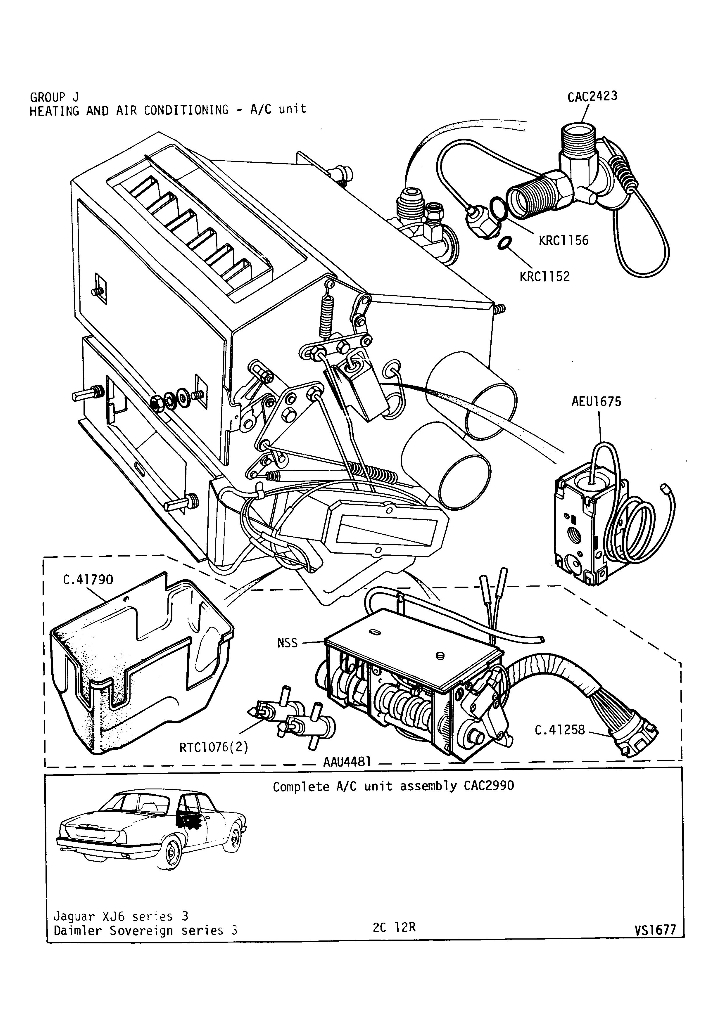

I don't seem to have any vacuum to the heater valve - I assume that vacuum is required to close the water valve? I think there is a solenoid somewhere to apply vacuum? Can anyone tell me where it is and a part numer? Tks

Vacuum to the heater valve is controlled by a switch located on the servo assembly. There are two identical switches, part # RTC1076. The inner of the two is for the heater valve
However, these don't fail often.
Do the various vacuum actuated air flow flaps operate when you change the settings? If not, you might have a vacuum supply problem--no vacuum getting to the control switches.
Do you hear a faint whirring sound if you slowing adjust the temp dial? You should. If not, the servo is not operating...and the servo actuates the vacuum switch for the heater valve.
