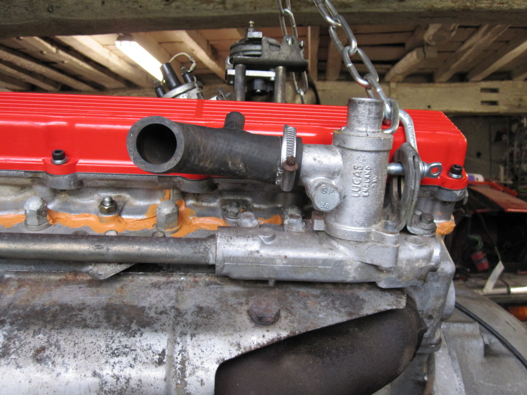

I think the oil light came on because the car was stalling and prssure therefore dropped. On top of the very good advice about cleaning the fuel systems,if the car ticks over at below 700 rpm it is a good idea to speed it up a bit. The tickover is controlled by a huge bolt on the Auxiliary Air Valve which is a whole subject in itself (see Kirbert Palm's free downloadable book on JagloversForum). If, big if, the AAV is working as intended, you turn this bolt anti-clockwise to speed up the tickover. It is located on the US driver's side of the engine, at the driver's end of the engine, just below and to the right of the air filter casing and looks like this:
The bolt head you can see is what you turn.
