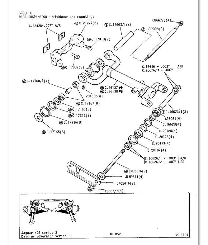

I had to remove the inner control arm pivot from the diff to get the cover out. One bolt was tight with a shim pack, the other one was loose but retained by the safety wire and no shims. Does anyone know if they are originally shimmed equally from the factory? I was considering putting the original thickness shim pack in both places.

The shims are unique for each rear end, they control the rear toe. So they will be placed on an "as needed" basis.

I hesitate to disagree with a member as knowledgeable as Jagboi, but my belief is that the shims are there to enable the fulcrum pin, on assembly, to be slid through the eyes of the cage and the eyes of the diff 'dog bone' castings with no binding.
ie: The ease of inserting the pin is what the shims are for, and it is a case of just adding to each end of the casting, between the casting and the diff, whatever thickness of shims is required to allow the pin to be inserted easily. The cage position of the pin eyes are what (unadjustably) sets the lower wishbone angluar position fore and aft.
You are lucky that one end is still tight with shims, so my suggestion would be to tighten up the bolt with the shims there, and then measure with a feeler guage the gap under the other end of the casting, and add shims to that so the gap is just filled. Then tighten up.
I strongly recommend using high sttrength Loctite on the bolts; they do work loose.

Just to be sure, we are talking about the shims C28428? That go between the inner fulcrum bracket C21977 and the differential?
I had a reread of the manual, and Greg is correct, they are to allow the centre to centre spacing of the inner fulcrum brackets to match that of the cage when bolted to the diff. I know a guy in England who is into racing and he also uses those shims to control toe, with suitable modifications to the cage.

Those are the shims. I got it back together after measuring the gap front and rear, ended up with .020" front and .018" rear. I made the shims with a hole in the middle, no slot so they can't come out in the future. I think that backs up the fact the original shims fell out of the rear location, thus the loose bolt. the bolts are installed with a generous dose of red loctite
