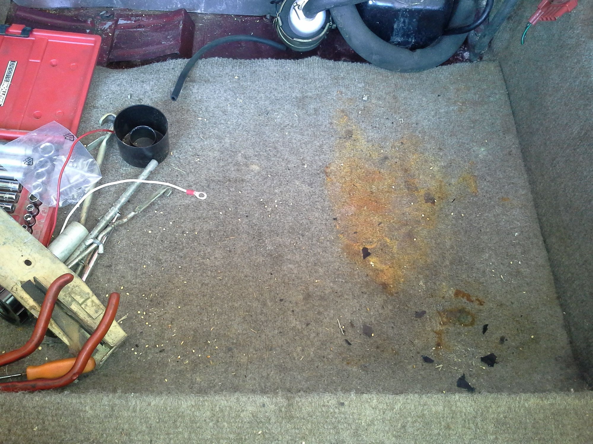

Hi Brad, what kind of shape is the trunk bottom piece of carpet?
Thanks Jeff

Trunk carpet and pad is in very nice shape. No stains or holes. Just needs a little new spray glue in a couple of spots adhere the carpet to the foam pad.

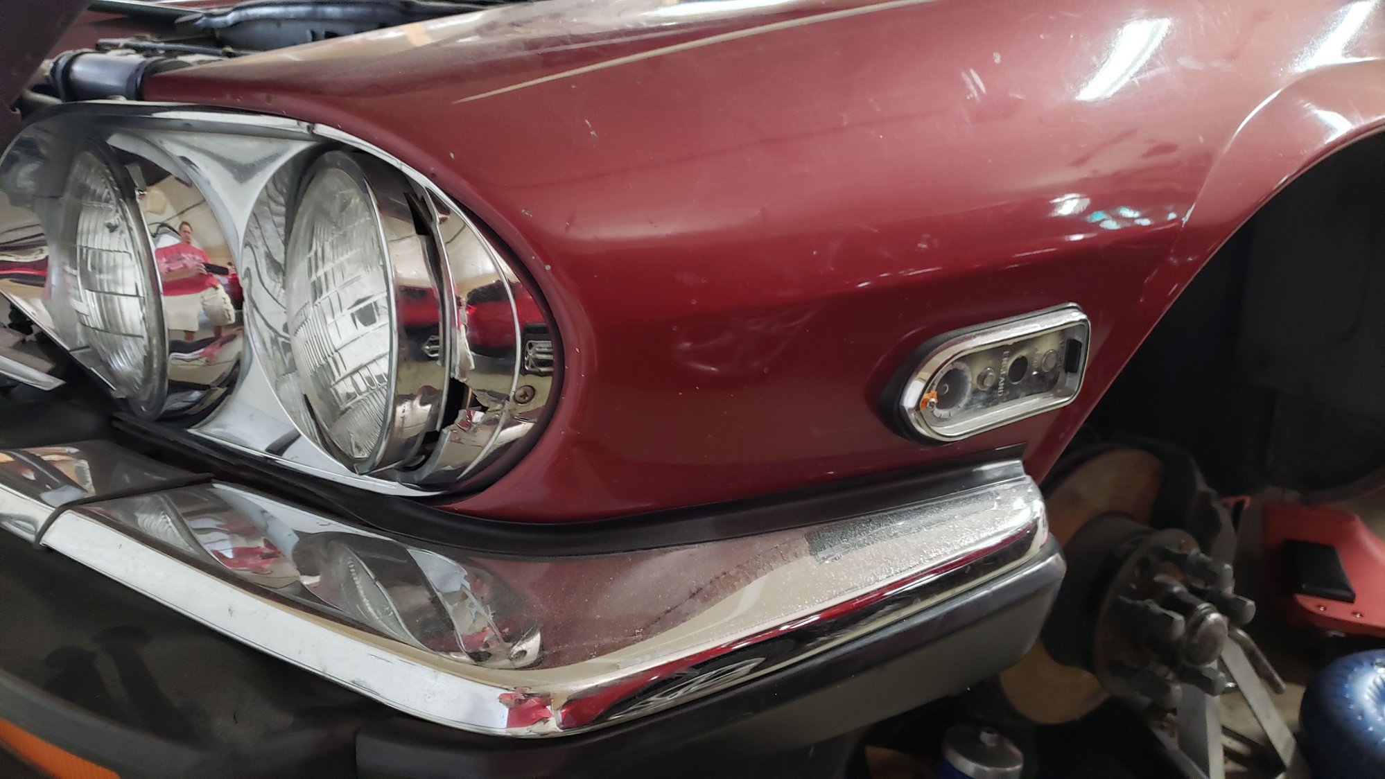

Didn't see the picture about the front outside turn signal lens' but all four are in find condition.

just take it off the pad, that'll be easier to ship. Pic of the signal lens
