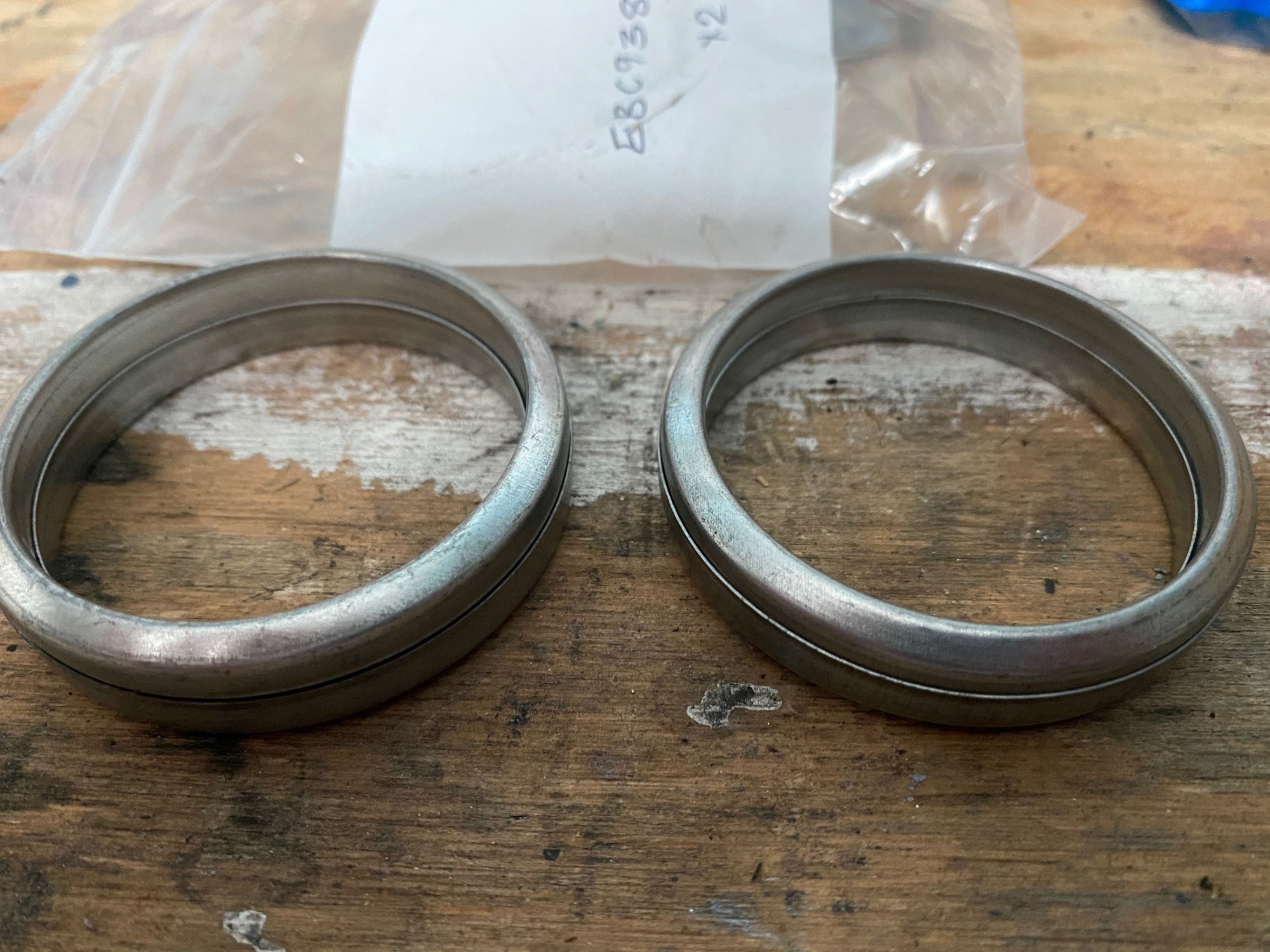

Brinny
Genuine Jaguar crushable manifold to downpipe sealing rings are NLA. The aftermarket ones are not as reliable, and I have found need nipping up for about 4 months of use before properly being tight. I am not saying this is your trouble, it might be the fixings, but if you used aftermarket rings, it is probably the reason.
I have four genuine ones in stock against the day I cannot afford petrol and decide to rebuild the motor to keep myself occupied!
Greg - how do these compare with your originals? I just got these from SNG last week and they look exactly like what I'm replacing, albeit not compressed Should I be concerned with these not getting right?

They will work OK, non-OEM ones do look like the OEMs, but they are not quite the same, but you have no other options as far as I know. They just need re-tightening a few times, so make sure you can get a long extension up from below to do that, after the car is back together.
I find this NLA situation from Jaguar really annoying and casual; nearly all the classic models use this part and it is quite obvious they could be made to the same spec if a bit of effort was to be made.
