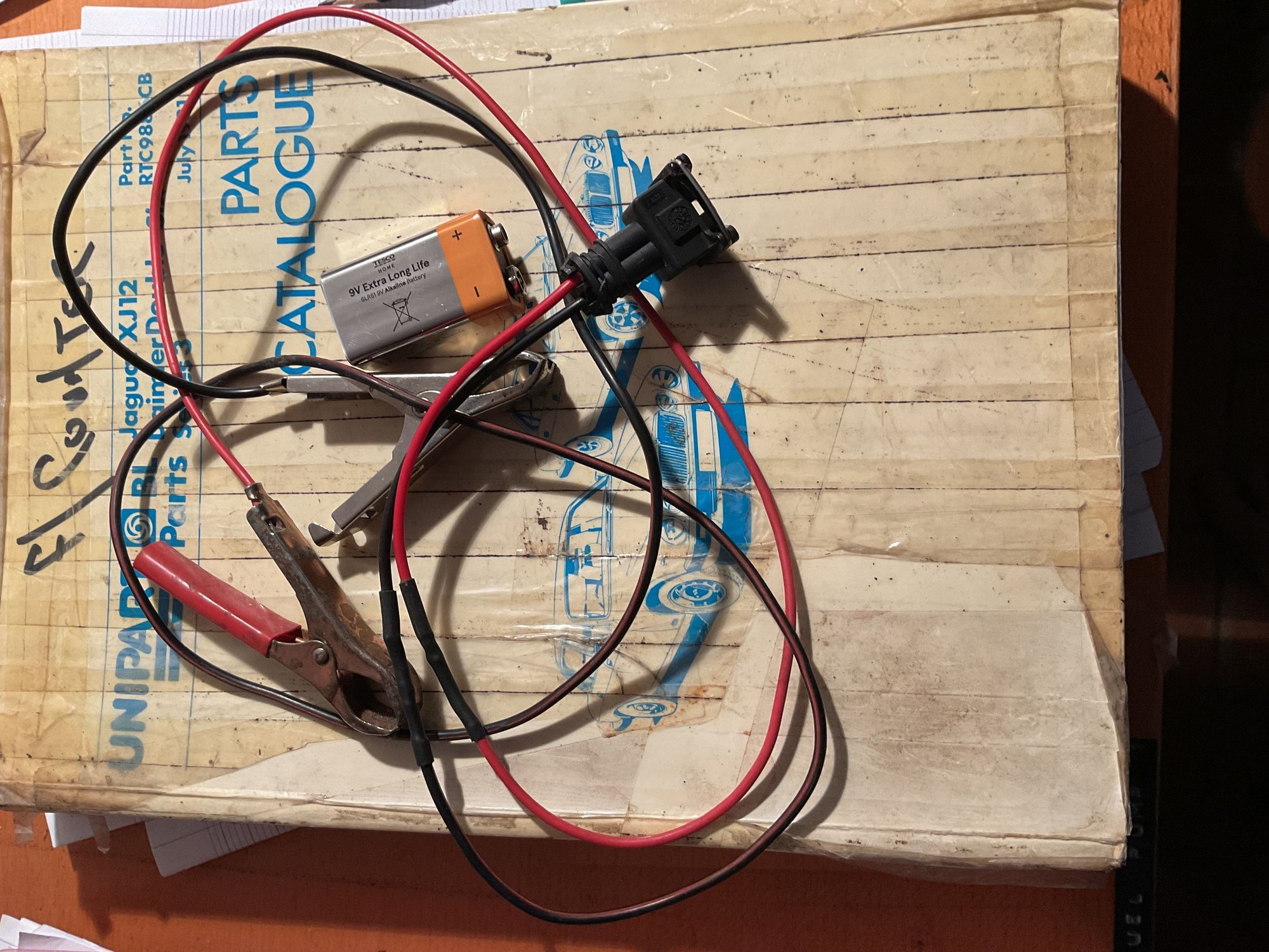

Hi, before you go down the route of ECU wiring or issues its worth putting a 9 v feed to each injector, you should hear an audible ‘click’. I made up a simple injector connection (Amazon) to a 9 v battery and by simply energising the injector on and off you can sometimes free off a stuck injector. With the v12 ‘ s just be careful removing the connection from the injector,its a case of getting the retaining clip slid to the side before you pull it off, good luck

Thanks guys . It will try to putt with starting fluid. I've order injector plug to do more testing . Thanks for the advice. Just 9 volts works not 12volts?
