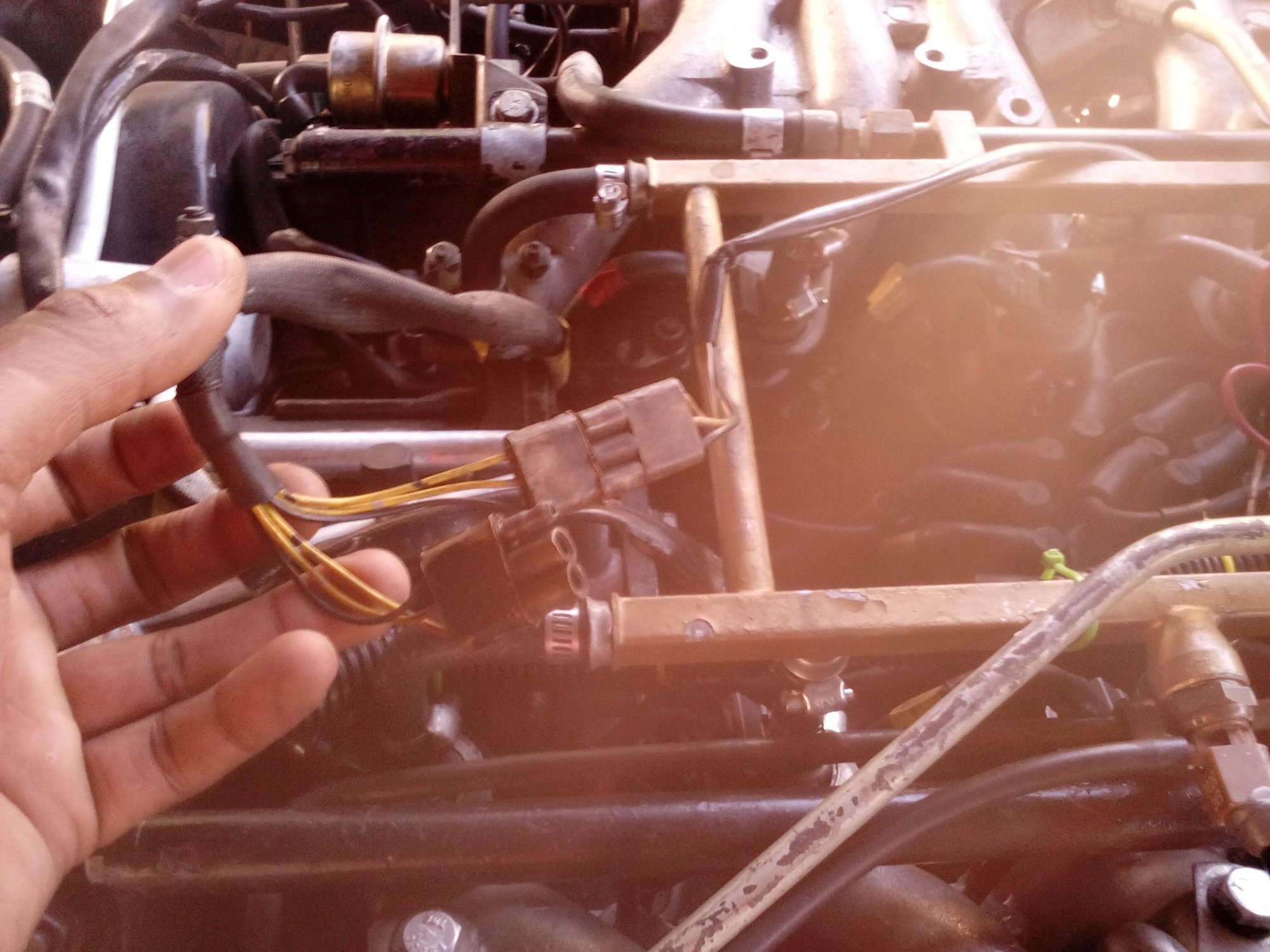

Sitting near distibutor cap and plug wires. What does this go to?

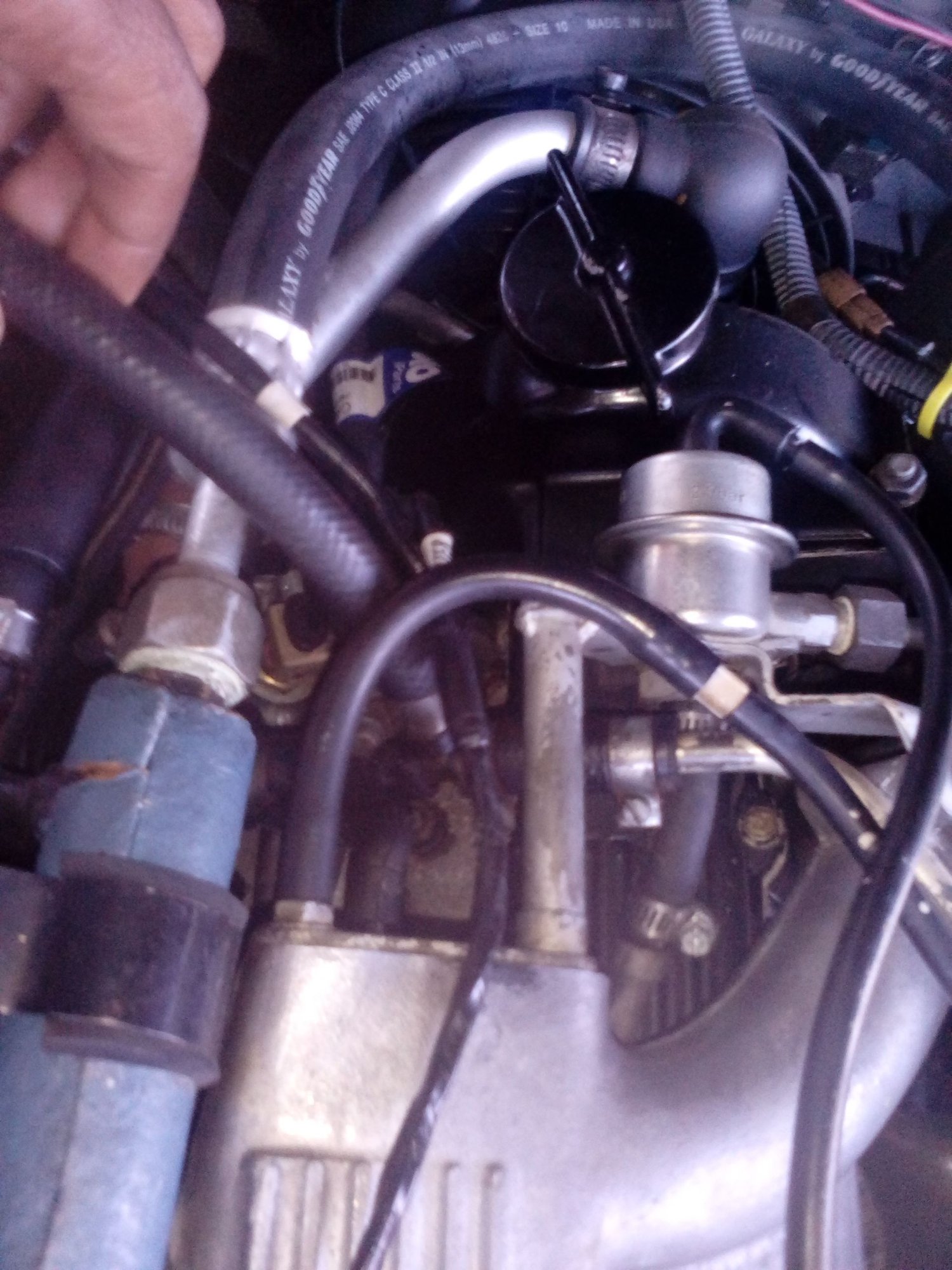

This was broke away from next picture coming from engine

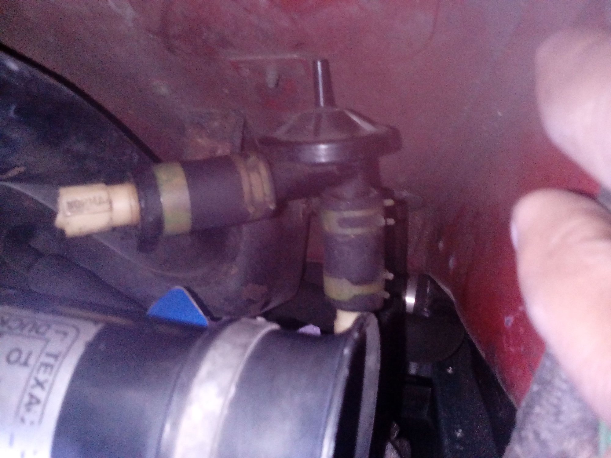

What is this? What is plastic valve? Its broken and was attached to other hose

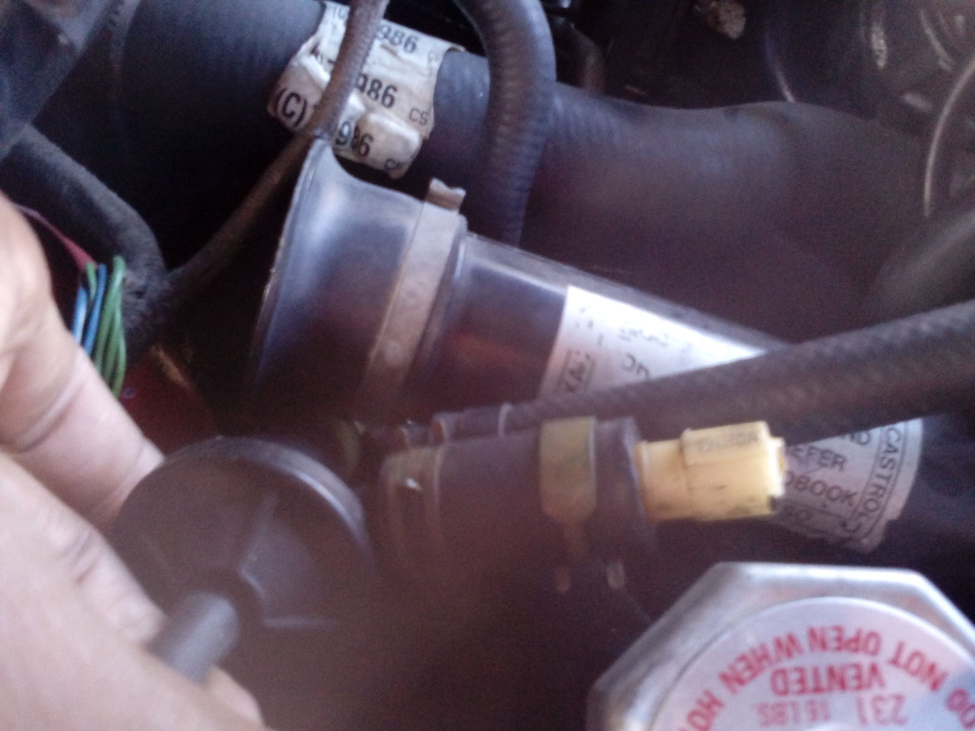

This is loose as well and i dont know where it goes. Any help

Pretty sure the plug and cable in the first 2 questions are to the cruise control, looks like someone has removed the bellows unit just behind the a/c compressor, there would be a two wire connector, vacuum line and the cable you have in your hand not being used if it's been removed.

In the Pic where you are holding the Broken Cable from the Cruise Control, you can see a Coil and if you look closely you should see another one right underneath it. (so you've got Two)
Don't get those 2 Plugs mixed up or She won't Start!
As for the FPR's The FPR on 'A' Bank is the most expensive one of the Two! 'No I don't know why either' but it doesn't do anything useful, so no need to replace it.
Its the one on 'B' Bank (The Cheaper one) that needs replacing if any but easy enough to change on the Fly, at the side of the road, if you keep the new one as a Spare in the Boot/Trunk.

Your car will be fitted with a device that caries fuel fumes from the tank to the intake on the LHS o the engine, via a hideously complicated device in the RHS wheel arch. I am pretty sure that the pipe and bit of plastic comes from this. If you are allowed to, it is best to remove the entire mess, block off the place it enters the inlet manifold, and vent the tank to air via a two-way valve.

Before I would start troubleshooting I would like to get this obvious vacuum line that's coming from/ near fuel injectors. Its a off white piece of plastic that I need that was connecting the hose from/near the injectors to this piece that is connected to a hose that goes into the wheel well its near as Greg stated.
Does this whole piece need to be replaced or just off white plastic?
This is where the hose is coming from that goes into the off white plastic. Thanks for help

That is definitely the fuel tank breather system, which believe it or not is linked to the fuel tank. You can cap it off at the engine; but you must ensure the fuel tank can breath, even if you leave the filler cap slightly loose while you get things going. If allowed, the best idea is to fit a two-way breather to one of the vent pipes in the top RH corner of the tank and vent it to outside, blanking off the others.
