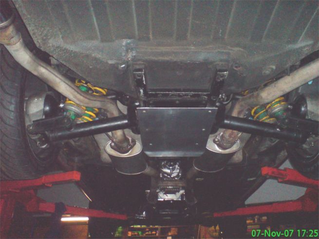

Yes there is enough room under the diff alternatively you can go between the LCA and driveshaft. I have attached a couple of pics the under the diff is an XJ not XJS but the rear is the same.
I am going to install the center mufflers and see what it sounds like, then if its too loud I'll add rear silencers.
I had to cut the pipes through the cage to get them out and one of my Cats was totally stuffed, so a new exhaust is needed. I am going to use 2.5" from the downpipe with 2.5" cats and run the pipe between the LCA and drive shaft. Care is needed here to ensure the pipe is not fouled on suspension travel. I will install the center mufflers only to start with.
