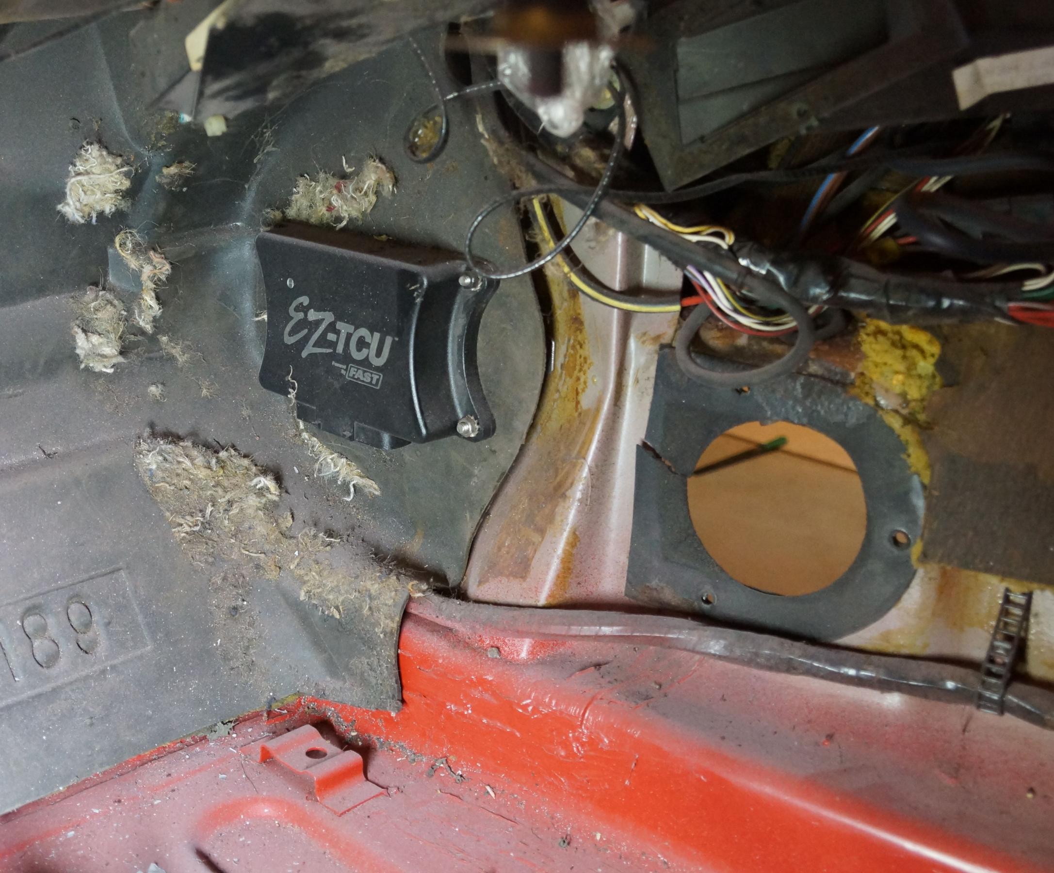

I have it the other side of the footwell, opposite the marrelli ecu. Seems handy for inputs and outputs and easy access for the handheld hookup. There is a handy bulge in the panel there, I assume it is meant for the go pedal in RHD models.

That will work. You could use a cable gland on the access plate.
I will call Jagdaim on Monday about the 4L80. I figured that any 4L80 core for under 1000 was a good deal. Buying a $300 core from the USA would be $1000 by the time it was shipped to Aus (without finding someone importing something else).
I think I will either replace the internal loom or crimp a new connector on the Jag harness if I can not find the correct connector.
