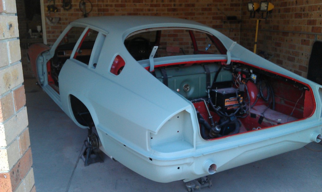

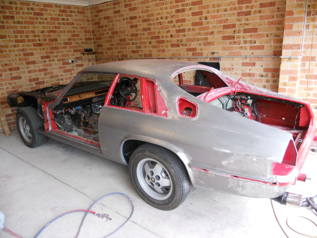

Been a while since my last update. Finally have the car painted. 2 pack ISO free painted in my garage. I am very pleased with the results, a little orange peel and some dust. I plan on clear coat so she will be wet sanded which will remove any peel and dust.
The bonnet here has already been wet sanded with 800 ready for clear
Hibuild primer
2 pack epoxy primer (nasty stuff)
Stripping to bare metal what a terrible job must it must be done. I want to remove as much plastic filler as I can.

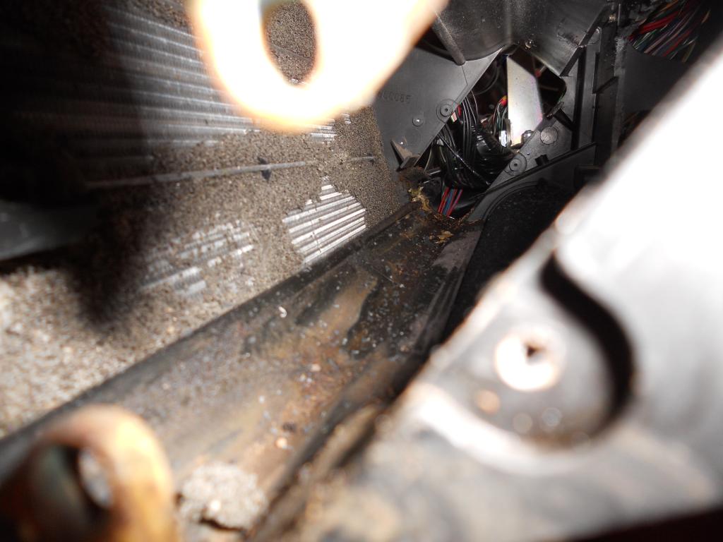

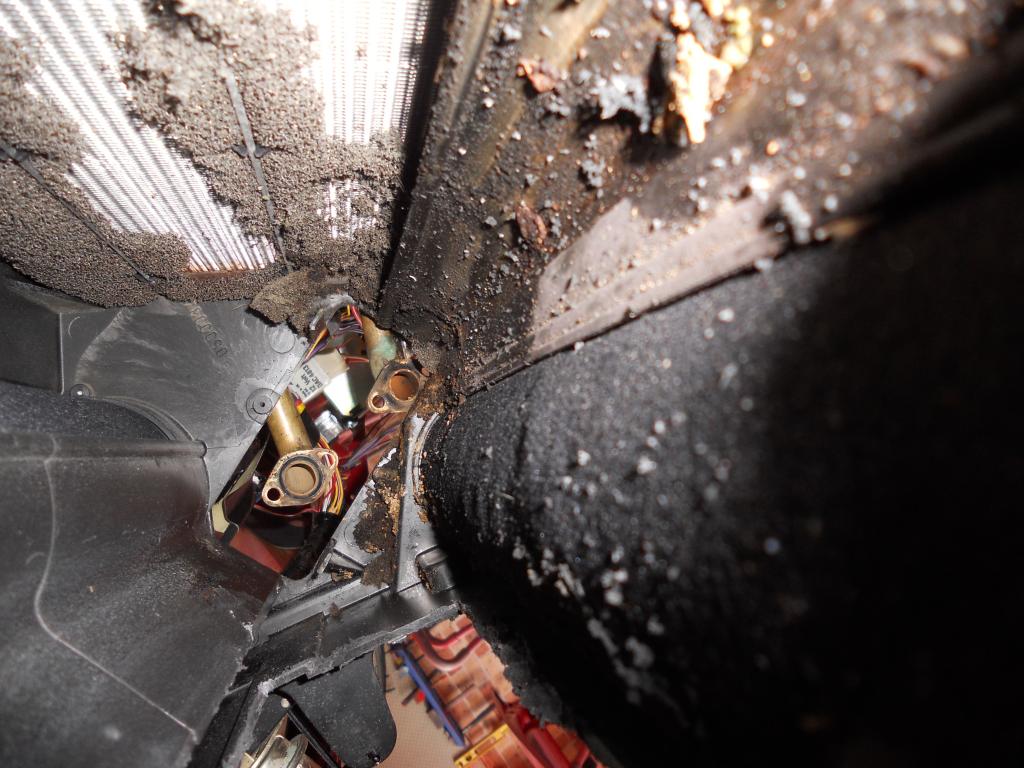

Rebuilding the AC - The heater core had leaked and all of the connectors were either of full of old coolant or welded together. Getting the heater core out in a RHD drive car requires the removal of the steering column. Although I did get old one out from the left I ended up damaging the fins with one of the heater pipes, not an issue this core is destined for the bin.
I replaced All of the connectors under the AC unit about 6 in total, hopefully this will fix my AC issues when it is functional.
New heater core ordered hopefully will arrive tomorrow
HMMMM me thinks this has been leaking somewhat
I ended up cutting hole in the front of the heater unit to allow access to clean the inside. I will patch this with a piece of plastic.

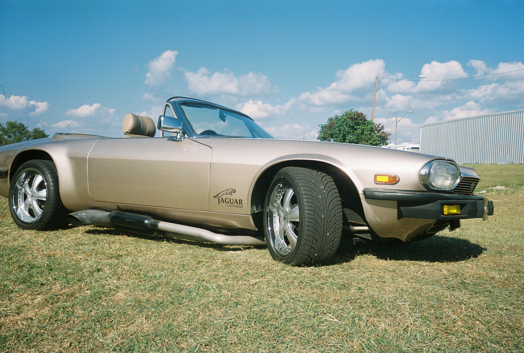

Well if you want to get radical about it...for my purpose built S that I raced eight years in SCCA I went to the good old english roller and fabricated the flares. Requires enlarging the wheel well body. see here: https://www.facebook.com/jon.frey.568?fref=ts
