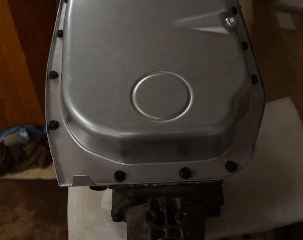

Warrjon, just as a matter of interest here are a couple of pics of case modification to 4L80e which enables it to fit standard transmission tunnel on '89 xjr-s. I was determined not to alter anything on the car that could not easily be undone.
This will be controlled via TCI ezy TCU. TCI says 12 cyl. is not supported but with the marrelli ignition as far as the controller is concerned it is in fact a six cylinder.

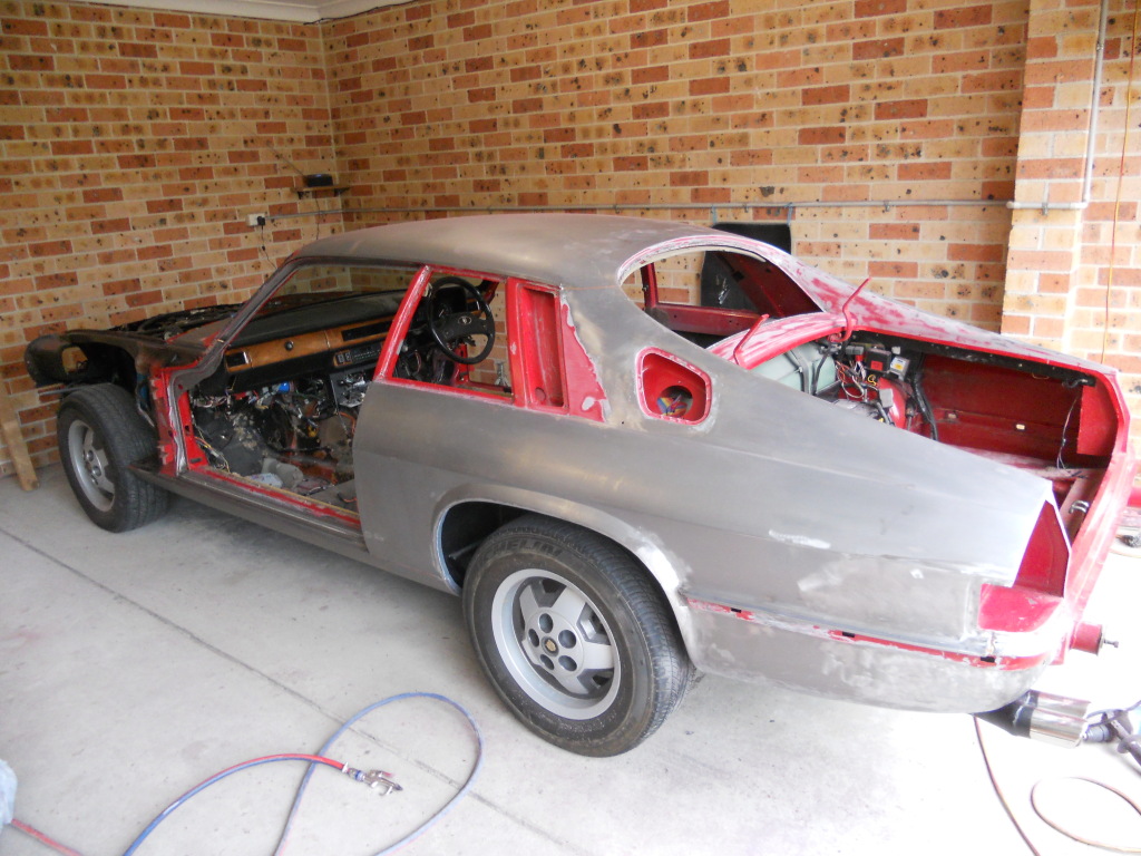

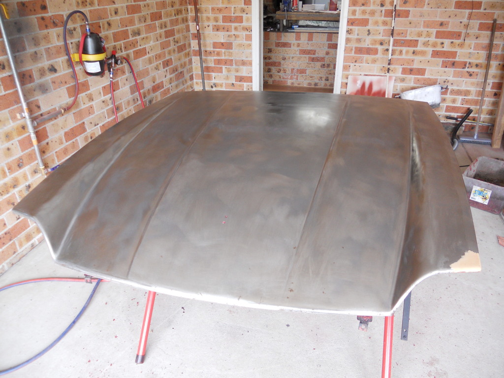

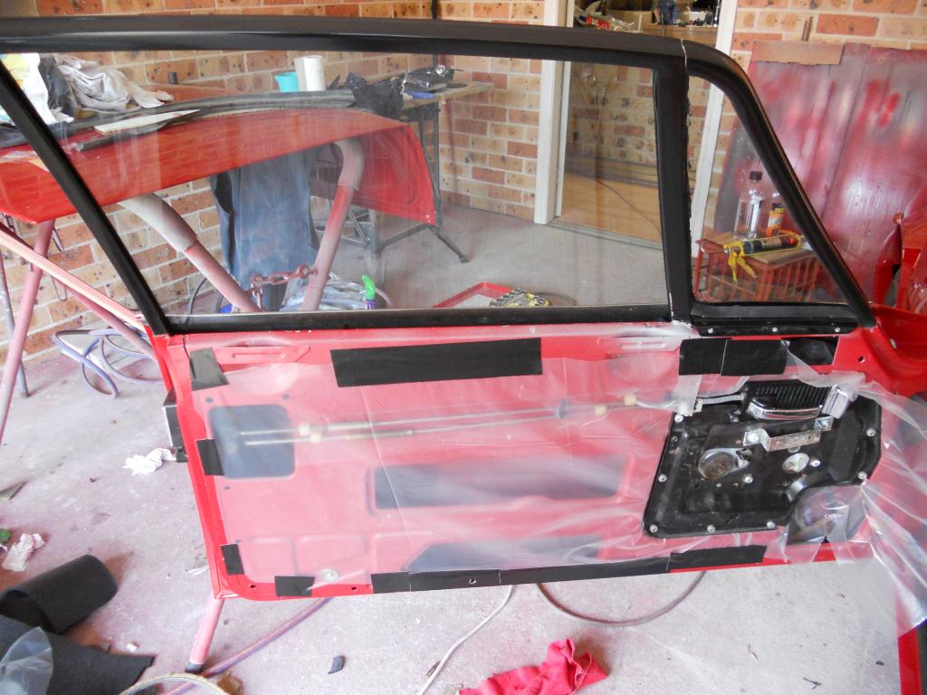

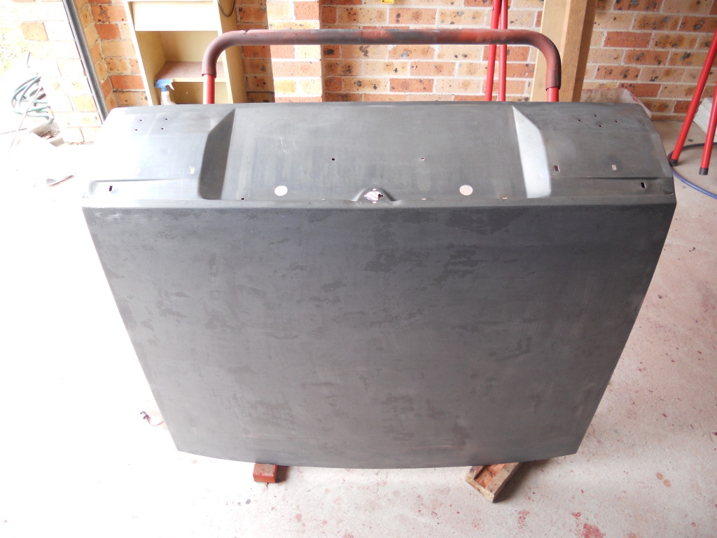

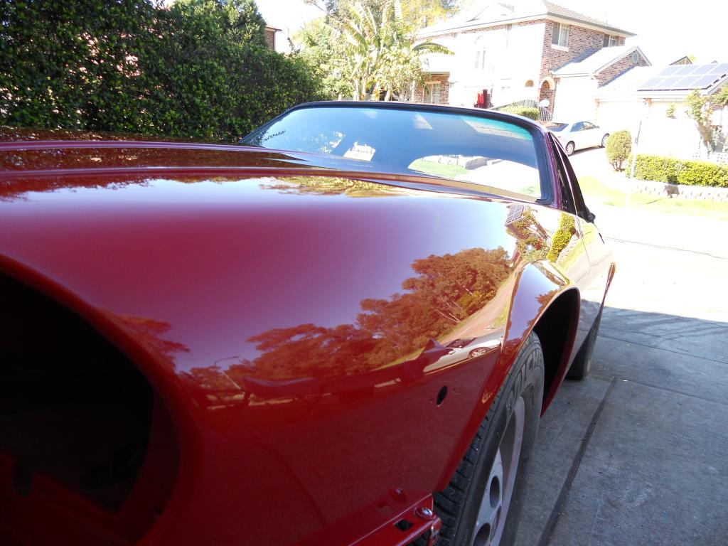

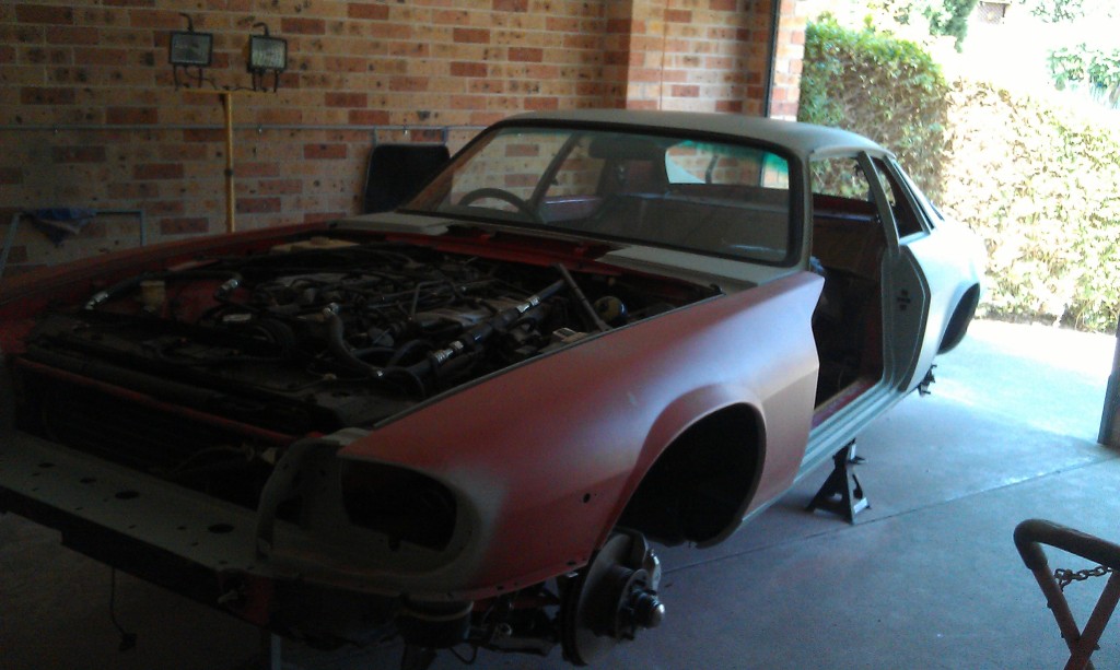

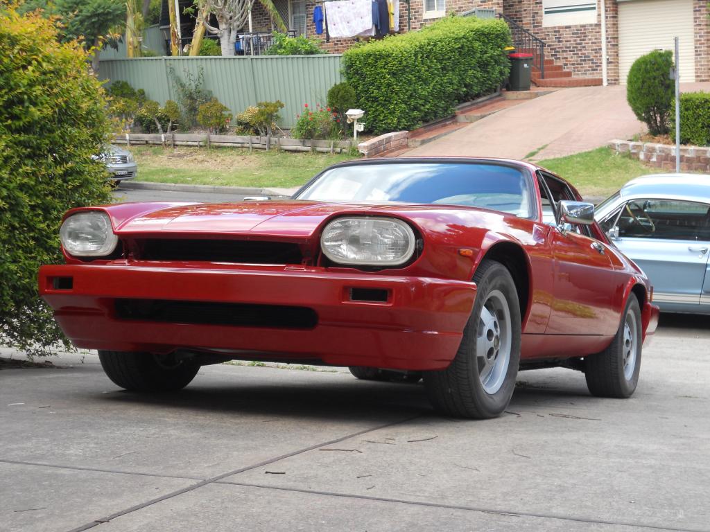

Car is finally painted. Wow it has taken me 12 months to get the body work satisfactory and shoot the colour and 4 coats of clear. All done in my garage. Very little body filler

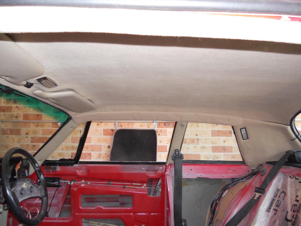

She id finally going back together, its been a long time but bits are no long coming off any more
Headlining didnt quite line up with the C pillar trim so I will have to make a trim fill piece luckily I some headlining material left over.
