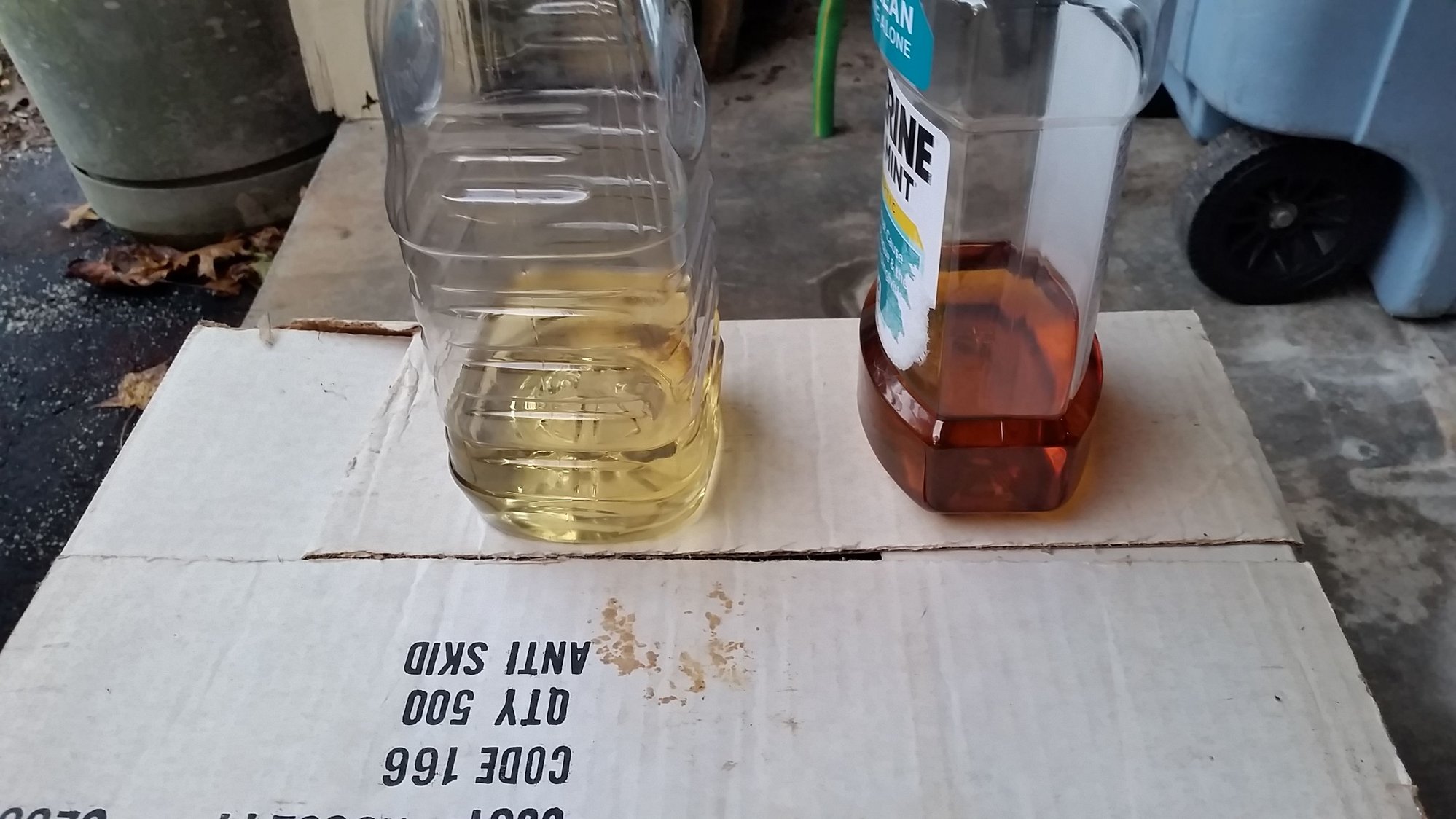

Worked to confirm fuel flow to rail. I think I initially burned out orignal fuel pump doing this. I drained all old fuel and put fresh premium in plus some stabilizer given this is taking long time. I'm only in Maryland a few days per month and tough to work in winter even though attached garage.
So replaced fuel pump, borrowed battery, put added fuel filter between sump and fuel pump based on suggestion from somewhere. Seems that should have been a standard before the Fuel Pump. Replaced standard primary fuel filter. I confirmed clean fuel downstream of primary fule filter (below Pump) adn then confirmed I have fuel to Rail.
