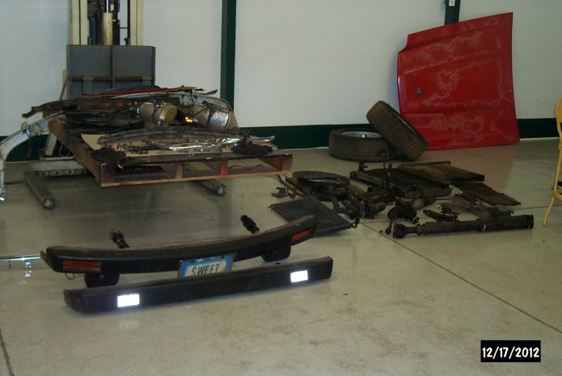

I just did them myself, here is the proof!
