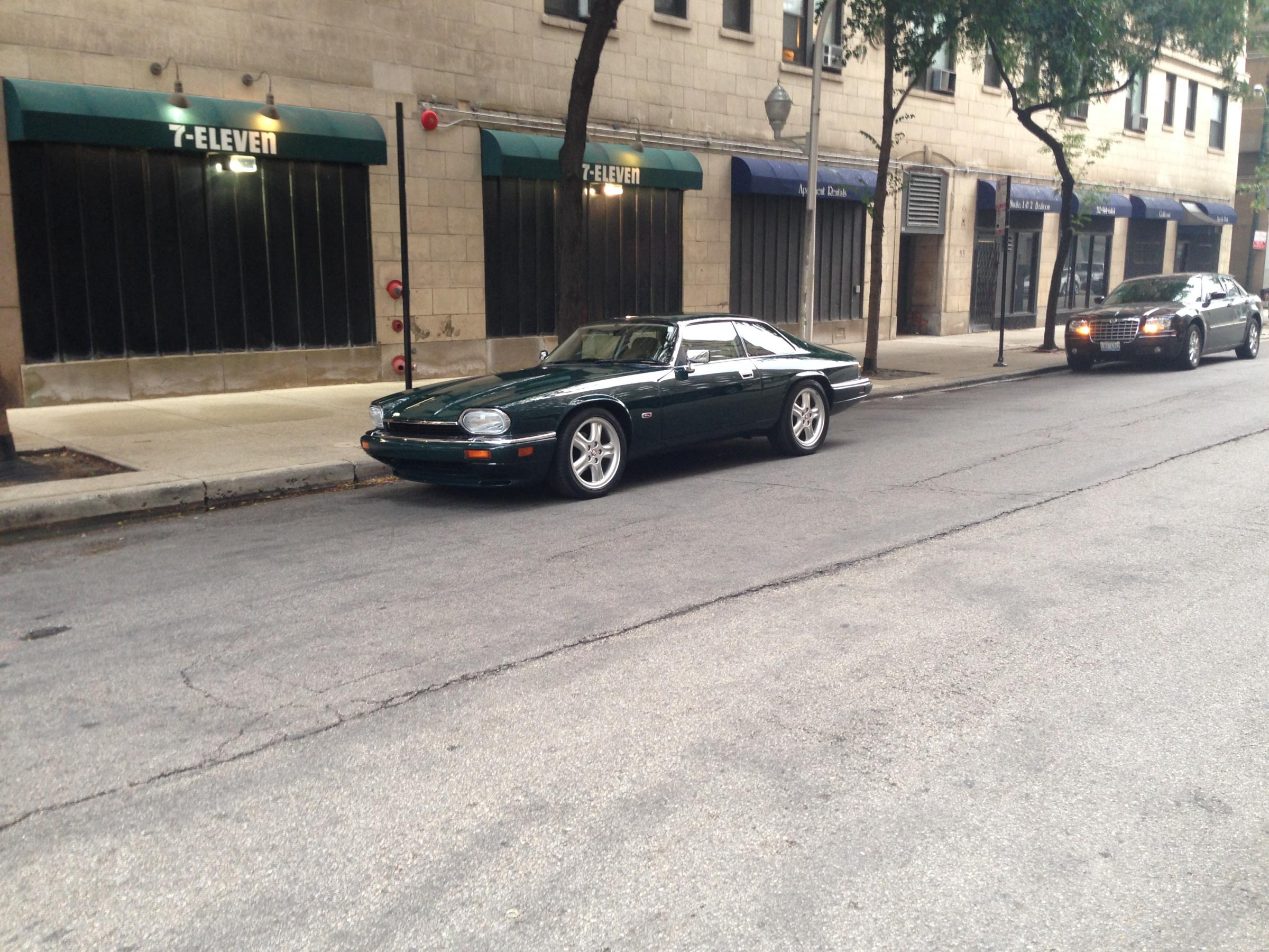

ajyiii's Avatar
Posts: 6
From: chicago
Default 95 XJS Wheels - 4.0
Here is my car with Penatas......
