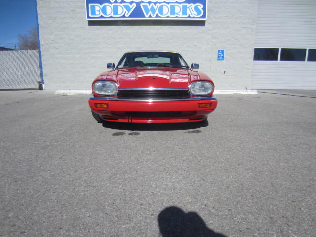

I recommend the OP drives both to see which one is the best fit. For my type of driving which is mainly edge of town driving from stop sign to 40mph or country roads cruising at 40 to 55mph, the AJ16 is a great fit.
I would think that if I mainly did freeway driving in a XJS then having the V12 would be nice but when I drove a V12 XJS from stop sign to stop sign I found the A/T to not be as responsive as my ZF is in my '95 AJ16. I would like to add for full disclosure that the XJS V12 I drove was a 5.3L 1991 so it may be that the later 6.0L version may feel more responsive off the line.
I do not get great gas mileage with the AJ16 again in mostly stop and go edge of town driving ( last time I checked it was around 17 to 20 mpg ) so I would imagine the V12 would be around 13 to 16 mpg in the same type of driving conditions.
After owning my first XJS for about 7 years now this is what I can say in a nutshell about the experience so far : The XJS has exceeded my expectations and continues to do so. I have been very pleased with the performance and reliability of the AJ16.
When I considered making one of my XJS' into a faster version I decided that was not what I enjoyed about the XJS so I bought a manual 6spd. Corvette to add to the stable. There is little to compare as far as speed and true sports car feel between the XJS and Corvette.
Both are 95's so I would say the Corvette is the best performance bargain and if you are looking for performance I would consider the vette. On the other hand if you are looking for GT smoothness and class I would look at the XJS in either the 6 or 12 version. If I had to get down to one I know I would keep the XJS because it is the car I like driving and riding in the best.
Best advice I can give is get the best XJS you can afford to start. Do not under estimate the cost to bring a tired version whether a 6 or 12 up to an acceptable standard. Like any high end vehicle just the cost to repaint or fix a worn interior can quickly clean out your reserve account. Good luck with your search OP and take your time because the right car is out there waiting for you.
Attached Thumbnails '95-'96 6 cylinder vs 12 cylinder-img_5486.jpg   '95-'96 6 cylinder vs 12 cylinder-img_5393.jpg
