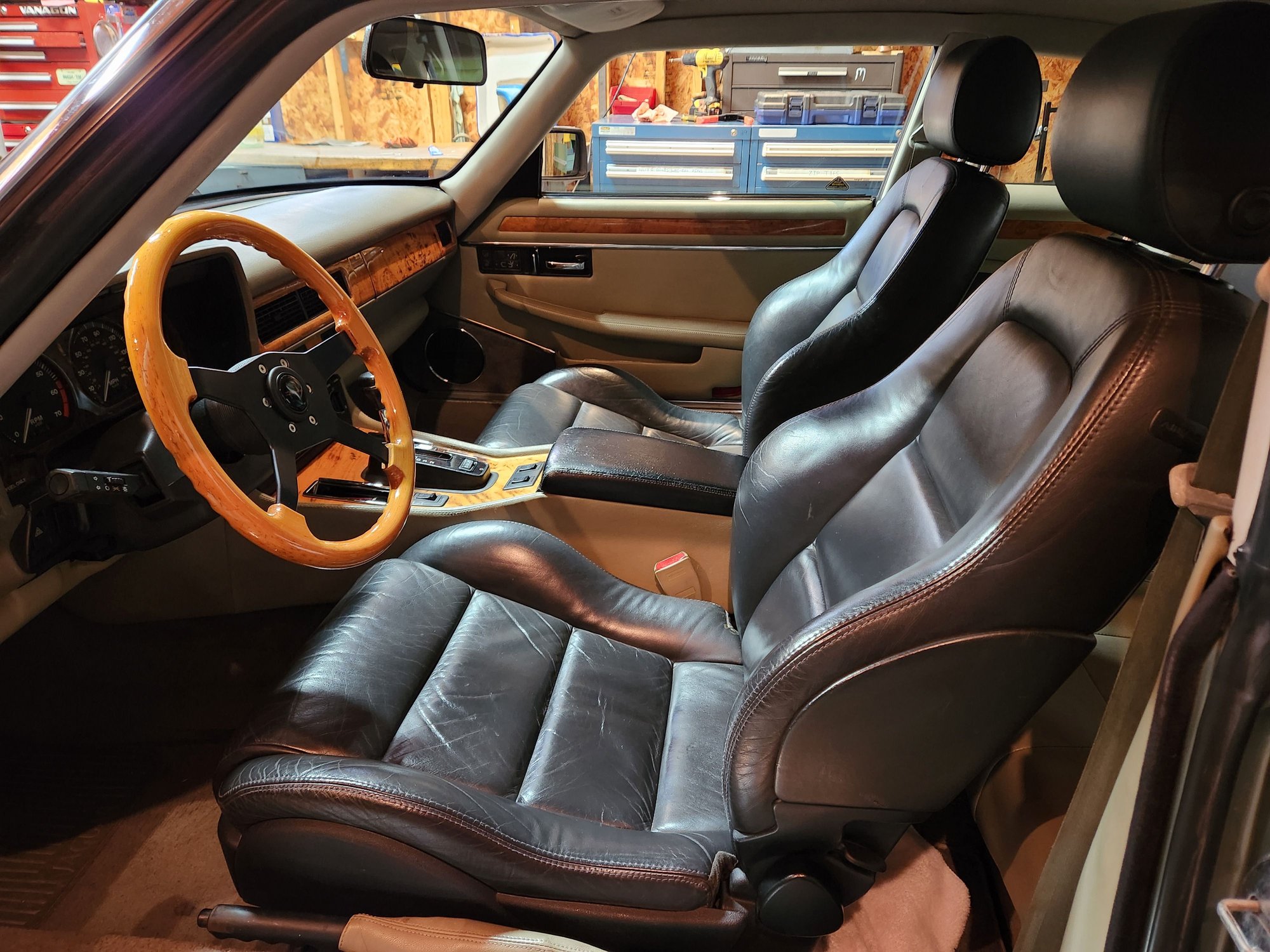

To follow up, all the parts arrived and bolted together nicely. I scribed a circle around the hub and cut the offending back collar off easily with a hack saw. Not the highest of precision, but it worked. The thing about the cheaper hub I bought is that the horn ring doesn't bolt to the backside of it... For anyone in the future reading this they may want to opt for the more expensive Momo hub that has the bolt holes for the horn ring. I think I'll just run a couple wires from the horn relay to a temporary button switch installed somewhere on the center console. The D shaped screw head that needs to be backed out to access the final nut holding the airbag in the wheel can be backed out with a needle nose pliers, so no special socket needed in my case. For anyone curious the seats are out of an Audi TT Mk1. Very easy swap. They don't bolt in, but you can add holes where they are needed easily. All manual adjust. They do sit a little taller than the stock seats, so tall folk be warned. ! I'm 5'10" and I just fit. Adjustable head restraints, glorious!
