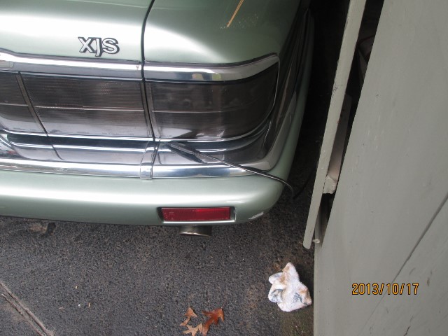

When I park my Jag I plug in the maintainer. This car seems to always need a little top-me-off when I park it. I wired the plug to come out at the right rear corner of the boot just above the bumper. The small hole is under the boot lid and only shows about 1.5 inches of the wire and plug. RTV holds it in place and prevents water from getting in. Very convenient and unplugs itself if I forget it. I also cover the old girl at all times because I have a Beagle that likes to get on our cars. Only way to keep the little dog alive. lol

I will try to send a couple of pics. I have difficulty doing that on this website. Something to do with the file being too large. My camera is a 16 mp digital. The web page asks me for a url of my image. I do not see a browse option. Can some of you help?

Default adding a second battery
This the lead coming out of my boot to the maintainer.

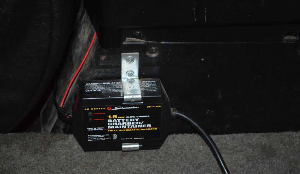

When I bought mine, last month, it came with this already installed.
Jim
