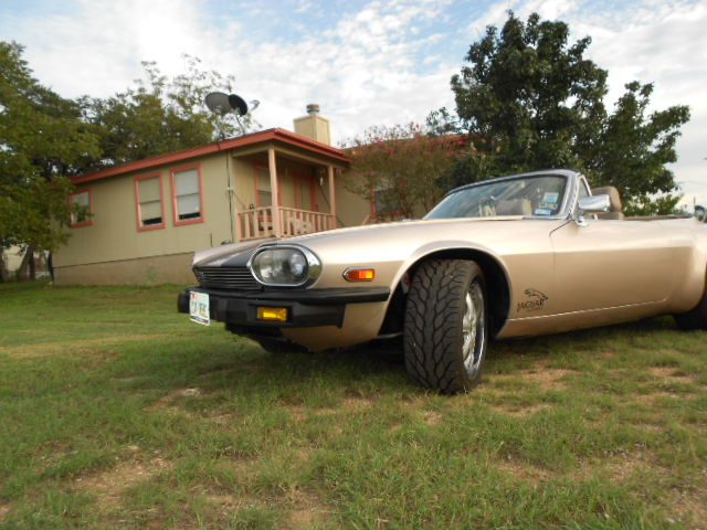

doug is correct, i had to machine my center hole larger , used a vertical milling machine!
just have to be carefull, or check a reputable shop to do it

warrjon is correct, the amount removed is small .
the pic on post #3 ,i'm setting up a dial indicator to measure runout and wobble.
all was less than .005 thou. both ways!
you cannot get new tires that close,both ways, at least i couldnt.
pic of tires mounted, Yeah, probably overkill sizes.
