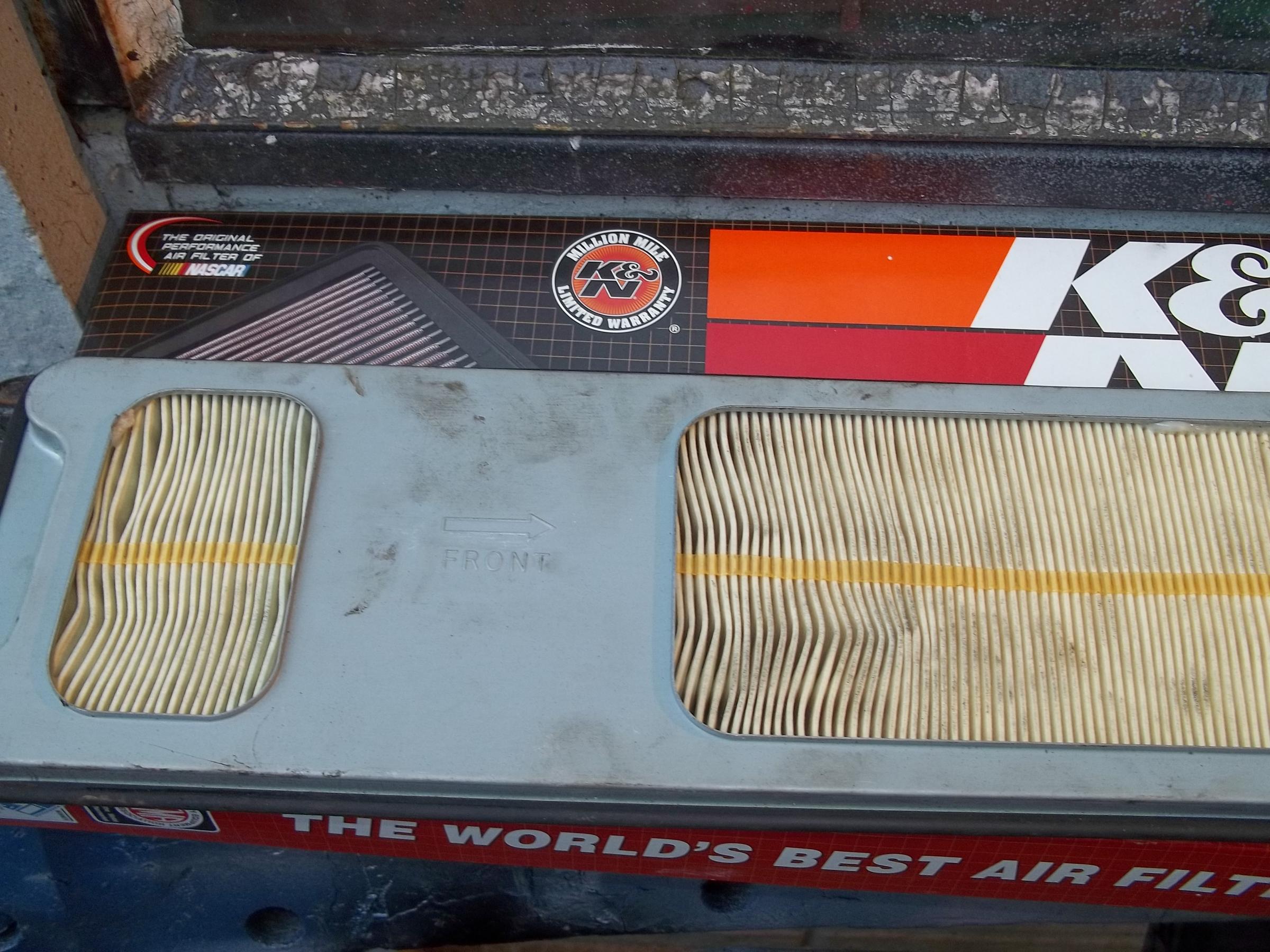

when you say mounting plate holes do you mean this

No, the ones on the actual filters themselves.
The original filters had 2 evenly sized rectangular cut outs on the base; the new ones have one large rectangular cut out and one smaller square cut out. There is an arrow on the base labelled 'Front' which places the small cutout opposite the throttle intakes so I was wondering why there was a difference and whether the smaller cutout would affect the flow or not.

I have just checked my previous filters and they are what you are describing. so I wouldn't worry about that, I bet its the pipe your sorting
The air filters with the evenly spaced openings are for non-abs equipped cars, the non-evening spaced openings are for the abs equipped cars. They are designed so the metal area is over the throttle body.
That shouldn't be a big deal and sap the power.
