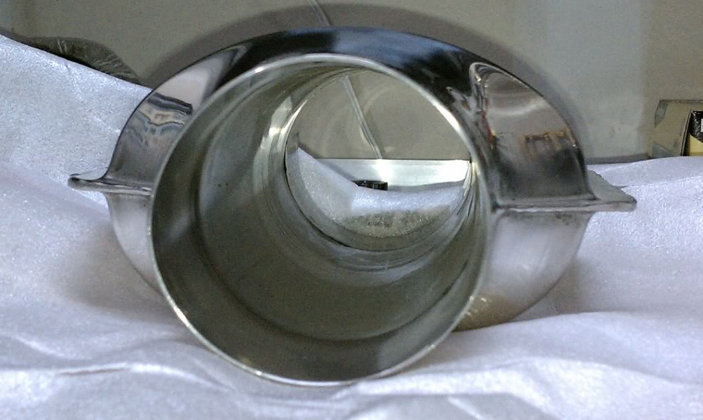

you can cut the air horns off with a saws-all.
once youve done the other modifications, such as Jetlag has, you will see a significant difference. 20+ year old converters are not gonna flow very well. certain aftermarket converters arent good either, such as Flowmaster high flow converters, which have NO bottom end torque to speak of. since the engine is basically a huge air pump capable of displacing ~600 cubic feey per minute, that means that if you cant get air out of the exhaust quick enough, you could supercharge that engine and not see any gains, let alone a cold air intake system. such was the case with my last engine swap.
air rails, smog, etc are gonna choke things up as well. (edited for greg)
once youve done these mods, you can advance your ignition timing a few degrees for even more power.
Heres the highest flowing cat that money can buy, from frozen boost.

High Flow Cat

The air pump and air rails have nothing to do with combustion. It does not raise mixture temps as you say. It puts air into the exhaust stream to light off the catalytic converters faster. This only happens for a short time. The air pump turns all the time so there is a slight drag on the engine. This is why new vehicles use an electric pump for secondary air.
BTW your high flow "converter" is nothing more than a device to fool the visual inspection done in some states. 3 inch is way too big for this engine. Read Roger Bywaters site for some info on exhaust.

Originally Posted by Greg Edge
@M90
LOL. like i really needed you to tell me that it wasnt a real converter
which is why they make it in 2", 2.25", 2.5", 2.75", & 3".
