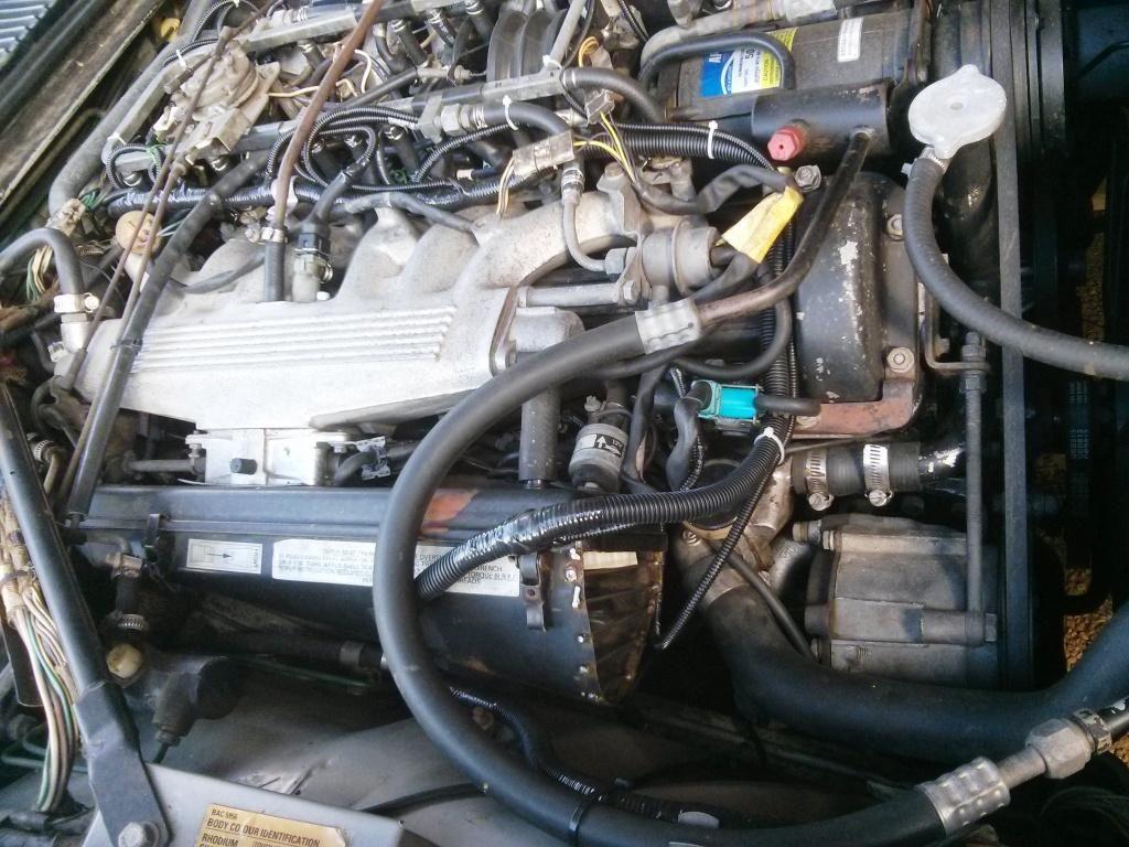

I had a slightly different reasoning for removing the air pump and rails. There are no regulations in my state for a car that old (83) and I wanted to clean up the engine bay to make it easier to work on. I also removed the A/C and the cruise control.
I can now change spark plugs in about 10 minutes.

Just drill a hole somewhere in the body of the box and mount the IATS with a nut. Take the sensor to the nut & bolt aisle with you. I think it was a 10mm thread but not sure.
I rewired and mounted mine way back by the intake to the AAV to ensure good airflow, but I doubt that's really necessary, I'm sure anywhere on the box is fine.

I took the passenger side air intake off. Gonna take the driver side horn off once I get the nut I need for the temp sensor to be moved. Can't wait to see if I get at least a little purr out of my kitty.
