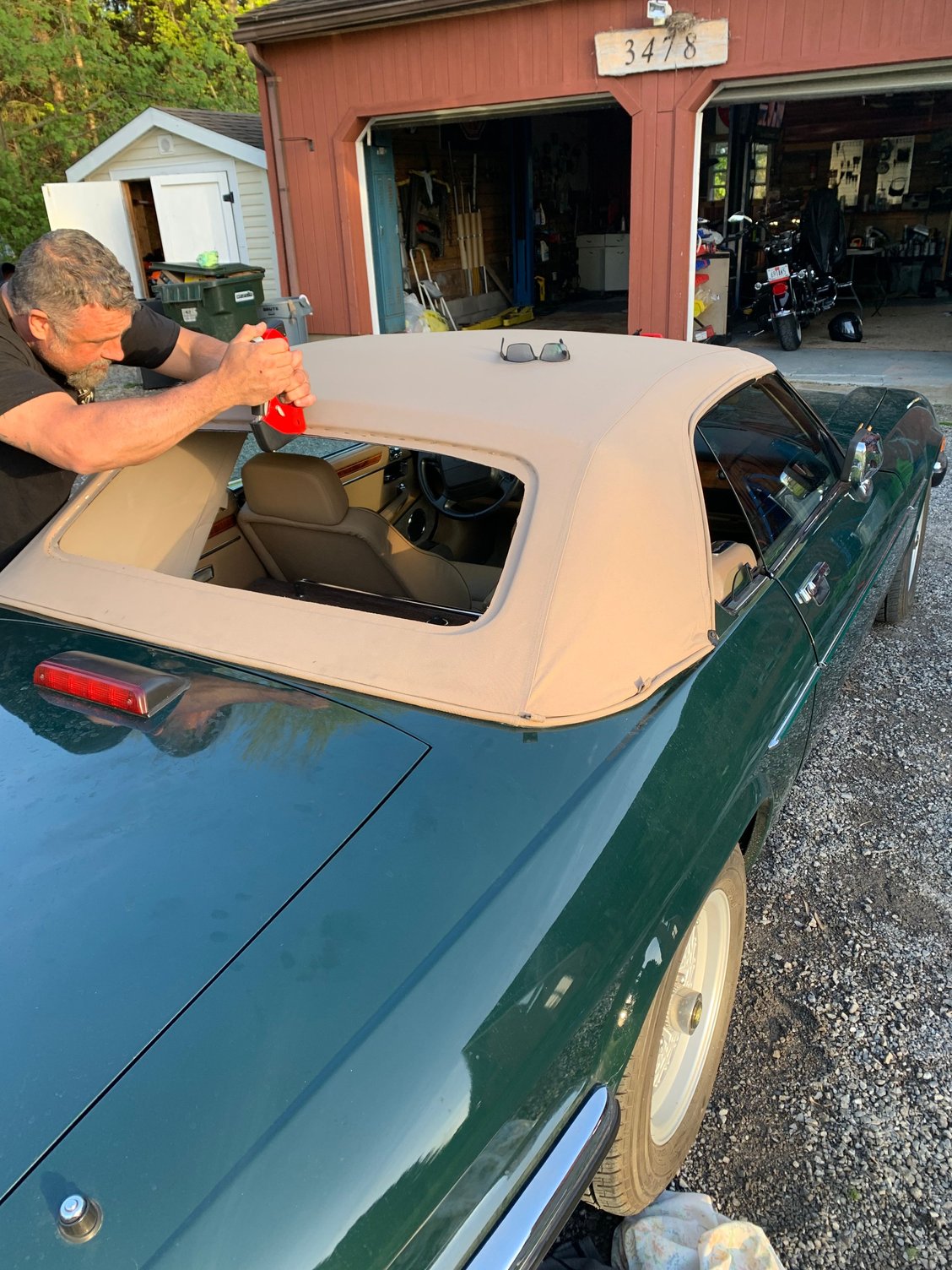

some tips for future people who can’t afford to have a pro do it It’s not the kinda job I enjoy.
-if you buy tan, tape off any canvas near work areas. Every bit of grime attracts to it. Even when you check your hands and they look clean. They are not
- if you’re struggling to get the rear wire tight and under the lip get the top wet, it helps to lubricate

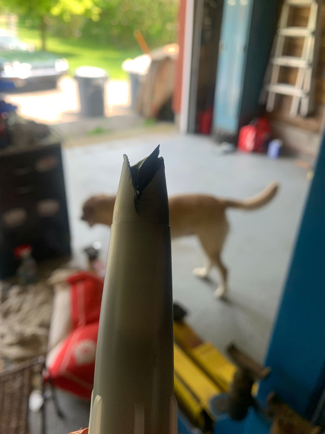

-we used a small eye bolt and dead blow hammer to pursued it under. Once wet it worked perfectly and eliminated the risk of an accidental puncture

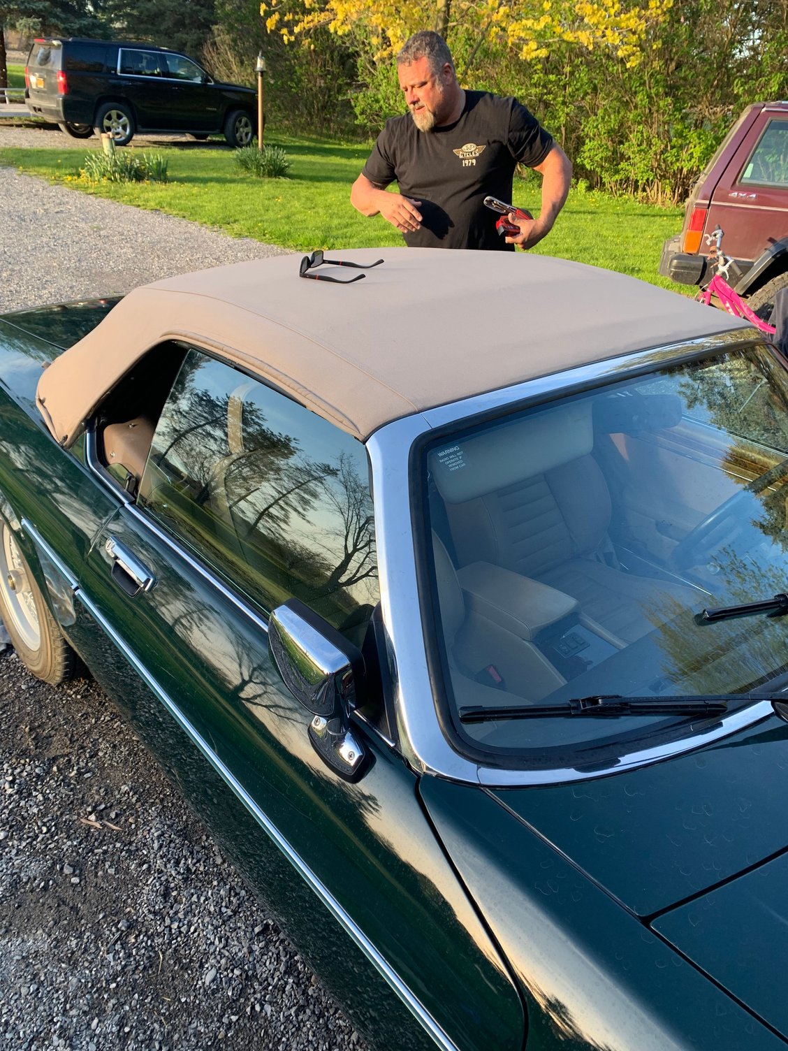

​​​​-we could not get the top closed even after days of stretching. Once we cut about a 12” slice in the center window area it relieved plenty of tension to work successfully.
-Ryobi electric stapler did not appear to have enough clearance to put the staples in. From the front to where the staples depart was cutting it too close. Ended up doing with a traditional stapler. We ground off some metal to give it a tight fit and eliminate the potential of shooting to high and into visible canvas.
all that’s left is sealing the window in it. Have to order a 26:1 high thrust caulk gun. The adhesive comes in steel tubes. Definitely not traditional silicone caulk

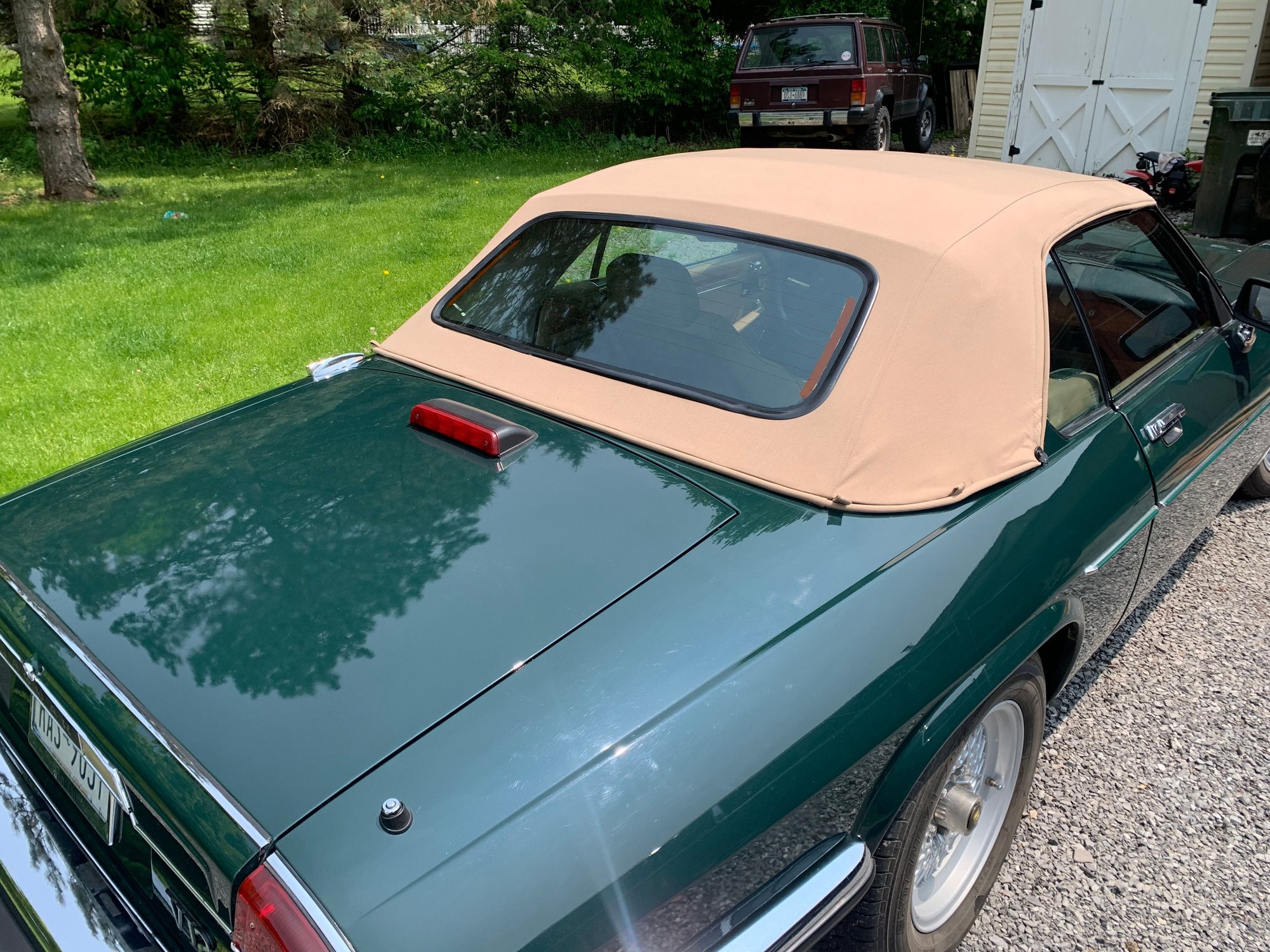

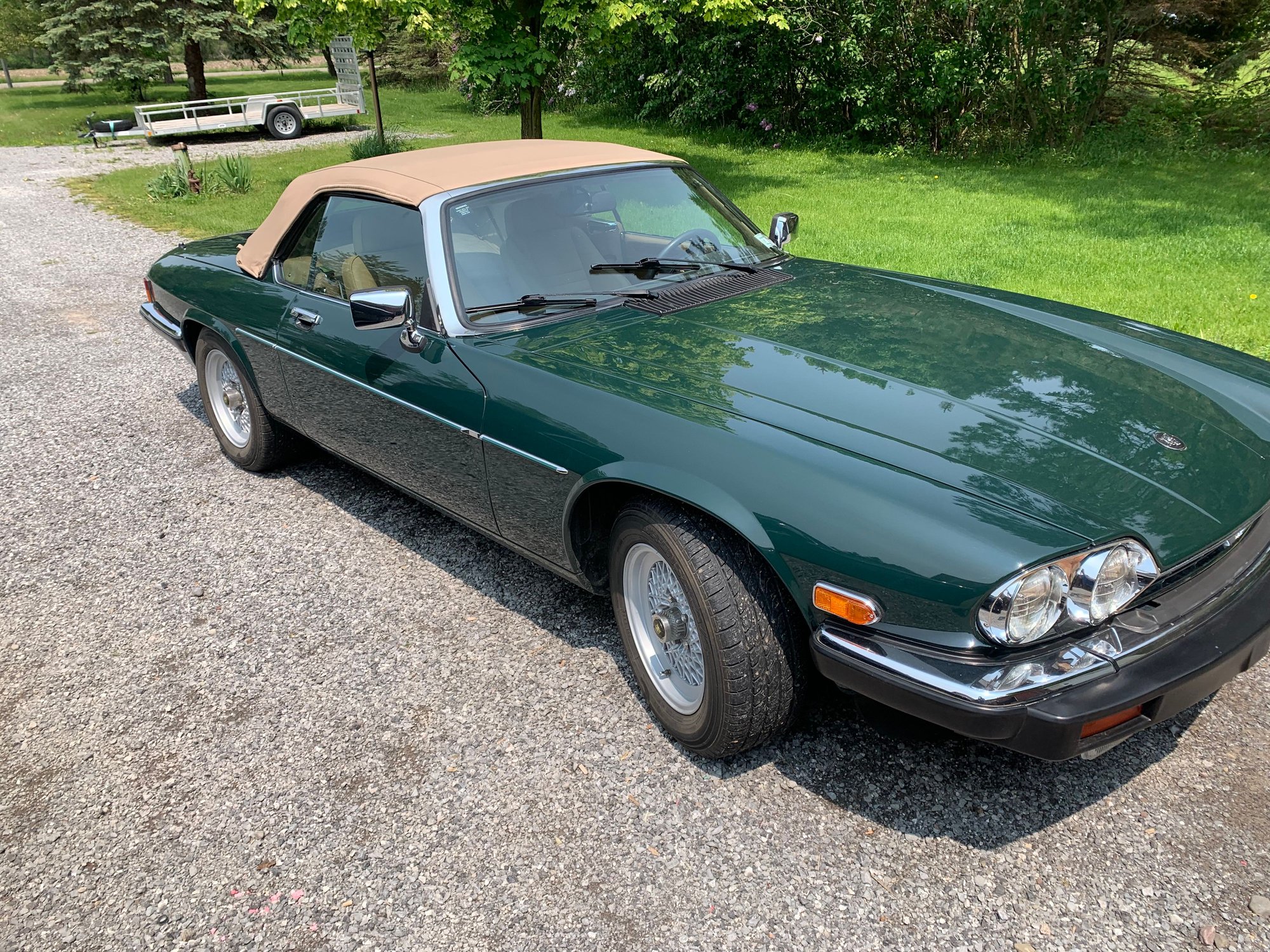

Well officially finished. Last couple tips:
-Run a pretty narrow bead. The pre-market tip notch lays a pretty thick bead. I followed the interior of the frame, thankfully, but I got overflow. Id rather have excess in the inside of the car cause it’s easier to clean off glass than canvas. Id say a pro probably runs a narrow bead just off the frame lip.
- if you get excess where the molding goes in your in trouble. Had that happen on one corner and getting the molding in required a dental pick to clear it out. I’d probably wait till it dries if it happens otherwise keeping the canvas clean is difficult.
-we waited about 45 minutes to install the molding. I’m glad we didn’t wait longer cause there was still enough play to move the window slightly enough to equalize the distance between the frame and window. Having an equal gap is necessary for the molding to fit in.
