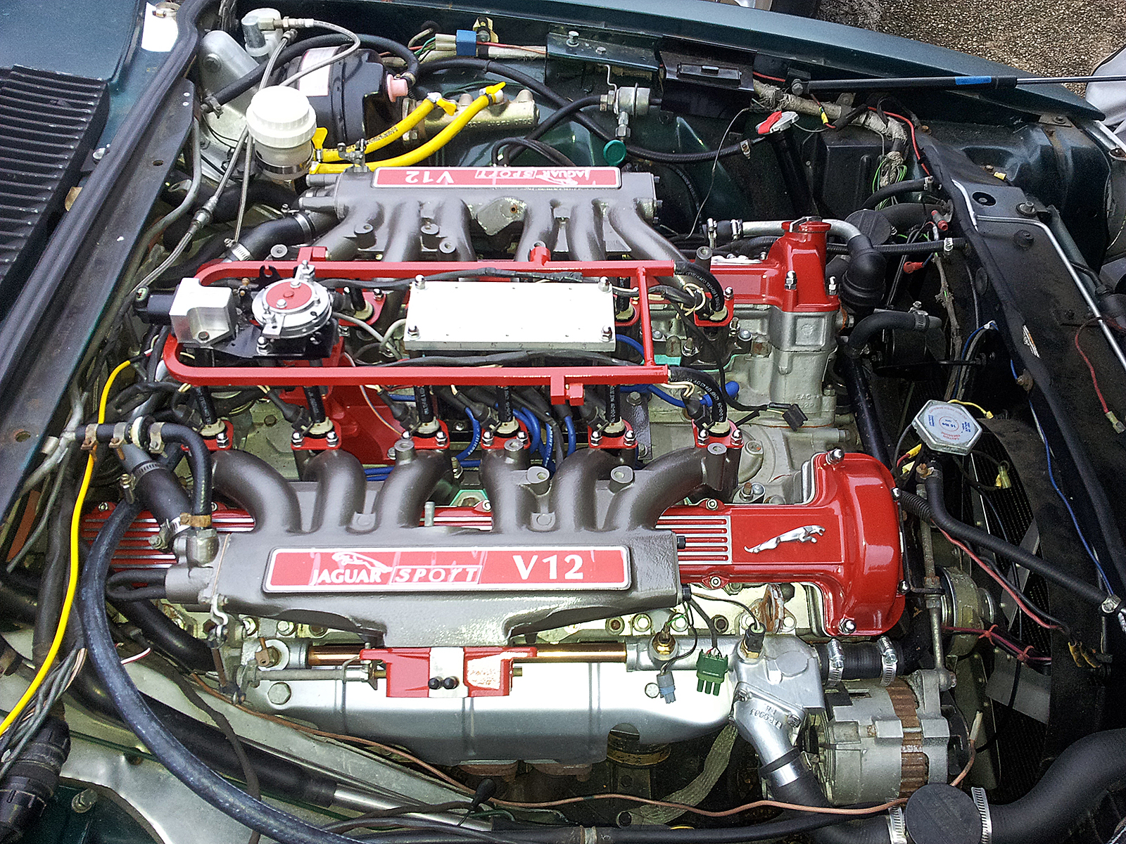

I can't help you with relocating the stock alternator, because I put a 180 amp GM unit where the air pump used to be. However, I did replace the stock A/C compressor with a smaller Sanden unit, and I put it where the original alternator used to be.
You can see the arrangement in this photo
(CLICK PHOTOS TO MAKE THEM MUCH LARGER)
And the effect it has on engine bay appearance in this photo
I had to fab up a bracket in order to put them both where they are. I have not yet fired up the motor, nor plumbed & wired the compressor. I may find that I need to add an idler pulley in order to increase the belt contact area on the compressor pulley.

Thanks for the replies gentlemen, Scott I do like were you have put the AC pump, makes for a very neat valley indeed and easy to work on.
As far as the AC pump goes what model did you use? sandan make a few different sorts.
Ill have to see how the original alternator is bracketed up, just seems like a waste when you have two fully functioning one's not to use them first.
A little of topic what ignition system do you have running? the big toothed cog in the first pic gives it away.

The compressor is a Sanden SE5 which takes R-134 refrigerant, and has a V-belt pulley (most of the SE5s I found have the serpentine pulleys). I bought it new on ebay a few years ago for this installation. Sorry, I didn't think to shoot photos of the mount when I made it, but, it's just a simple arrangement made out of angle iron. It bolts to the front and side of the engine block for a secure anchor. It has one mount on top for the alternator (a pivot point so that the alternator acts as the tensioner for that belt), and two mounts on the lower portion for the A/C compressor. The mount runs back along the side of the engine block, the full length of the compressor, in order to provide solid mounting points at the front and back of the compressor. The compressor simply slips in between those mounting points, and is held in place by long bolts running front to back, with locking nuts at the end.
The trigger wheel is part of my Electromotive TEC-1 engine management system (controls fuel and ignition). If you take a second look at the engine bay photo, you will also notice the 2 coil packs stacked atop each other, where the distributor used to be, in the Vee (the top coil pack is inverted, so that the aluminum base is what you notice). I have a buddy who is going to make a custom panel which will cover that coil pack base, and visually tie it in with the rest of the motor. Also, if you look directly behind the throttle pedestal, you will notice an odd-shaped aluminum block. It houses the Electromotive fast idle valve body.
The link BigD posted is definitely worth a look. That car belongs to Ian Hissey. I've corresponded with him in the past, and I've admired his XJS work for many years.
