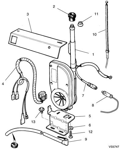

The rubber seal on my antenna rotted and I bought a new one. Any advice on how to install it? It seems like I might need to take the antenna off first.

Did it in the spring. Yes, remove the entire power antenna assembly (one or two hex-head screws at the bottom bracket). Then you'll have access to the grommet. Check to ensure the drain pipe (#9 in the photo) is attached when you have it all back together.
