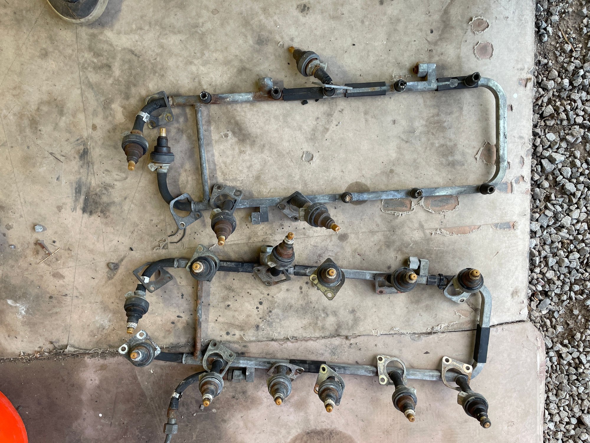

2 of the barbs on mine are damaged.
Looking for a NOS or like new used.
there appear to be a few versions of this fuel rail so not all will do, needs to be compatible with EAC7900

FYI, if you have a butane heater soldering iron, the blade-type tip will burn through the old hose very easily indeed, and ensure the barbs remain completely untouched. eg:

I agree, heat is the way to go removing hardened original hoses.
unfortunately, the damage to mine was due to a ham-handed mechanic that replaced the lines a few years ago.
looks like he used a rotary disk to remove the hoses. The damage was hidden under the hose.
