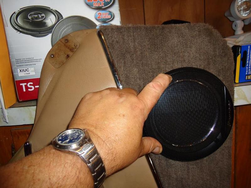

I finished an audio upgrade on my '89 XJS Convertible, first by installing a pair of Pioneer 6.5" in the rear cubby box, in existing box holes, and making the grill hole an inch bigger for the Pioneer grills. Before installing the speakers, I slid a 12" square piece of pink insulation between the wood box and the exterior carpet clad panel, to isolate the sound between the speakers. It added a great dimension to the existing Jag deck, and when I changed out the door speakers for a matching Pioneer set of 6.5's, it truly made the sound, however I really wanted the CD, MP3 and USB stick options of the Pioneer unit. That, plus all my old cassettes were very 80's. While I had the door panels off, I noticed a sweet square hole at the upper front of the door, perfect for a 4" speaker, and possibly using the original Jag grills. Just last week, I bought a set of 4" round speakers, and will be mounting these in the front holes where the door turns in near the dash, but still leaving a space between the two for audio projection.
I've attached a photo of the upper hole suitable for a smaller speaker, and the new 6.5" grill laid over the original Jag grill.
Attached Thumbnails Audio Upgrade Question-jag-door-holes-speakers.jpg   Audio Upgrade Question-jag-new-grille-dry-fit.jpg

Great thoughts and thanks for the pics! I wonder if my '94 would have a similar void in the door? I guess I will have to actually start the process!
