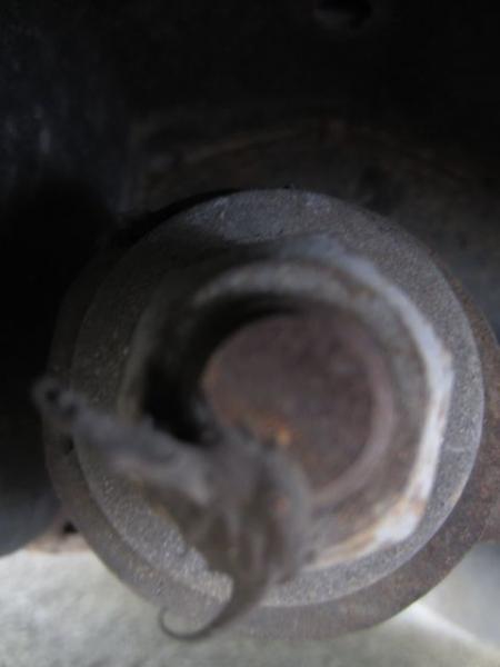

Old Nov 10, 2012 | 02:15 PM
Vee's Avatar
Vee
Posts: 5,340
Likes: 1,746
From: Arlington, VA
Here's a pic. See how the lower side is thicker than the upper?

Old Nov 10, 2012 | 03:50 PM
Doug's Avatar
Posts: 25,525
Likes: 11,716
From: Pacific Northwest USA
Originally Posted by Vee
I'm in for a lot of work...
Yes, you are :-)
As suspension work goes the ball joints and upper bushings are not biall that bad. Easier than many other cars, actually. But the lower bushings are labor intensive no matter how you slice it.
I believe I may have to drop the steering rack to get to those, won't I?
Yeah, to allow the big bolts/shafts to to pushed out, rearward.

Old Nov 11, 2012 | 01:27 AM
Greg in France's Avatar
Posts: 14,576
Likes: 10,772
From: France
That one looks about perfect. If they are all like that, and no broken bits of rubber poking out of the ends, then they look fine to me.
If you do decide to do the lowers, the entire front subframe has to be lowered at the rear (and the engine supported across the top of the wings by a bar, and the steering and engine mounts disconected, before the lower fulcrum pins can be driven out rearwards (if they will come out), as otherwise they foul the sump on coming out. A very great deal more work and hard to do without proper tools and a good ramp or lift.
If there is no undue play in th wheelbearings and stub axles, then just check the camber and castor and do the top bushes and ball joints and track rods, is what I would do at this stage.
