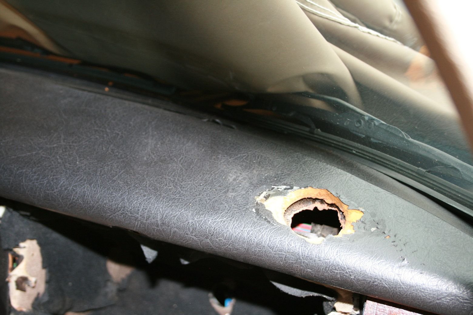

Reasonably presentable, but the paint is a bit weathered and chipped. The interior is intact and not terrible, but the wood is a mess, as are the seats. Always one to get ahead of myself, I found some newer seats I plan to adapt, as well as a set of 16" 5-spoke rims. When I bought her, she ran just well enough to get on and off the trailer. You had to play at it to get her to run, and had to feather the gas quite a bit to get her to rev at all. I found receipts for a new fuel pump and a replacement rack and pinion, but not much for service records. The brake reservoir was dry (can still get a little braking), as was the power steering pump, so I suspect the rack was leaking and replaced with another leaking unit. One of the many mysteries to unfold; I'm hoping it's possible to disassemble that and reseal it myself. It was easy enough on the 931, but then that's a manual rack. The cooling system is a mess. Hopefully it hasn't been overheated, but it started dribbling coolant out one of the radiator hoses after idling a few minutes. Everything rubber under the hood needs to be replaced, I expect - although somebody's done some work on the fuel injection, because the rubber lines to the injectors, along with a few others, have been replaced. The oil looks clean, but there was some milkshake-looking gunk in the right air cleaner box. I ran it a couple times last summer, poking around at things, but then later in the year couldn't get her to start anymore, and I haven't bothered trying this year. Something's definitely amiss there, so I need to get to the bottom of that, and I can't run it long enough to bring it up to temperature anyway.
So here's the engine as it sits. I pulled out my smoker today, figuring I've got some vacuum leaks. As bad as the hoses looked, there was only one place it was obviously pouring out - the distributor. There's a vacuum line to the cap that seemed to be the source (not the line to the advance diaphragm); seems like a strange thing to have engine vacuum ported to, but I'm probably missing something. Next I hooked up a fuel pressure gauge. Since I'm going to be replacing the lines anyway, I cut and T'd off the line on the right side (as you face forward; passenger's side in the US) of the engine bay. I think I've found a problem there: I was getting about 45 PSI, where it seems 30 is what I should be seeing... I don't have much for reference material on that yet though; I'm just going off internet sources. The gas didn't seem that bad when I got it, but it has turned to nasty yellow with something of an off smell now, so I'll drain that and put fresh gas in for sure before I try to fire it again. The next thing I was going to check is the throttle position sensor, but I might just focus on the fuel pressure issues first.
Probably the biggest issue, as I've already hit on, is the cooling. So I plan to have the radiator professionally serviced (there is a good shop; I did that on the 931, and been happy with it), flush everything out, and replace every hose on it. Unfortunately, I'll probably have to cheap out and just throw generic hoses on it; I don't know if I can justify what OE pieces would cost, assuming they're still available. I imagine I might have to get creative on some, but I've found you can make your own hoses by selecting from Gates hose catalog and splicing using couplers and heat-shrink clamps. We'll see how that goes, but I doubt I can trust any hose that's on it. I can't see anything wrong with the water pump, but I'm not sure I'd trust that either; it doesn't seem like something easy to get though. I'm eyeing the fans, and reading that a fan off a 90's Taurus makes a pretty good retrofit for a lot of things. I'm going to look into that, but I wonder if an alternator upgrade would be wise if I went that way. Next is all the vacuum lines and such, obviously. Brakes are something I'm not taking any chances on either: I'll be replacing the flex lines, and probably fixing a leaky caliper or two... Then a full fluid change - obviously that's a given with the cooling system and brake work, but I plan to do the transmission and rear end too. I'm curious if u-joints are something to worry about - seems like the kind of thing nobody touches until something breaks. Of course that brings us to the suspension... I've already done a little digging on that can of worms; I'm just hoping it's intact enough that I can get it running and drive it a bit before I have to address all the almost-as-old-as-me rubber bits in there.
Anyway, I know I'm in for a furball of issues to address. I'll have to do a compression check before I throw a bunch of money at parts. Fortunately, I didn't hear any knocking or other mechanical noises when I had it running, but you never know. Ultimately, I'm just trying to save a very cool, solid survivor (no rust to speak of; usually not a problem here, and it originated in California), and pass it on when somebody makes me the right offer. I've already got a white 560SEC I've invested heavily in; they've quite different in a way, but practically, quite similar. Hard to justify keeping both indefinitely. Values are hopelessly lopsided relative to what a spectacular car this is, so I'm ruling out a paint job, all-new interior, or any significant modifications. Obviously, I've mentioned a few upgrades and alterations; I don't plan to be a purist on this one, but I'm not going to desecrate it by swapping an LS or anything. In part, I bought it because I've never owned anything British (and I'm a bit of an Anglophile) or a V12. There's no sense trying to make a really fast car out of it - I just want adequate power and that smooth, turbine-like V12 feel. I've always been mechanically inclined, and been tinkering most of my 40-ish years, so this isn't my first rodeo... Just my first British one. And I want this to be a car I can take somewhere, not one that I can get going just enough for a little weekend cruising. So, I'll gladly take any advice on what in particular is likely to need attention, what are the pitfalls, and of course, where I can save a little money. As the market sits, I figure I'm halfway doing charity work, but some day cars like this will be worth something - as soon as people realize how soulless new cars are, and that they can't build something that even LOOKS classic no matter how they might try (and I don't expect that). Obviously, don't get me started on the state of car makers (including - maybe especially, Jaguar) these days!
