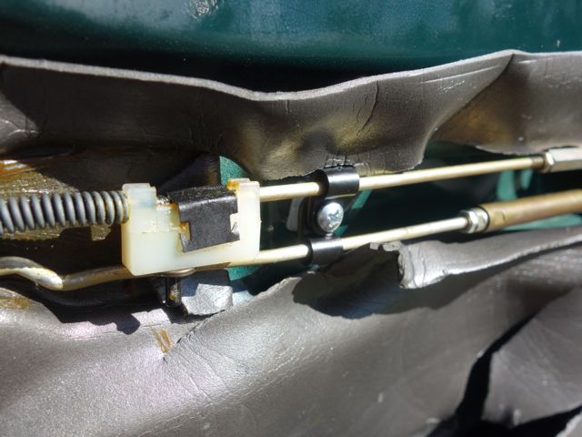

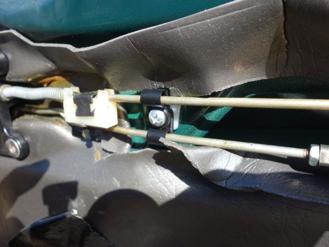

I was investigating a problem I was having with a door latch not wanting to snap back and along the way I noticed I had a broken clip BEC9538 NOT holding one of the two rods across the door.
I ended up buying to parts to make this work:
(1) Dorman 785-112 License Hardware Kit with #8x1/2" screws. The plastic square anchor fit into the square hole and then I hung two 3/16" nylon cable clamps from (2) Dorman 86108 Nylon Cable Clamp Assortment.
Both purchased at Advance Auto.
I am attaching a photo to show you how it works. Seems to work perfectly. I think the 1/4" clamps could work, but the 1/8" will not.
Attached Thumbnails BEC9538 Door Lock Clip Workaround-dsc00200.jpg   BEC9538 Door Lock Clip Workaround-dsc00201.jpg
