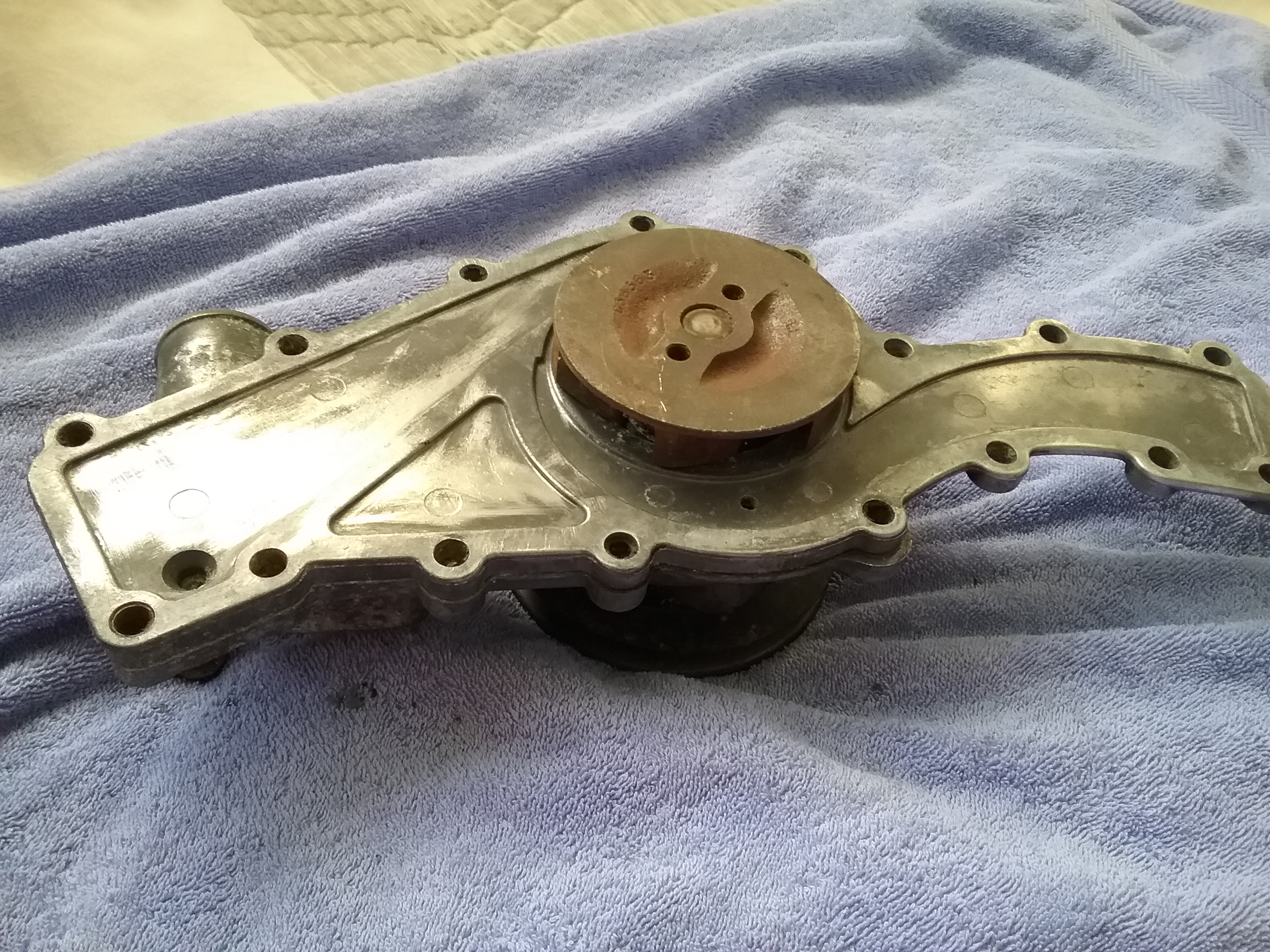

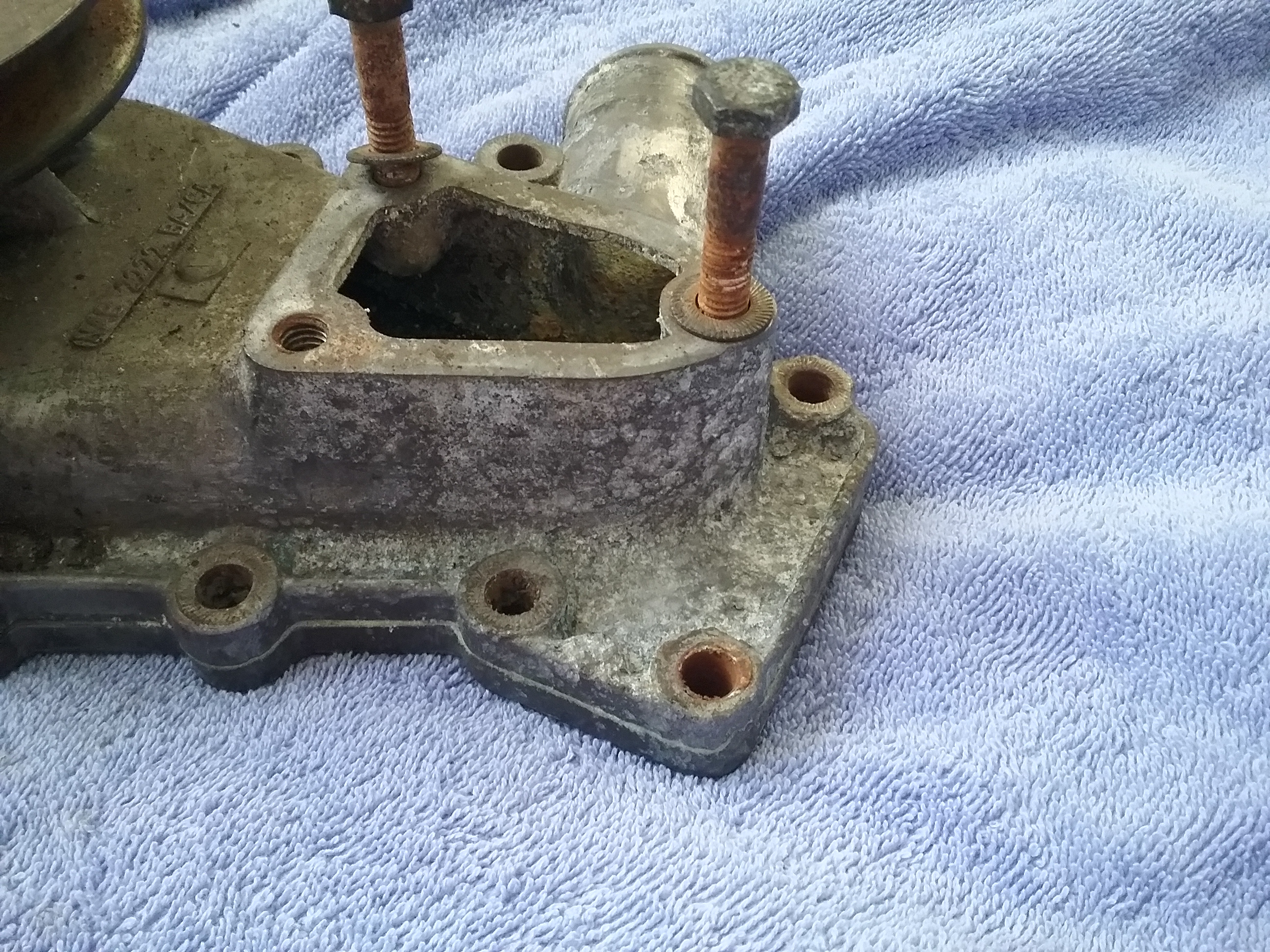

You'd never get the top entry pipe sealed again... Too any scars and material missing. Someone could of course try but I doubt it would work... At least in my opinion...

The rear seems all fine, just the front area is badly scared and pitted... Or would you think the would still be refurbishable?
Oh heavens, that's what JB Weld is for !
I've fixed more than a few badly eroded aluminum thermostat housings, intake manifolds, and the like that way. Fill up the low spots, let it dry a couple days, sand until smooth. Works fine.
In the 80s GM sold an epoxy specifically for this type of repair....but the details escape me at the moment. It was red....maybe someone here will remember.
For some odd reason I can enlarge only your first picture. The other two won't expand so I can't see much detail
DD
