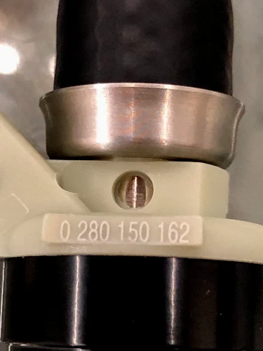

I'm replacing my injectors, piping, etc., to the fuel rail. The injectors that are currently installed, I think, are Bosch 280 250 161. What is the best fuel injector with a fine spray pattern? I found a Bosch kit with the last number different from my car, a 1989 5.3L HE V12. The number on the new injector is 280 250 162. Does anyone know what the difference is between the two part numbers? Who sells a good injector harness?

Jaguar v12 HE injector set 0280150162 injectors - Picture 2 of 2
This is a photo from this advert:
https://www.ebay.co.uk/itm/335645109...Bk9SR6rFv8mCZw
Autosparks in the UK send worldwide and make a good quality injector loom.
